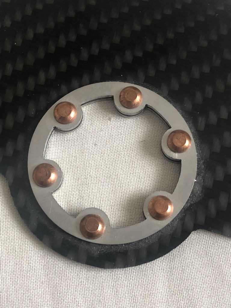

      I am going to make a flanged hub to drive a disc valve for my motorbike, the flange will have about 1.5mm clearance on either side of the housing in which it is to fit.
      The problem I face is that this hub must fit on a tapered shaft, and whilst I can machine the hub to fit so that it’s flange has an equal clearance in the housing, by repeatedly fitting the hub on the shaft, it made me think “well how repeatable is the linear fit of a taper joint” and how much creep occurs before they lock? and similar questions.
      Broadly speaking, I guess that tapers with steeper angles lock with a tighter linear tolerance than tapers with shallow angles.

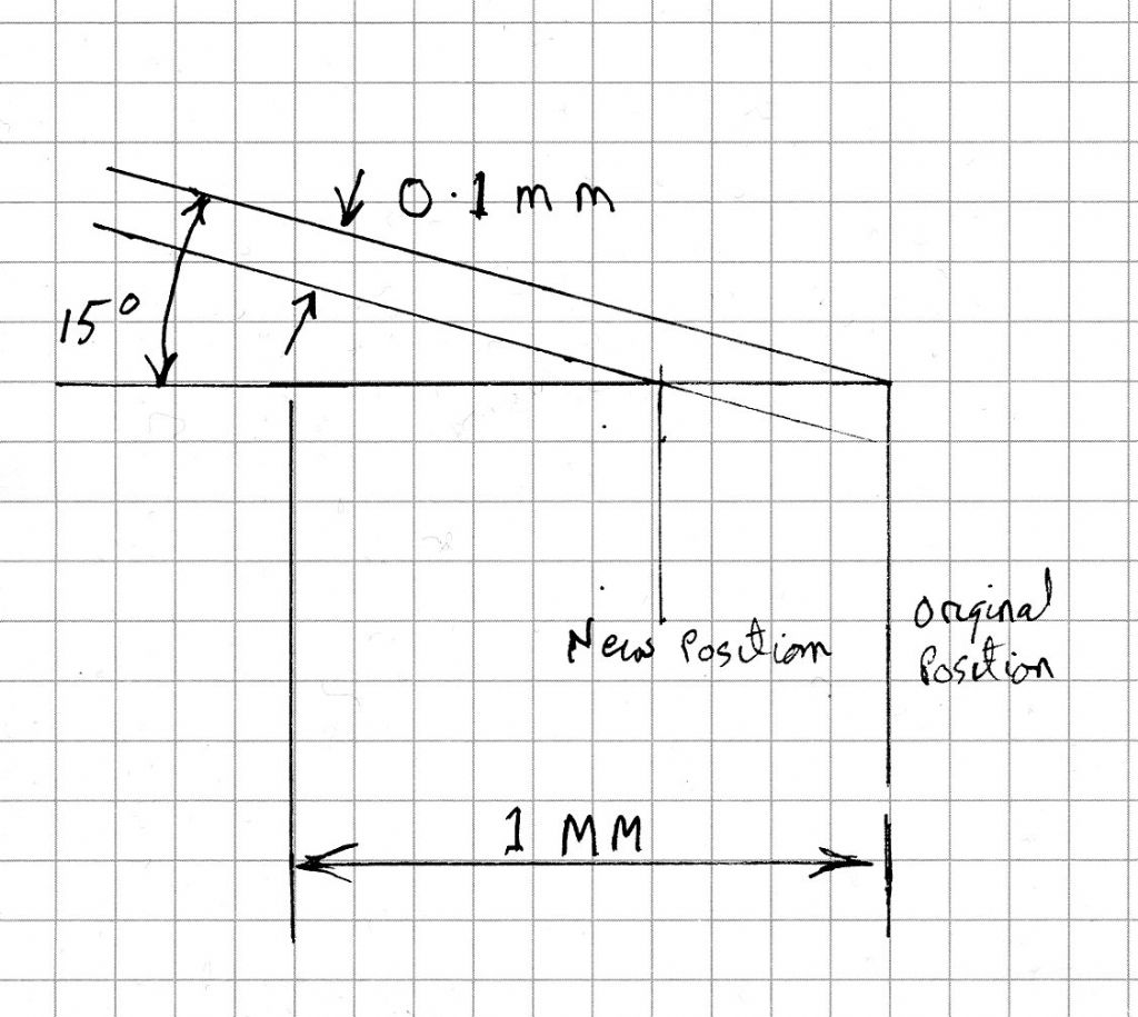

                      The ability if a taper to lock depends on the materials used, the finish on the faces, the taper angle and the presence or absence of any lubricant. The linear position will change if you take some material off the surface of one or both parts. It will also change if there is any bedding in of uneven surfaces. If this is what you are concerned with then the formula is the wear divided by the sine of the half angle. As an example if you machined off 0.1mm or had the equivalent wear and the taper half angle is 15 degrees then the linear movement along the taper will change by 0.1/sin(15) = 0.38mm.
                      Martin C

                        Posted by Martin Connelly on 28/06/2020 09:37:57:
                        Martin C
                        … and if the taper half-angle was 90° then that linear movement would be 0.1mm
                        which I think nicely demonstrates my point angel
                        Edited By Michael Gilligan on 28/06/2020 10:27:38
                        #482660
                        Nicholas Farr
                          @nicholasfarr14254
                          Martin C
                          Hi, here is a sketch that proves the calculation. The squares in the real world are 5mm, but represent 0.1mm.
                          Regards Nick.
                          Edited By Nicholas Farr on 28/06/2020 11:08:06

                                        C J
                                          @cj88518
                                          That's right, but for added fun my disc is driven by six lobes as shown.
                                          #482723
