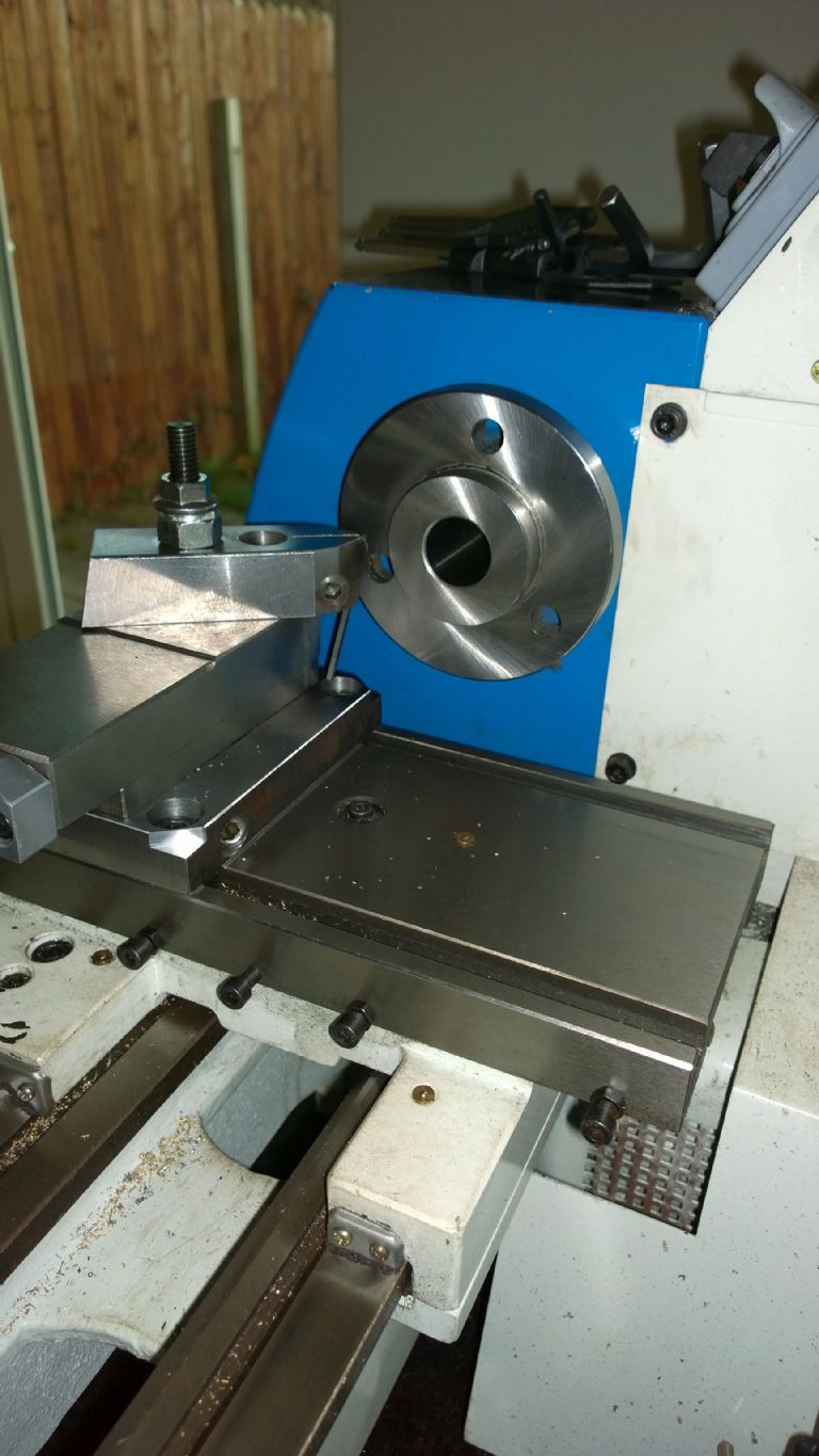

      Posted by Vic on 21/01/2019 18:08:47:
      Quick picture of mine, more in my album.
      I'm using something similar I knocked up for the Myford a few years ago, but am about to make a bigger one for the Warco GH1330.
      In my initial trial one, I used 12° for both angles; what's yours?
      Cheers
      Bill

            Posted by Vic on 24/01/2019 20:51:27:
            Yes, I used 12° for both angles. If I remember correctly I swung my main vice around 12° then mounted the workpiece in a smaller vice held in the bigger one at 12° if that makes sense. My main milling vice is a fairly standard looking 4” one but I also have a 2” screw less vice.
            Thanks Vic (and others)
            Fortunately I have a small 3 axis universal vice, which i used to make my prototype, so I could set all the angles at once. It's only a 2" one and not all that rigid, but i was only using an 1/8" cutter to make the 3/16" slot for the tool bit.
            Still making grinding wheel arbours for my recently acquired part built Quorn at the moment, but a bigger diamond holder's probably the next job.

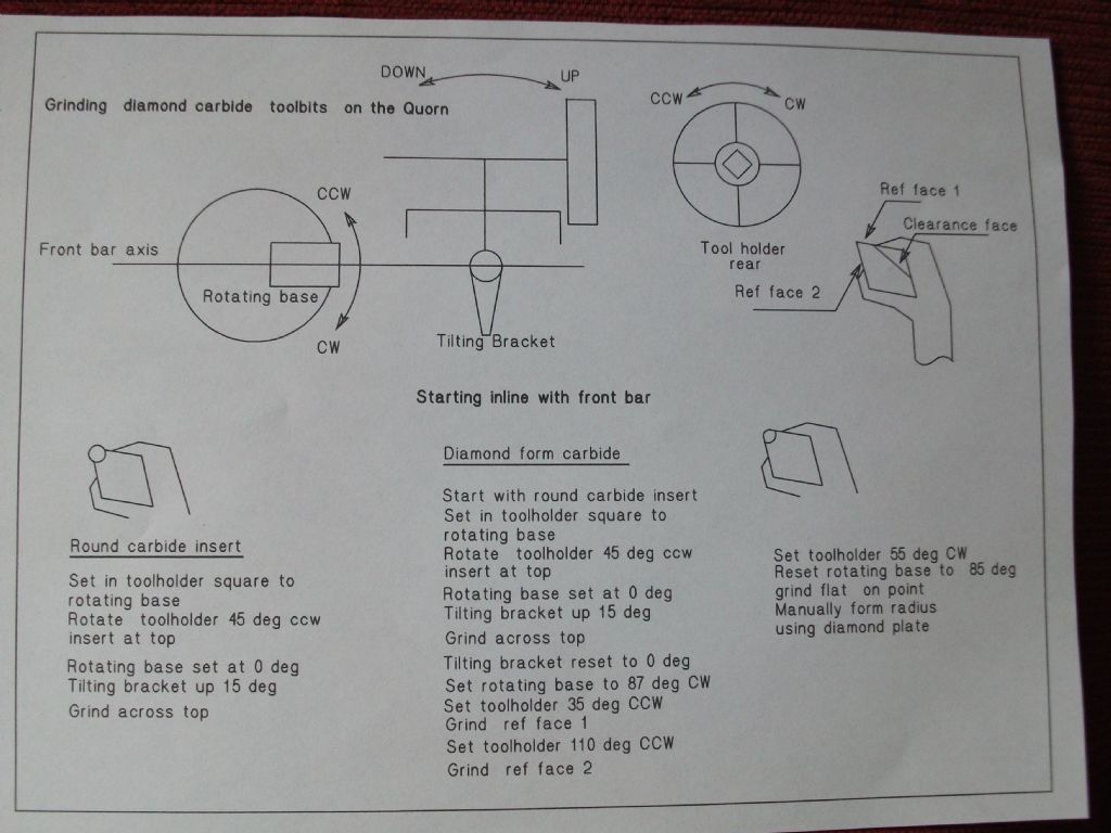

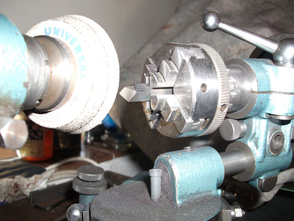

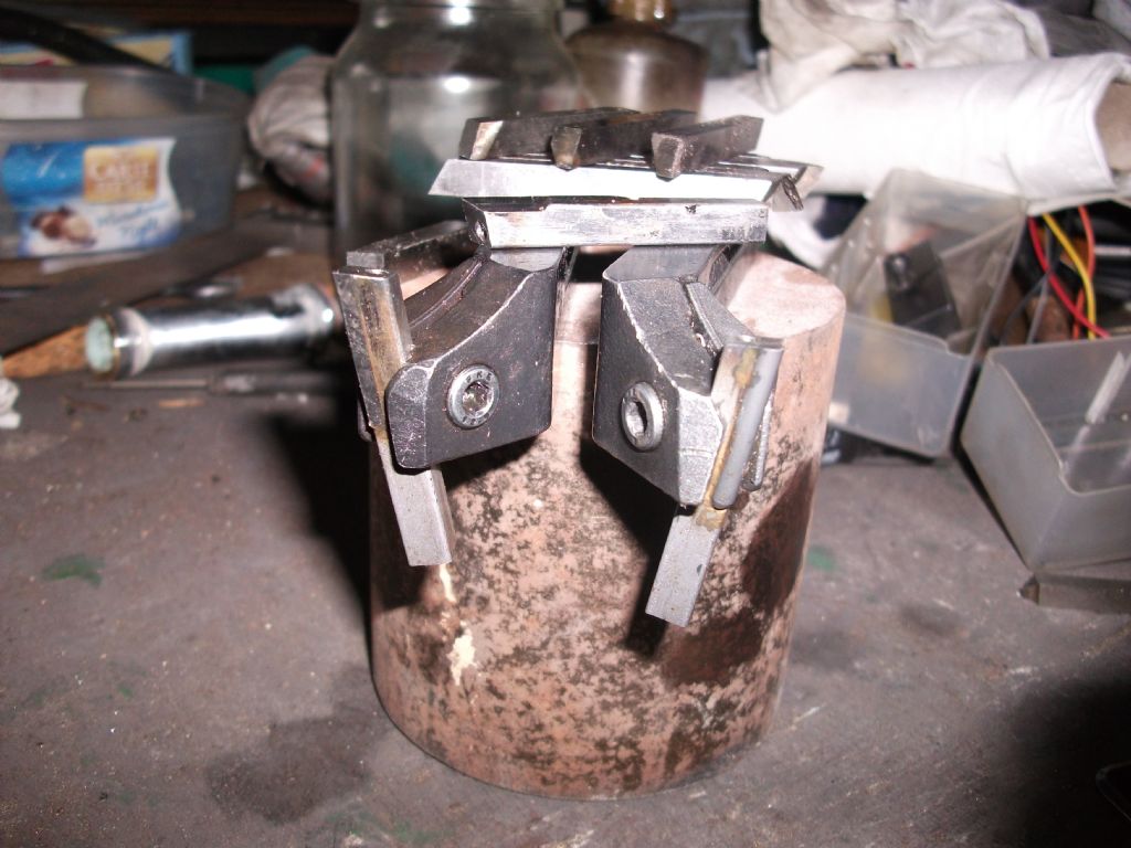

                                            Hi John,
                                            I don't use the supplied fixture to sharpen the toolbits,some while ago
                                            I bought 10 off 1/4 square toolbits from J&l supplies they were on offer
                                            at about 80p each 10% cobalt.
                                            Both ends are sharpened as can be seen in the photo .I had this process
                                            scribbled out on a piece of paper and have tidied if up here for use
                                            on the Quorn grinder or tool grinders with similar axis. This may be useful
                                            for others wishing to do this.The self centering 2 inch four jaw chuck is
                                            from Chronos and makes this much easier to do.
                                            Having 20 ground ends if one is dulled it goes in the grind box and
                                            a fresh one fitted.
                                            The carbide tips that are ground similar to a CCMT shape only need regrinding
                                            on the top until the are worn down enough that the sides need doing again.
                                            Grinding the carbide is best done towards the cutting edge to avoid chipping.
                                            These days the tangental toolholder gets the most use.
