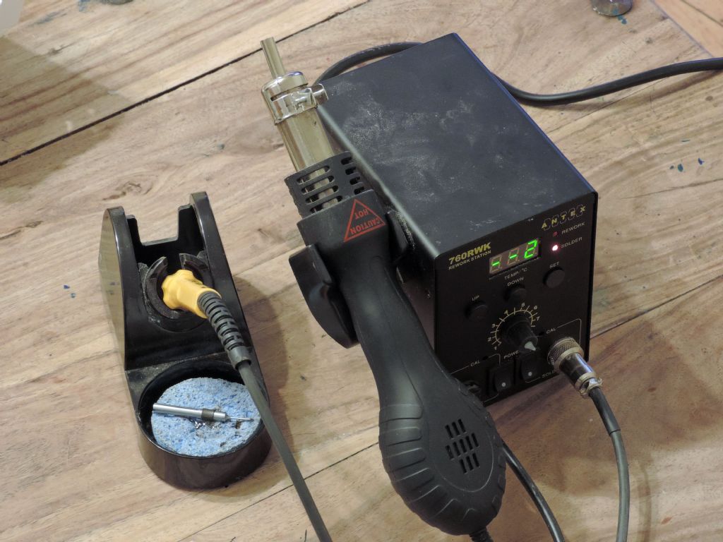

        Posted by StephenS on 17/01/2018 22:44:10:
        What model of rework station do you have please?
        I have a good Weller magnastat station and a good quality solder sucker, and some solder wick. I have not ventured into smd components yet but will have to soon.
        Please can you explain the advantages of a rework station, what specifically is it, does it do, etc for me the uninitiated.
        Thanks, Stephen S.
        Antex. It combines a temperature controlled iron with a temperature controlled precision hot-air gun you can use to solder or lift SMT components. I've found the rework gun works well for removing connectors as well.

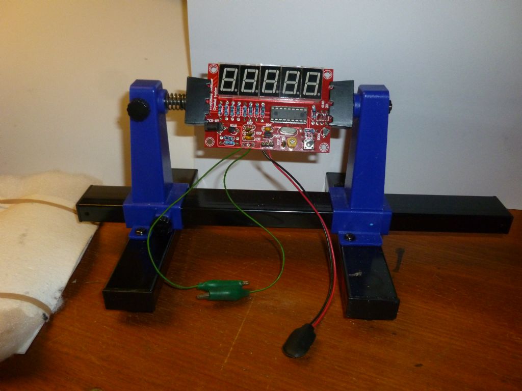

            pcb jig.jpgCatching up. First – strippers, whether or not Titian haired or named Tiffany.
            Secondly – pcb jig as above

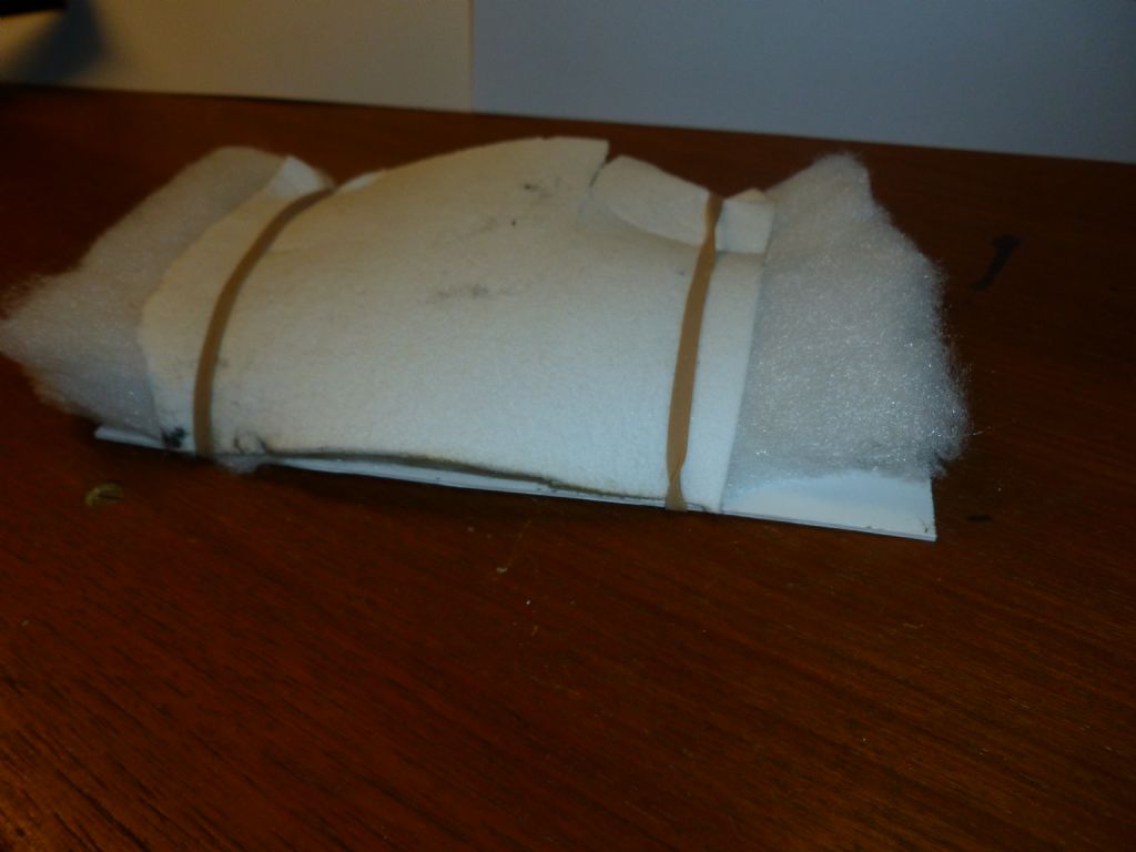

            Tertiarily, or thirdly – heat resistant, resiliepcb jig wadding.jpgnt, pad to hold in the components when pcb is inverted. Plastikard backing, polyester foam wadding (Thanks Debs) flexible, heatproof boiler insulation. Elastic bands hold it together, and across the corners to hold it to pcb, and Robert's your aged relative! The wadding doesn't burn or support combustion, and you can make several to fit various pcbs.

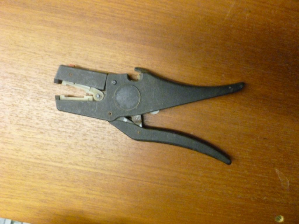

              zz strippers.jpgThese disappeared from posting above.
