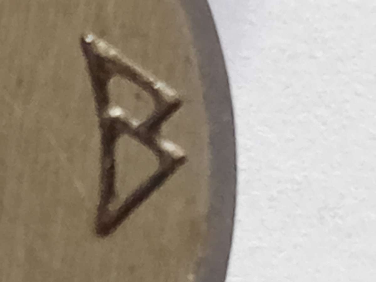

      I have some metric taps and dies. They have no manufactures name such as Presto but only have a logo of 2 slightly overlapping triangles. Can someone enlighten me of the manufacturer and whether then would be HSS?

        I have some metric taps and dies. They have no manufactures name such as Presto but only have a logo as in the photo below. Can someone enlighten me of the manufacturer and whether then would be HSS?

                    Thanks for the replies. I have now downloaded a close up photo of the marking and its not actually triangles but more like mountains or a letter symbol?

                      Rusty, the double triangles that you show are definitely the trademark of Triangle taps and dies Ltd. No ifs or buts!

                          I’m used to seeing Triangle Brand taps and dies. All the ones I’ve seen have three overlapping triangles each of which has a flat “base” with the middle triangle higher (or lower, depending on the orientation) than the outer two triangles.
                          Can anyone show us another tap or die in a Triangle branded box that has only the two overlapping triangles with slightly curved bases on the same level as seen in rusty’s image?

                            On reflection and like Bill, the trade mark does not look right ? Compare the OP s photo with that in the boxed set, it doesn’t look right.  Noel.

                              All the above rather implies that the OP’s taps are not Triangle brand. No idea what they are though. I had a quick look through some of my taps this morning. Very, very, few have any sort of logo and none like the OP.
