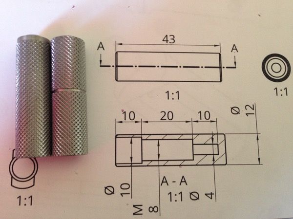

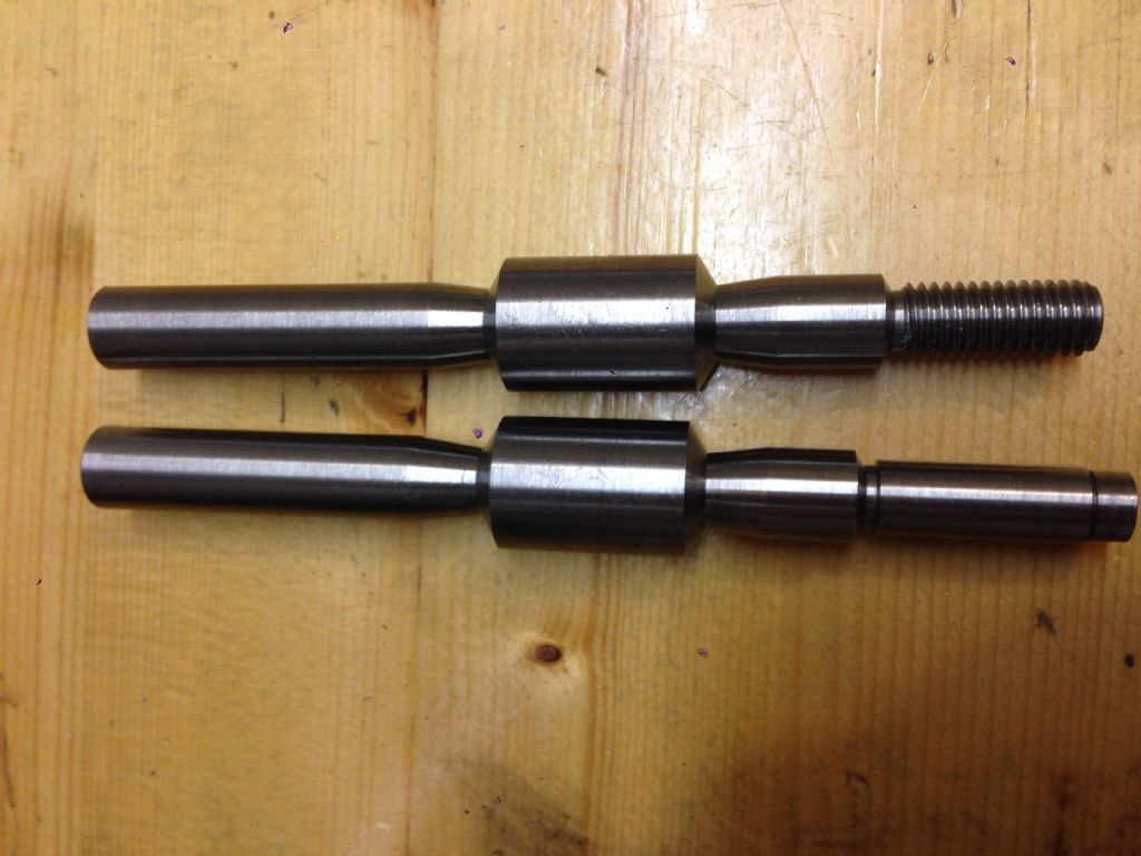

      I have long tried to find nice tap-wrenches at flea markets, but have come short on the small sizes. I decided therefore to build one, well actually two, since one is for my father.
      So far I have made the adjustment nut.
      Adjustment nut

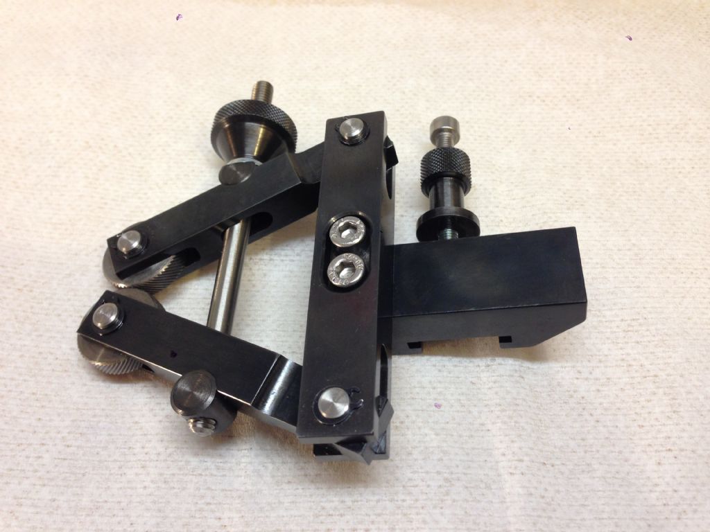

            Neat knurling Benny; did you use scissor type tool or push on style ?
            ​George.
            #285568
            Benny Avelin
              @bennyavelin86238
              Thanks for the nice comments, I am quite happy with the knurling. Knurling has been fairly simple since I built my clamp style knurling tool. I also put some build images in an album.
              Tonight I will start on the body of the tap-wrench.

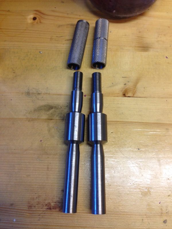

              #285607
              Benny Avelin
                @bennyavelin86238

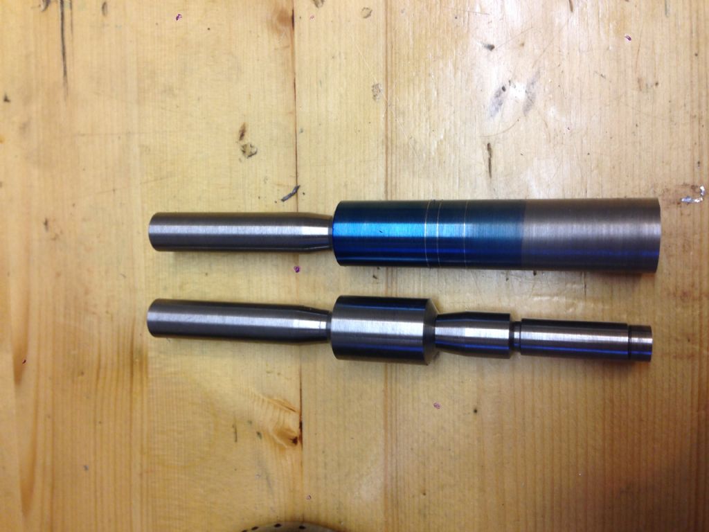

                Before dinner progress.
                #285635
                Benny Avelin
                  @bennyavelin86238

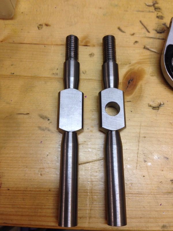

                  This is where I am finishing for today. Not so much turning left, next I will be milling the center part and the hole for the tap.

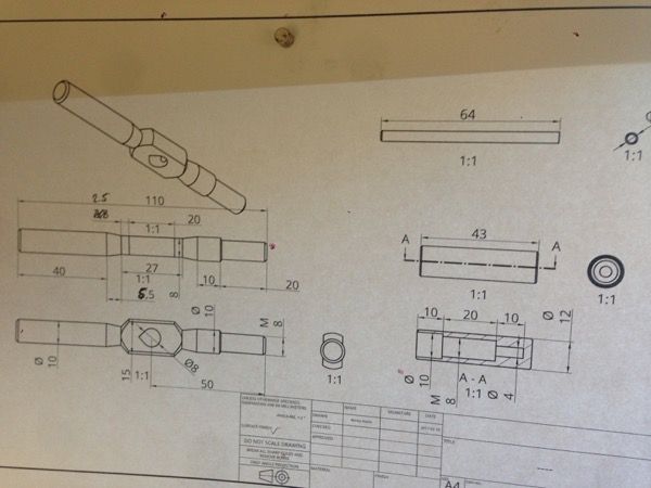

                      Hopefully they will last me a long time, regarding dimensions, I really need to get better with dimensions of length on the lathe, the diameter is fairly easy to hit.
                      #285828
                      Benny Avelin
                        @bennyavelin86238

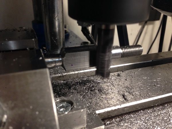

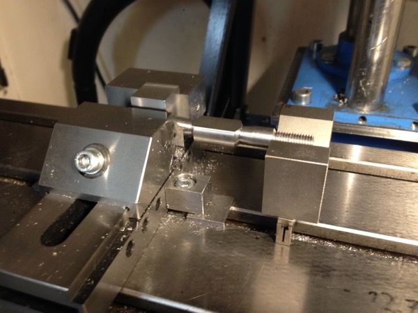

                        This is the drawing I am using, but for some reason not following very well.
                        This is the setup I was using for support when drilling the center hole, worked well. I like my starrett adjustable parallel.

                              Milling the flat part on a tap wrench(first milling job on my new mill)was where I learned that you DON"T use a Jacobs drill chuck for milling, the chuck fell out of the #3 MT taper, oh dear, the tap wrench has the nick out of it to remind me every time I use it.

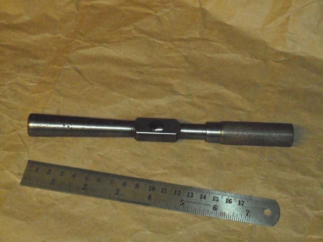

                                      Nicholas Farr
                                        @nicholasfarr14254

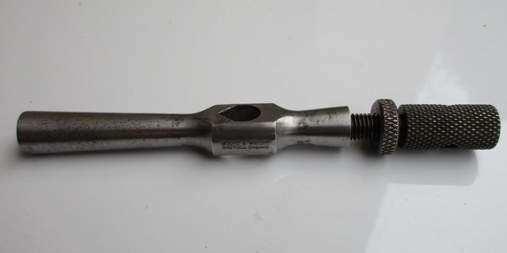

                                        Hi Benny, nice work on your tap wrenches. On the question of whether the knurling should be straight or not, I can't say that I've seen any tap wrenches with straight knurling, all the ones that I have are diamond pattern, including this one below.
                                        This is No. 111 in the 1949 Moore & wright catalogue, it is about 5" long and can accommodate up to 3/8" taps.
                                        Regards Nick.

                                              Posted by Nicholas Farr on 26/02/2017 07:51:54:
                                              Regards Nick.
                                              Pictures like this is the inspiration for my tool (obviously), isn't it beautiful?

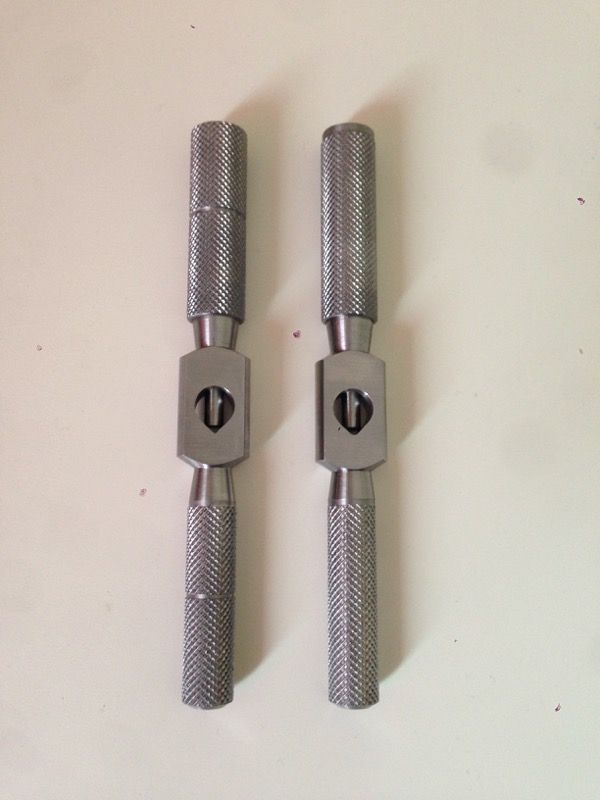

                                              #286044
                                              Benny Avelin
                                                @bennyavelin86238
                                                I decided to knurl also the other arm of the wrench, this is the tool in action.
                                                The finished result, I am really happy with the smooth action of the adjustment screw.
                                                Steve, I had thought about that issue actually and the plan was to make the 4mm push-pin out of silver steel and harden it, but I doubted that I could harden the tip and keep the pin straight enough. For this reason I decided not to harden it, but still made it out of silver steel since thats a bit harder than cold-rolled, but after reading your comment I went ahead and hardened and annealed the tip (thank you for this), without problematic distortion I might add. Again my filing skills could have been better and I struggled a bit filing the bottom vee grove to get it perpendicular and flat, but eventually it was passable

                                                  Very nice Benny,
                                                  #286064
                                                  mechman48
                                                    @mechman48
                                                    Well done Benny; very nice clean knurling on both pieces.

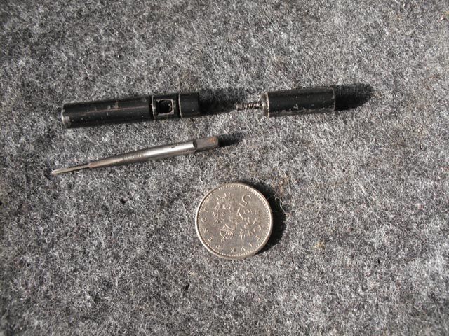

                                                      Here's one I made earlier (more than 50 years ago). No problems with burrs, as the parts which grip the tap are case hardened.
                                                      More recently I made a miniature tap wrench to use with small BA and metric taps.tap wrench bits.jpg
                                                      This shows it with a 12BA tap fitted.
