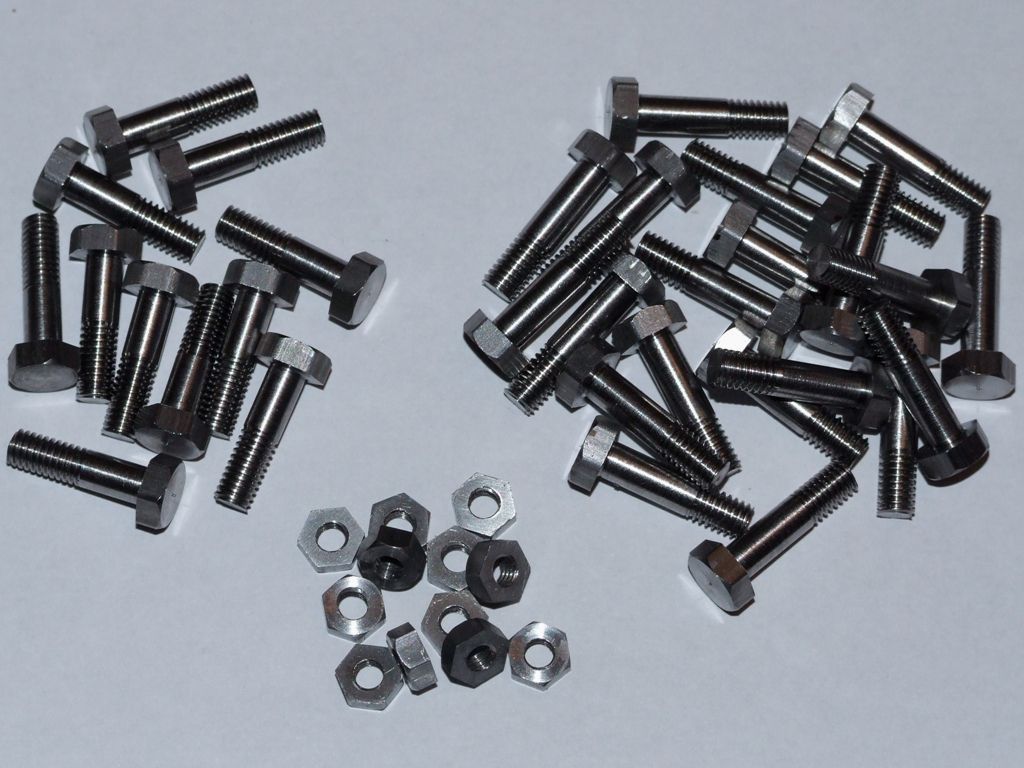

        Bother, due to finger trouble I've just lost what I was typing. Just as well though as I was beginning to ramble. I can now start again with a better idea of what to say. On the plus side it's just started raining so I can abandon plans for weeding the garden and hit the workshop instead.
        The OP needs to decide what he wants to make before buying taps and dies. I'm building a relatively large (4" scale) engine but the most common threads are 1/4" BSF and 2BA. Smaller engines will most likely be metric, BA or UNC/UNF depending upon where and when they were designed.
        I mostly use metric threads for work related design, but my engines are a mix of metric, BA, BSP and BSF and even one part which is 5/8" UNF. Internally on my engines I use metric threads and commercial socket head bolts/screws. But for visible threads I reverted to the original BA and BSF threads after a brief period of aiming to convert everything to metric. I use commercial BA nuts and small BA screws from EKP. I understand that small scale metric fasteners are available from European suppliers. But I use so few that I make my own. I was unimpressed with commercial fasteners for the larger threads so I also make my own; 2BA bolts and M4 nuts:
        1/4" and 5/16" BSF studs:
        And matching nuts:
        Of course it helps that I've got a repetition lathe; once set up it's very quick to turn out multiple parts.
        To summarise the ramblings; decide what to make and then buy taps and dies as needed. There are two rules for buying taps and dies, and any type of cutting tool:

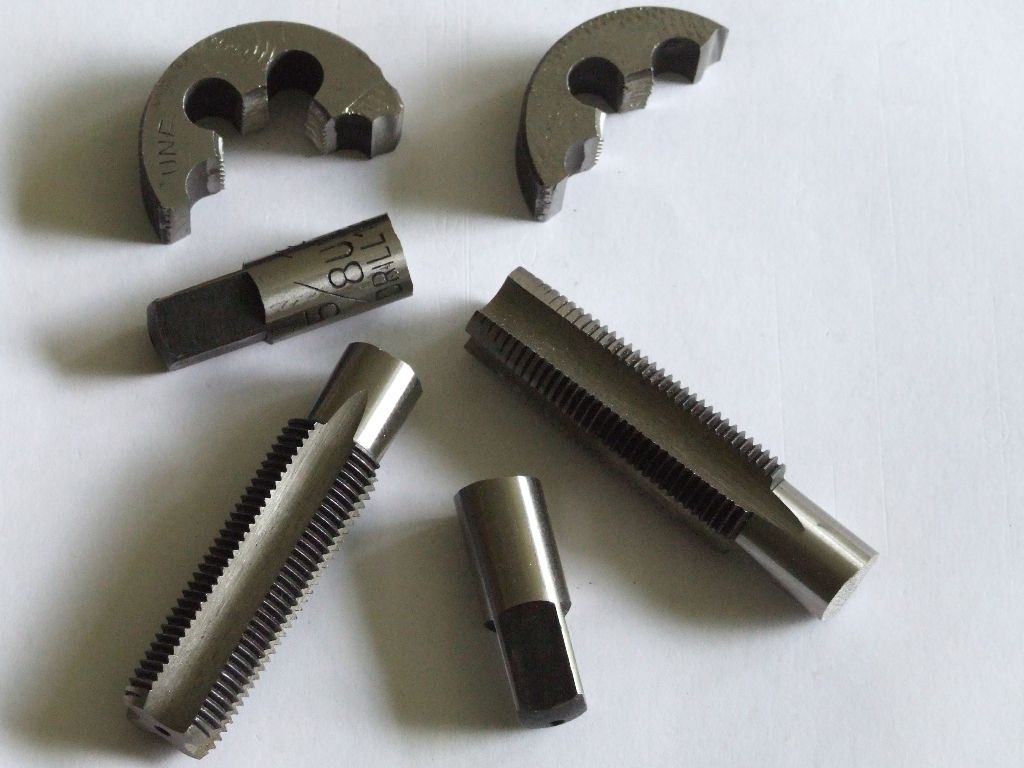

        #503170
        Paul Kemp
          @paulkemp46892
          Andrew,
          That is some failure on the taps? I don't think I have ever seen a tap break like that, was there a groove in the shank at point of fracture? Were you hand tapping when they broke or under power? I do have one die with a similar appearance to yours lol, I think the problem with mine was less with the die and more with the holder being oversize and allowing me to Jack the die open too far.
          Paul.
          #503178
          Henry Brown
            @henrybrown95529
            LOL, I wish all taps broke there if they are going to Andrew!
            Another good reason for buying quality taps, it's usually not so bad if a die goes other than the inconvenience of getting another…
            #503180
            Anonymous
              Posted by Paul Kemp on 24/10/2020 13:00:48:
              None of the above. I broke them deliberately (Widlarised is the technical term *) as the threads they produced simply didn't fit together properly whatever I tried. I can't remember the exact details but I got so fed up making, and scrapping, parts that didn't fit that I binned the taps and die. I then bought a 5/8" UNF spiral flute tap from a commercial supplier (probably Cutwel as the brand is YG) and screwcut the external threads. I no longer use the ME supplier from whom I orginally bought the taps and die.
              Andrew
              * After the legendary analogue integrated circuit designer Bob Widlar. Having found a duff component during debug his advice was to smack it with a hammer, for two reasons. One, it makes you feel better, and two if you leave it lying around someone else will use it and then have to go through the same debug process.
