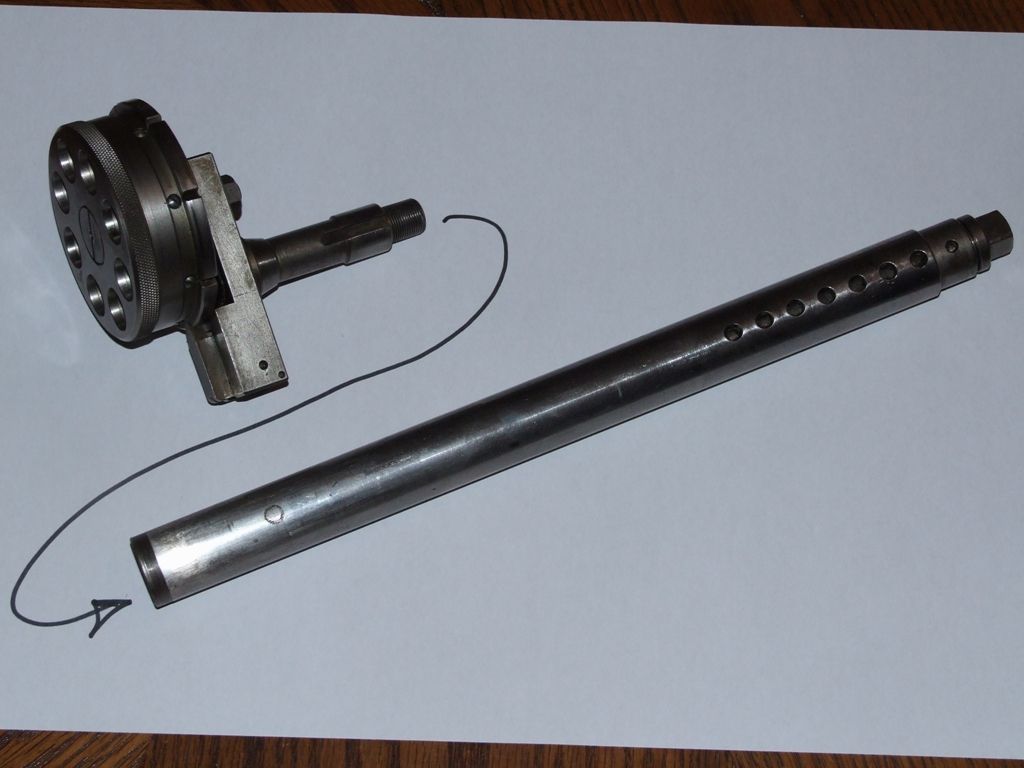

Andrew, the 8 tool turret shown in your pictures album demonstrates the need to locate the turret in the correct plane, otherwise why have a keyway groove machined in the turret mounting shaft ? The key will no doubt align all of the turret tool holders centres with the lathe centre when indexed to any tool position.
Errr, I don't follow?

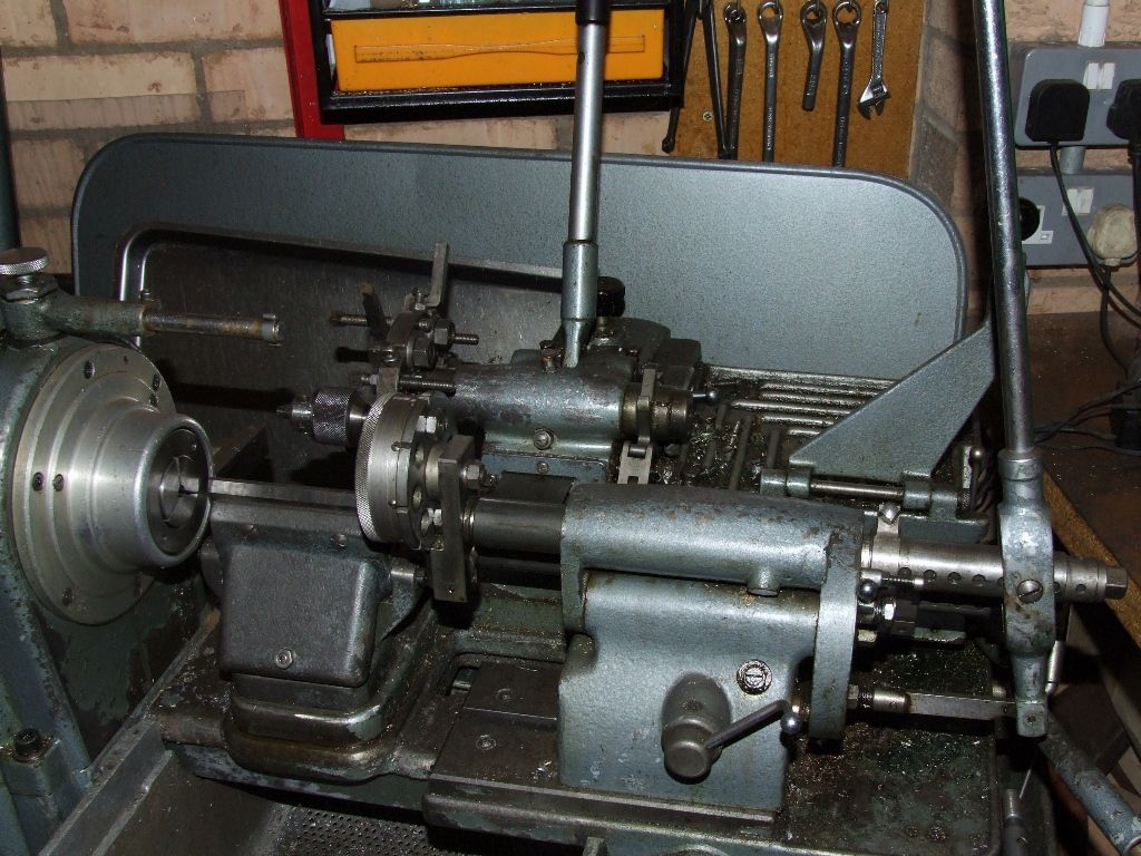

The capstan and indexing mechanism are mounted on a 'solid' collet. The grooves in the large diameter are the indexing grooves and index each tool location axially in line with the mounting collet. The mounting collet has a keyway, but this is a loose fit on the corresponding internal pin in the tailstock shaft. The capstan mechanism and shaft can be rotated several degrees before the collet is tightened. The collet is held in place with a drawbar similar to the R8 system. This may help illustrate the arrangement:
There is no external keyway in the mounting shaft. The only thing that stops the whole shebang rotating is the lever operating mechanism that mates with a pair of the series of holes to the right. As shown here:
The mechanism is pretty loose, so the capstan unit can rotate several degrees either way. Indeed it does so when operating, depending upon the direction of cut. However, alignment is not lost. I have never done anything special as regards alignment when fitting the capstan unit.
As an aside indexing is done when the capstan is pulled back against the tailstock casting. This pushes on a spring loaded lever which disengages the indexing pin allowing the capstan to be spun by hand to the wanted position.
