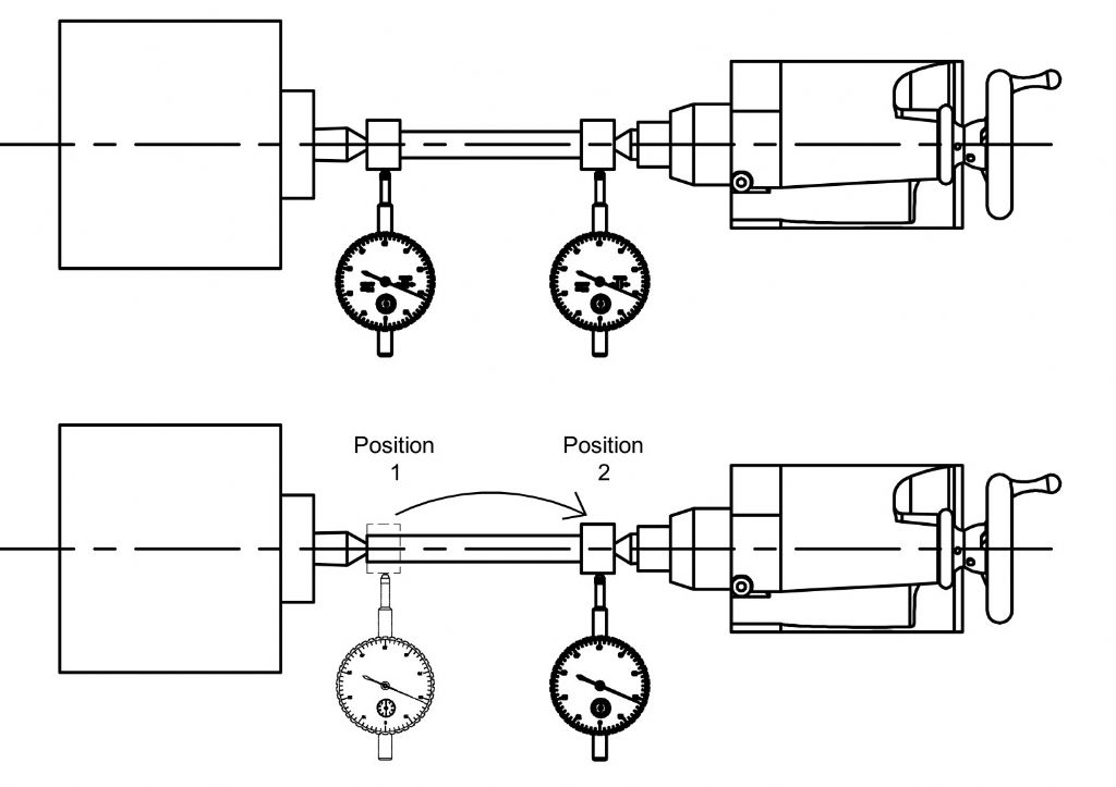

        The suggested method for aligning the tailstock centre on a lathe is to make a test bar (stepped down in the centre) and to machine both ends without adjusting the cross slide. Then measure the diameter of both ends. The centres will be accurately aligned when the diameter of both ends is the same. (see top drawing arrangement below). This may take many trial cuts before the 2 ends are the same diameter.
        Why not just turn a diameter on one end only. Take a reading with a dial indicator attached to the tool post. Reverse the test bar between centres. Move the toolpost to the tailpost end without moving the cross slide and then align the tailstock until the DI reads the same as when it was at the headstock end. Double check DI measurements at headstock after moving tailstock. No extra cuts necessary.
        Your comments please, Paul.

            ​That is an interesting idea, but I have the uncomfortable feeling that the effects of radius and diameter will lead to confusion. My other concern is in using a DTI as a measuring tool; they are comparators, not calibrated for measurement.

              (why try to measure only half when you could be measuring twice as much difference?) More accurate, Yes. But if you have a precision ground test bar do you re-machine it each time you re-align the tailstock or use a DTI as in the second example ?
              Hi Brian, Yes, DTI's are comparators, but that is exactly what is being done. Comparing the distance from a common datum. When the mesurements are the same, the centres must be aligned. Accuracy would depend on the precision of the DTI, and similarly on the accuracy of a micrometer.
              As you have said, it will be interesting what others think. There is probably a good reason to use the conventional method and measure both ends of the test bar.

                  I think the machining of both ends is used when setting up a lathe to check for parallel turning. This machining of both ends will set the tailstock in the correct position for whatever the bed is doing in the way of twisting or the carriage responding to wear (at the distance the test bar determines). Once the test bar is made then setting the tailstock back to the correct position is, as stated above, just a case of fitting a suitable DTI to the carriage and checking you get the same reading at both machined sections of the test bar after moving the tailstock over.

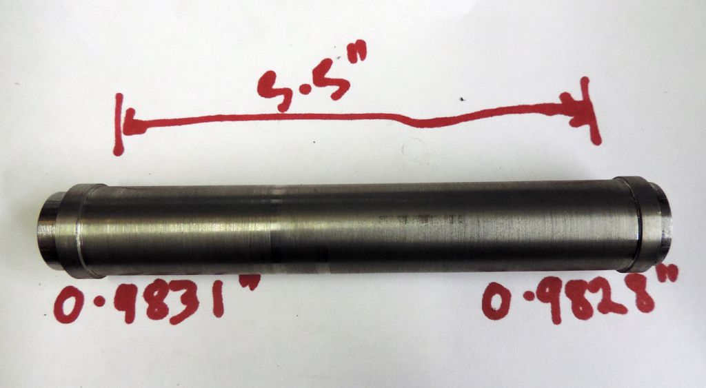

                  #256958
                    Paul,
                    Better still, turn both ends approximately to size.
                    Take a skim off one end, reverse the bar and at the same setting skim the other end. They should now be the same to <1 thou no matter how crazy your lathe is.
                    You can now set the bar between centres and just use an indicator to compare readings at each end. Whether diameter or radius doesn't matter – in fact the actual diameter of the bar doesn't matter.
                    It makes it easy as you measure one end then just tweak the tailstock until the other end shows the same reading. Simples.
                    & his bar:

                      I made one of Neil's clever bars and it seems to work well.
                      Not as nicely finished of course, but what can you do?

                          Neil, Similar idea but instead of reversing the bar for machining, reversing the bar for measuring.
                          Mark, Same idea as in the video.
                          I have seen both methods in lathe set-up instructions but thought I would throw it into the forum for your thoughts. Comparing a measurement with a dial indicator at both ends is a quick way of checking the tailstock alignment for everyday turning jobs but I believe that the best test is in "the tasting of the pudding" ie. actually machining a bar where the cutting tool is under pressure and any slop in the guides is eliminated.
