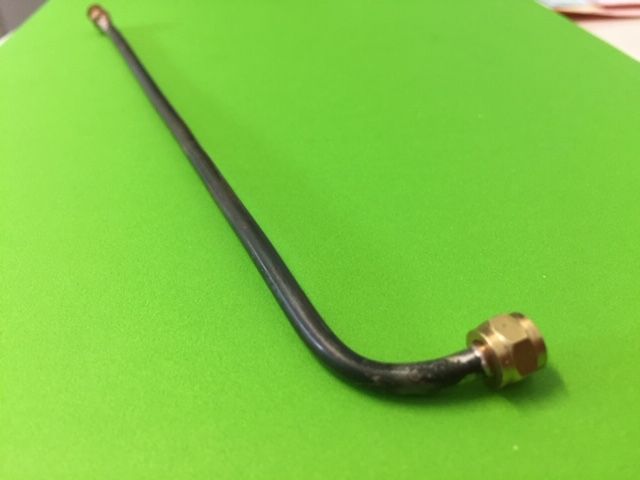

        Hi can any one advise on which material to use for a super heater in a model locomotive.
        I guess it should be stainless – but which one 304 316 etc
        What wall thickness based on 3mm od
        How to bend it.
        Assuming it will be a single piece bent the joints will be in the smoke box so could they be high temp silver soldered.
        Its going in a single flue tube gas fired boiler
        Any other advice please

            Do you really mean 3mm OD? That is going to be very small ID. As for material, use what you can get, I doubt you'll have much choice

                This is a superheater for my G1 Eric made from a bit of 4 mm tube scrounged from a dead coffee machine. Stainless but no idea what grade, but good enough for the temperatures and pressures of an espresso machine. The inside radius is about 7/8". When I bend small tube I make a groove as wide as the diameter- a close fit- in a bit of bar with a parting tool, as deep as the diameter. I anneal the tube and bend. It can't flatten as it is constrained by the groove walls. Roundhouse use 1/8" stainless superheaters in their locos and kits.
