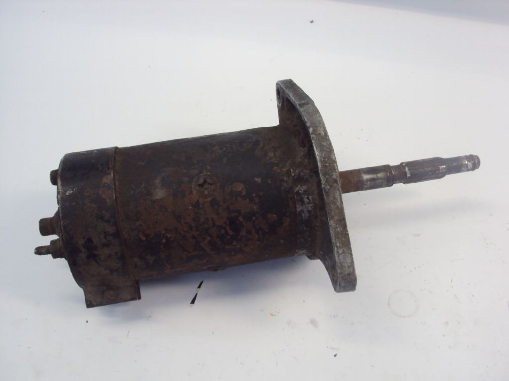

            Ok so I have been quietly working away on solving the starter motor problem and I reckon I have found a suitable solution. I surfed my way through trademe and found an old bendix type starter off a ford transit van for $45, just the ticket me thinks. If that doesn't have the grunt to turn it over fast enough then there's something really wrong and I quit!!! Below is a photo of the starter after I removed the bendix gear system. The plan is to shorten the shaft and add an adapter to suit the dog clutch I have made for the V12 but to also make an adapter to suit the rubber cone style of clutch for other projects and for using once the bigger engines have been run in properly and no longer need the dog clutch system. I will dismantle the starter to check all is well inside and give it a good clean and a coat of paint, then make some mounts and handles blaa blaa blaa and hey presto a nice newish starter………. well thats the plan anyway, spose I'll have to wait n see weather or not it becomes a reality LOL.
            Cheers for now
            Dean
            #221399
            Ian Abbott
              @ianabbott31222
              How fast does it need to turn to get the blower up to speed? Starter motors tend to be high torque, low RPM. You might need to gear it up somewhat.
              Remember the old Hucks Starter? Perhaps you could build a scale Model T and fit it with a drive shaft……..
              Ian

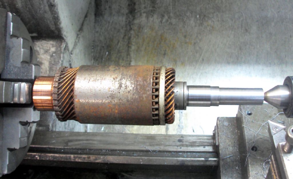

                            #224854
                            dean clarke 2
                              @deanclarke2

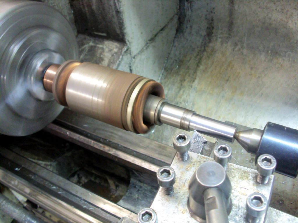

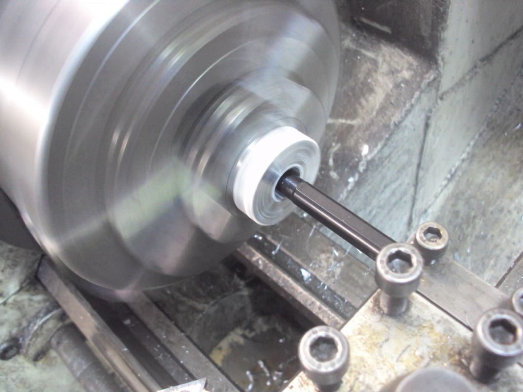

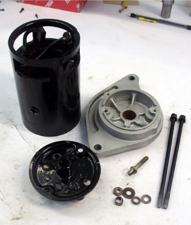

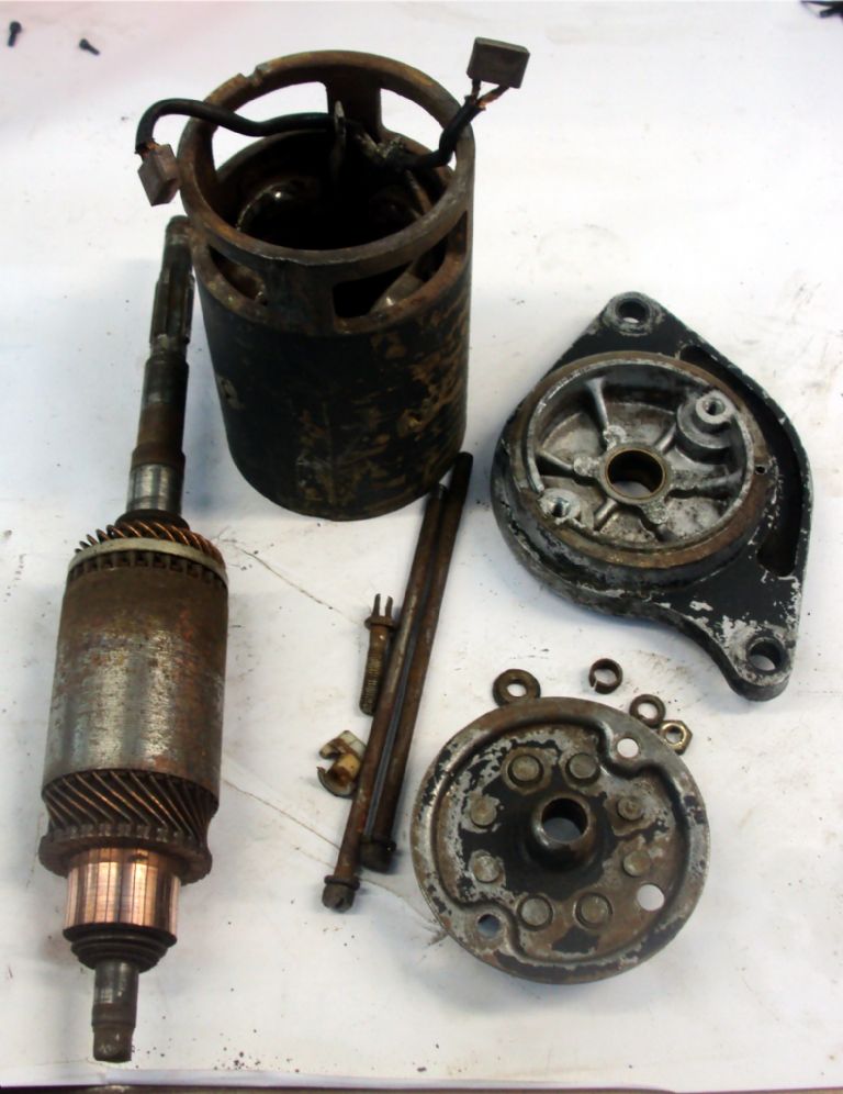

                              Well it has been a little while since an update, but I have not been completely idle.I have been working away on turning the starter acquired on trademe into a usable model engine starter, photos below show the progress to date
                              That's all for now
                              Dean

                                When I was working as an auto electrician on heavy goods vehicles (all diesel) back in the 1950's, I made a trolley Acc as it was known by the fitters. Any one member Leyland, AEC, Perkins and Gardner , not a foreign make in sight those days. Actually the trolley Acc was 5 large 6 volt batteries connected in series ,all fastened to a 4 wheel trolley, with a pair of very large jump leads, one directly connected to the common Neg with a very large croc clip on the free end. The Pos lead had croc clips on both ends. After an engine rebuild, the engines were very stiff, so a 12 volt starter got 18 volts and 24 volt 30. All the auxiliaries were disconnected and I never had a burnt out starter motor. The same arrangement was used to start some old lorry engines after a frosty night. So you might consider doing the same if your starter is short of grunt, give the starter a few extra volts. I fitted a 12 volt dynamo as a DC motor, using 18 volt on a small hoist, lifting things out of the degreasing tank. Best of luck with your fantastic project. John
                                #224943
                                dean clarke 2
                                  @deanclarke2
                                  Hey thanks for the info John, I reckon this starter will be more than adequate for my engines. Have also started to carry out the mods to the engine itself, starting with the intake for the blower.photo below shows the initial layout change.
                                  will update with photos as things get completed.

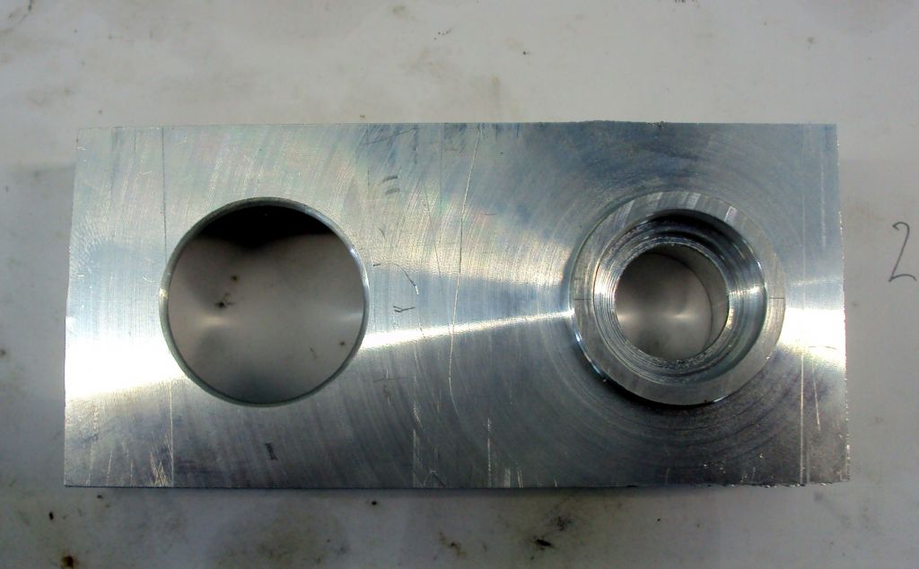

                                  #226827
                                  dean clarke 2
                                    @deanclarke2

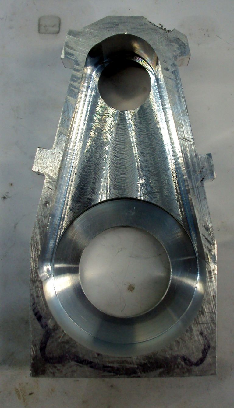

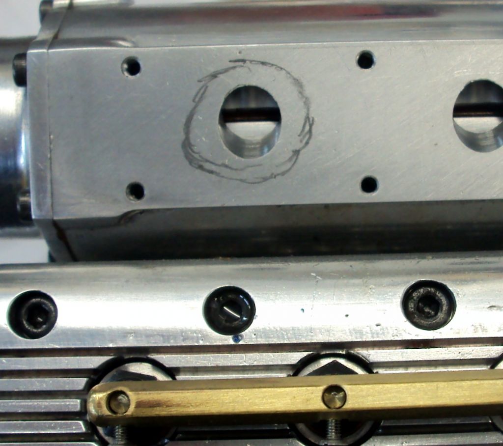

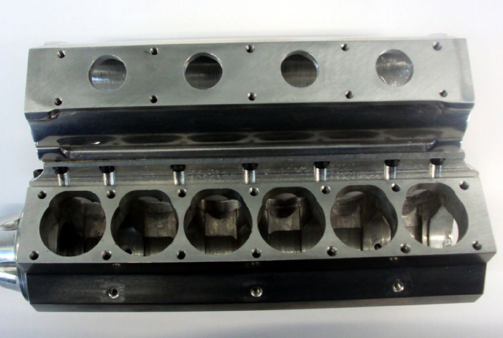

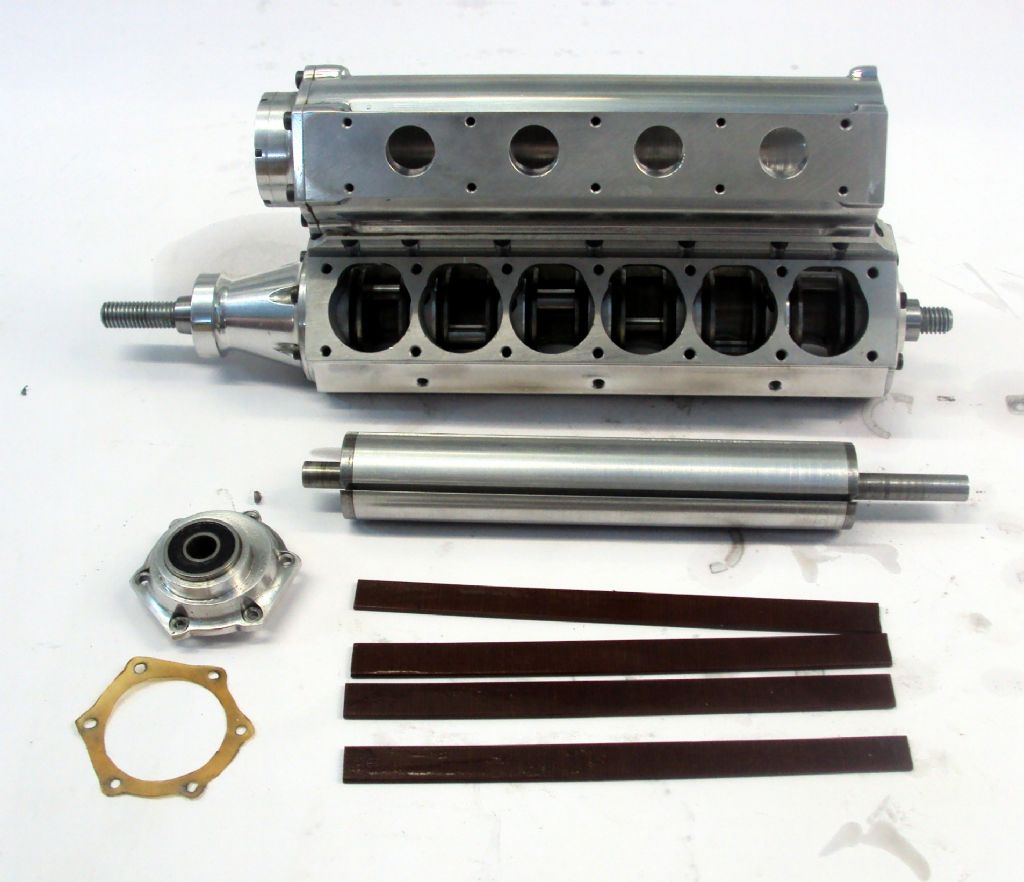

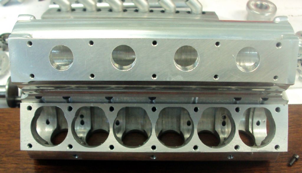

                                    So we are well under way now with the mods and the engine has been completely stripped down. The first thing on the list of must do's is the enlargement of the intake ports and the supercharger exhaust ports which has now been done. Photos below show the progress to date.intake ports modified 1.jpg
                                    The intake ports have been increased by 50% of the original diameter with the exhaust by 25% and also being trued up with the manifold and block holes to make good gas flow. ( bit of a noob mistake that but never mind all fixed now).
                                    Next is to do the toothed belt drive, backplate and cover and to dial in the transfer timing to make sure it is what it's supposed to be and maybee advance it by a few degrees. I will keep you all updated as soon as I have things done. Also I am building my anodising plant so I can add some colour to this engine.
                                    cheers for now
                                    Dean

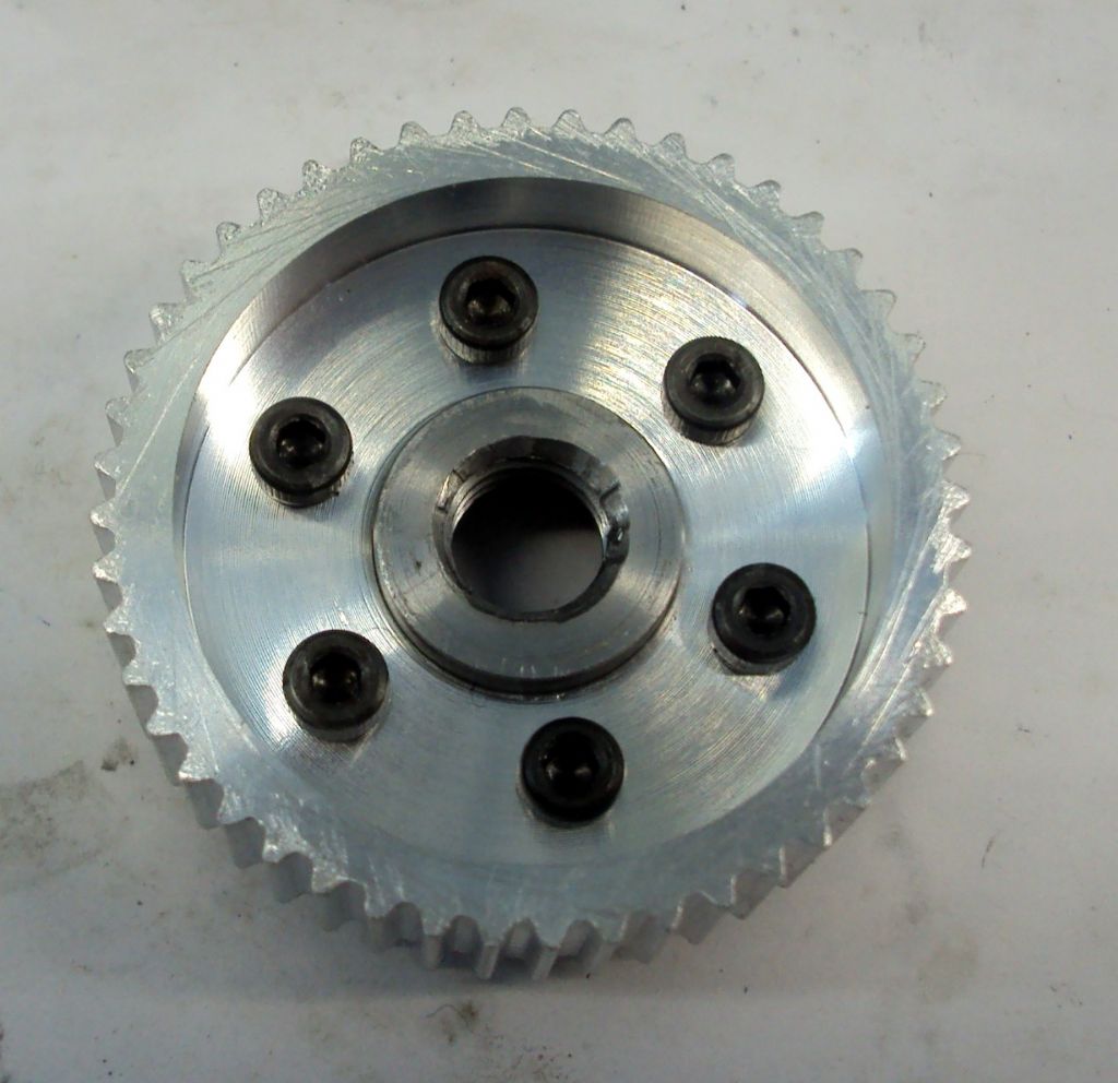

                                    #235044
                                    dean clarke 2
                                      @deanclarke2

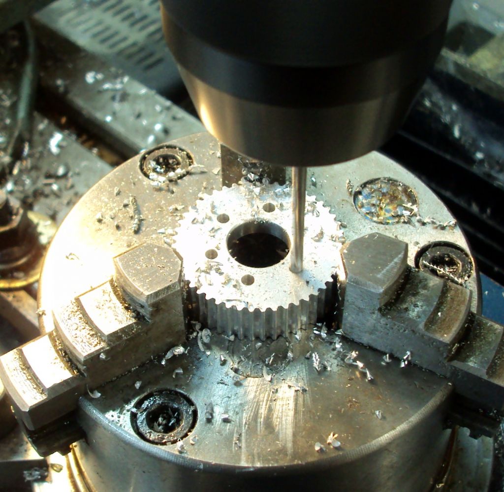

                                      Just a quick heads up, I have finished modifying the two toothed belt gears I got from belting online to fit on the V12 and am now in the process of making the drive belt housing and cover, these will both be anodized with the two heads, fin blocks, prop driver and spinner nut. I will upload photos later on tonight time permitting.
                                      cheers
                                      for now
                                      Dean

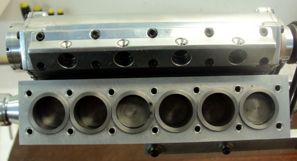

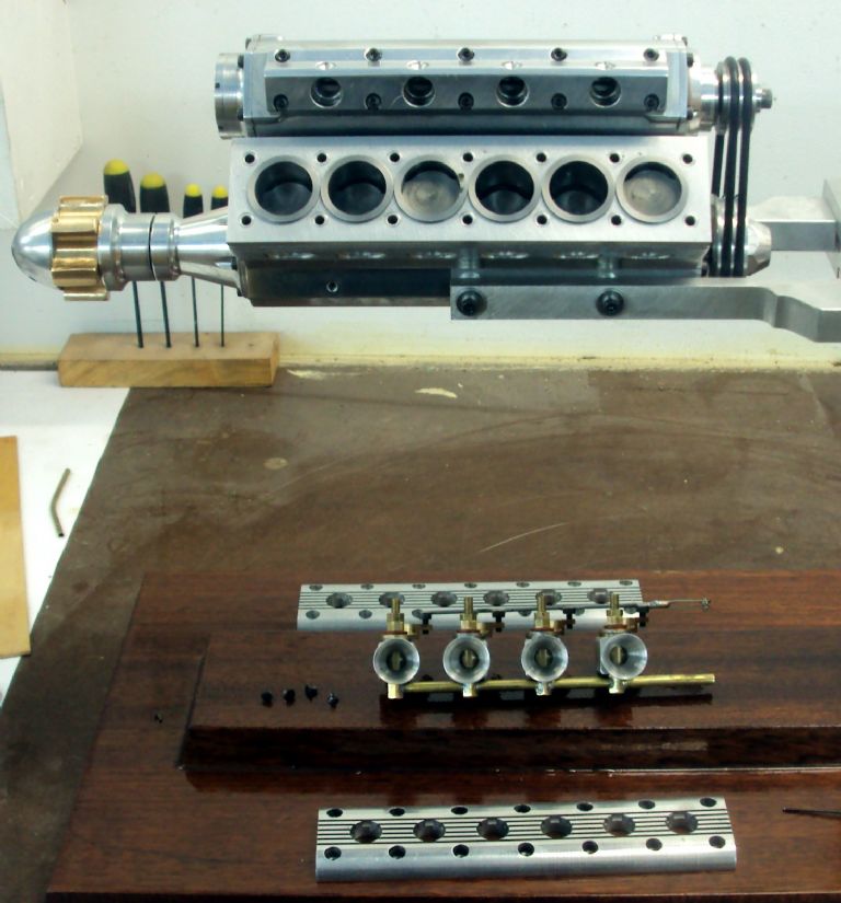

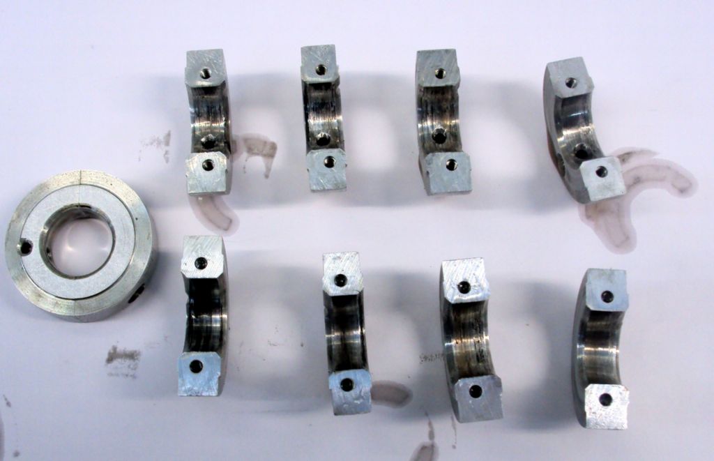

                                            Ok so here are some photos of the progress to date with the mods etc being carried out on the v12
                                            dismantling after the first few runs to check engine condition and carry out modifications to improve performance, looks etc.

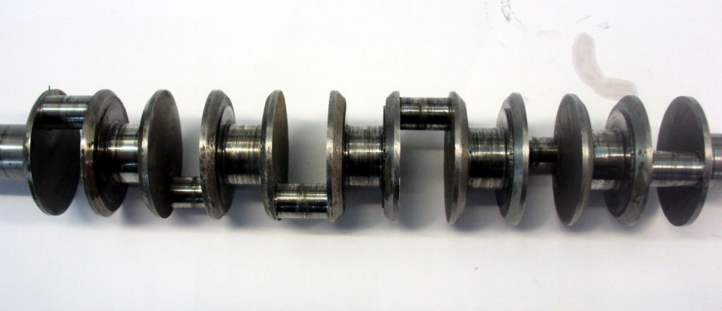

                                            having removed the crankshaft it was discovered that the lubrication of the main bearings was somewhat less than ideal so a bunch of corrective mods were carried out on the bearing shells to allow a greater influx of lubricant to the main journals. The next engine will allow for pressure fed lube straight from the blower to ensure good lube at the mains.
                                            The photo below shows the crank and bearings etc all refitted to the block and the supercharger refitted after the described mods were carried out.

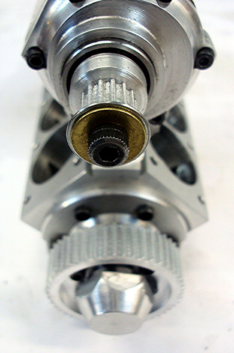

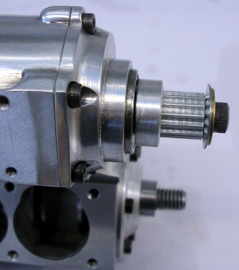

                                            here are the photos showing the progress on the toothed belt drive being fitted at the moment. the drive speed has been increased to 3.47 to 1………
                                            machining the bottom gear to fit the standard carrier I made previously.
                                            All fitted up the the carrier……….
                                            Now I only need to finish machining the belt cover housing and cover plate……. and by that I actually mean start maching it LOL….
                                            untill next time.
                                            Cheers
                                            Dean

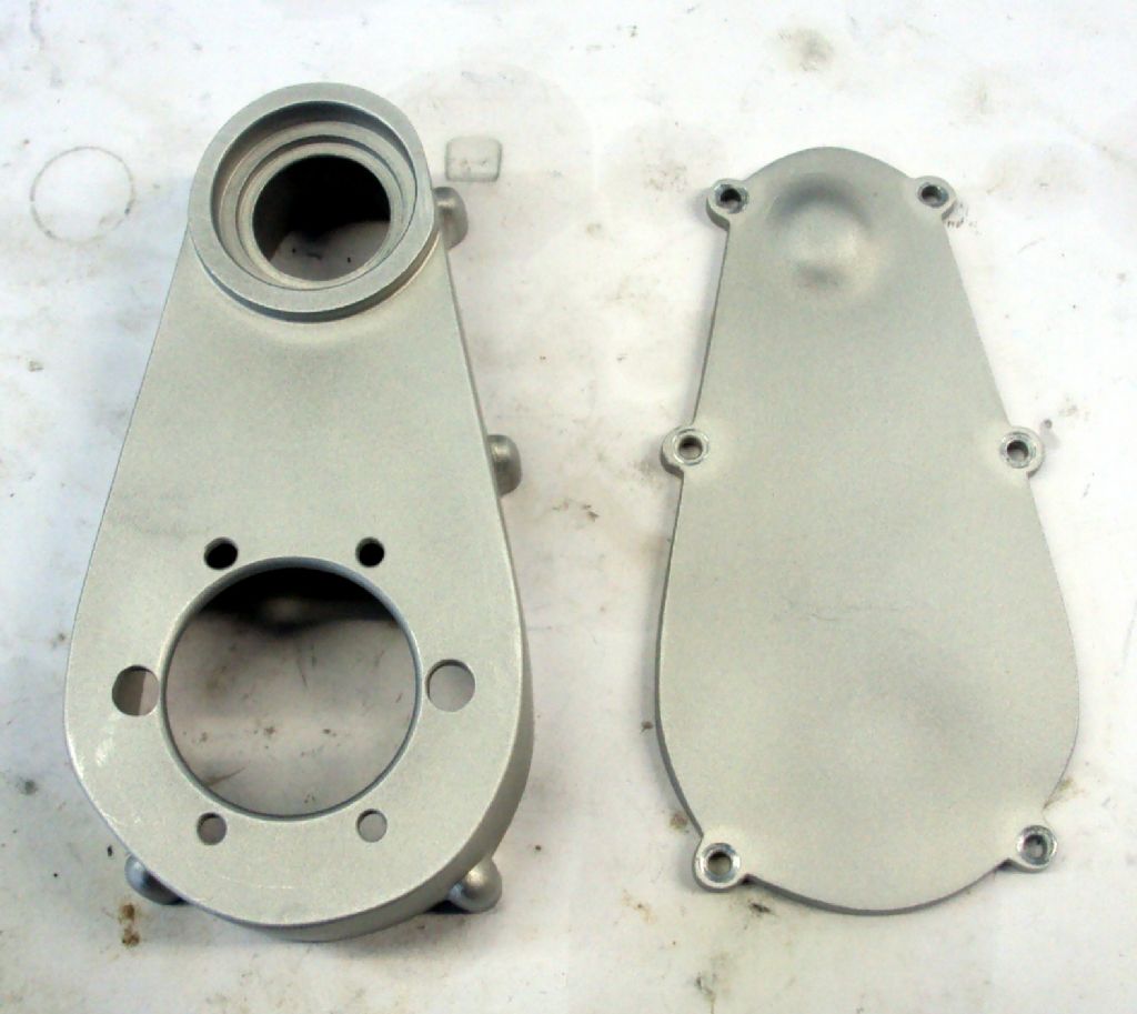

                                              Well here's the latest development for the belt drive cover………

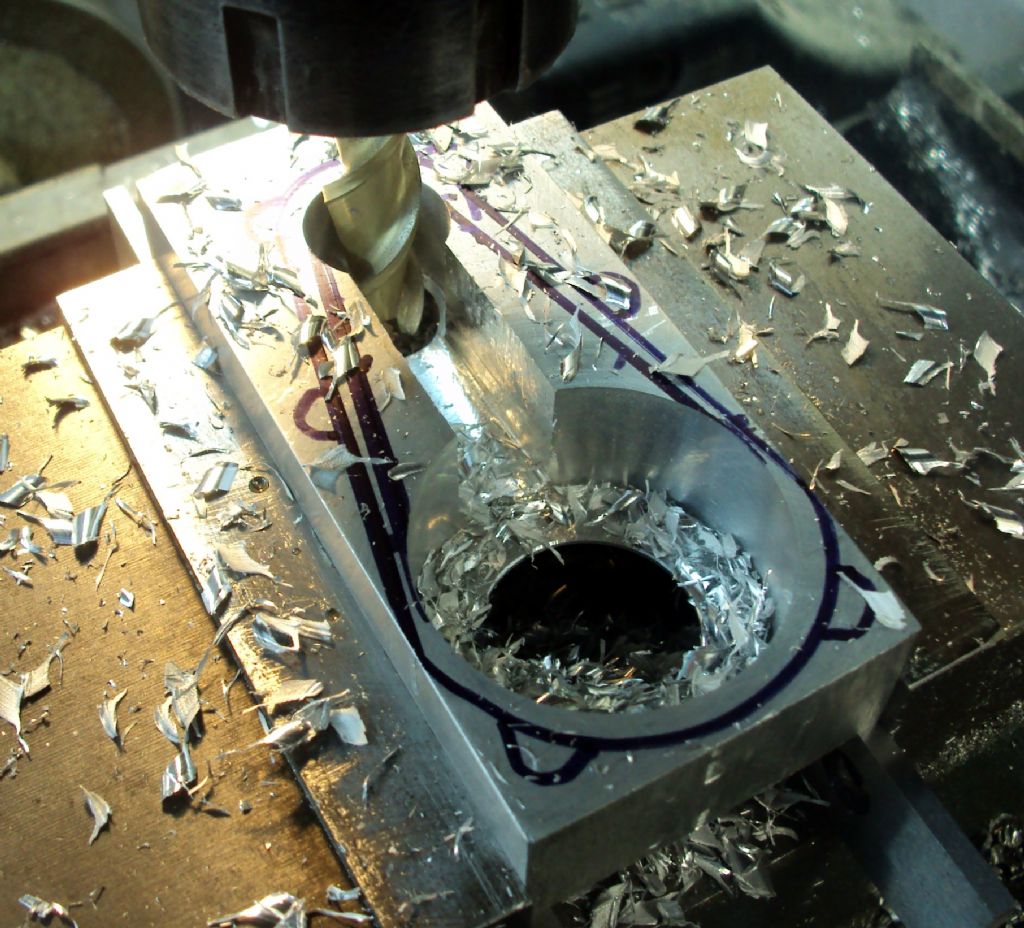

                                              Milling out the inside of the backplate………
                                              End of the roughing out stage 1, cover plate next then bolt them together to finish off the profiling.
                                              Cheers for now
                                              Dean

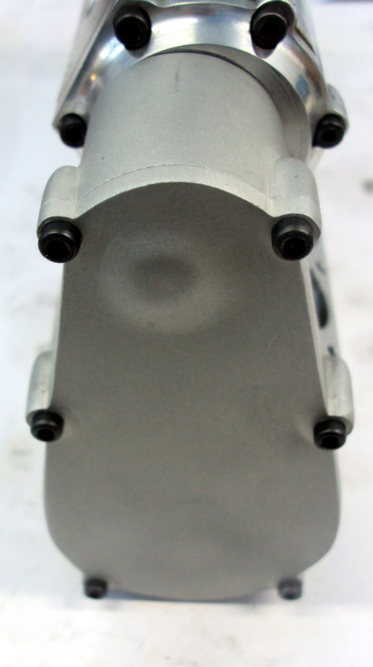

                                              #236402
                                              dean clarke 2
                                                @deanclarke2

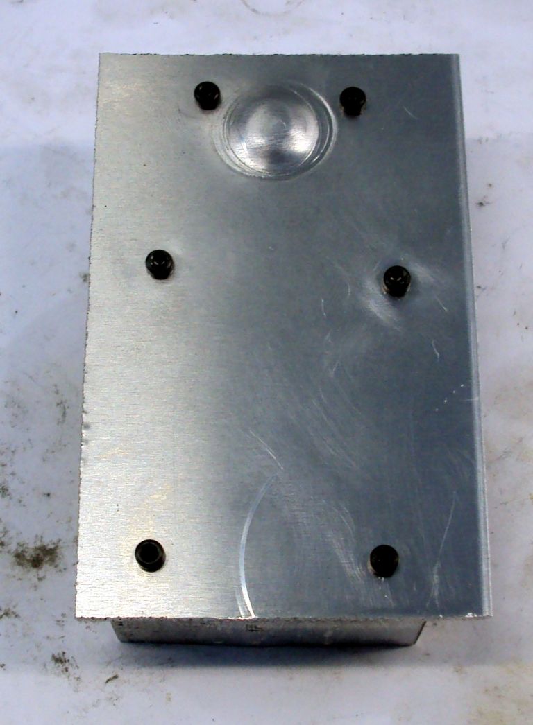

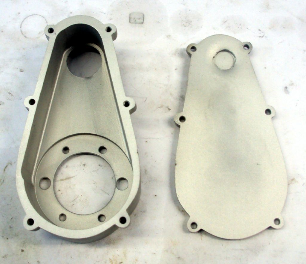

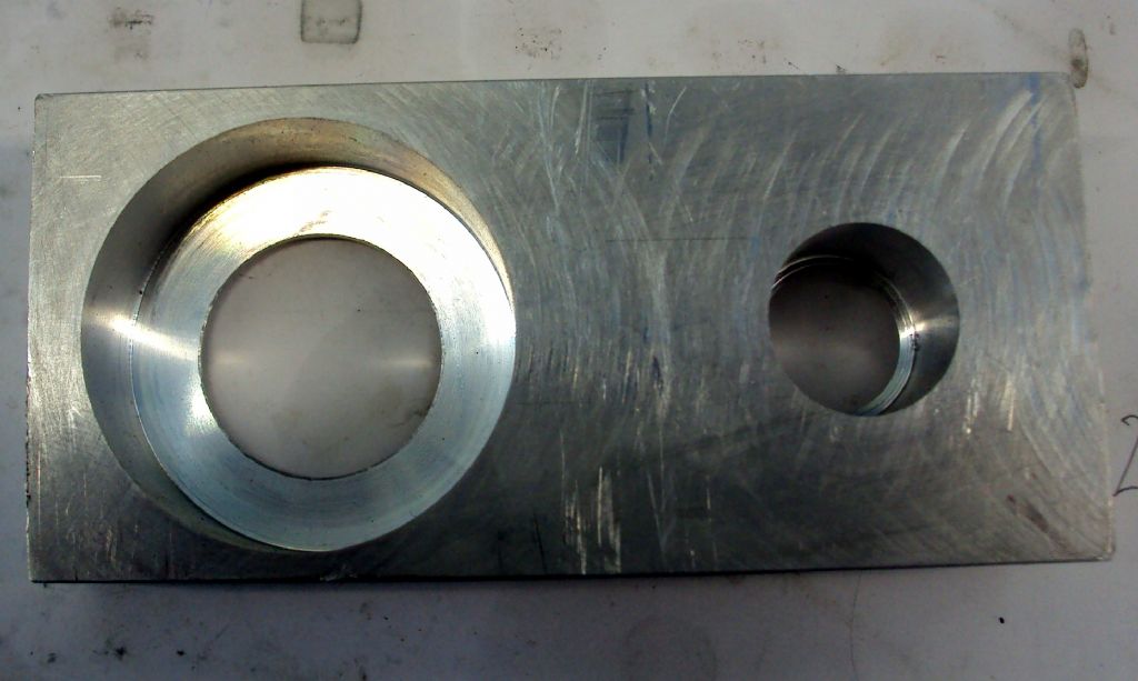

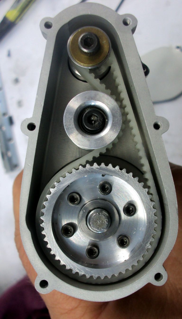

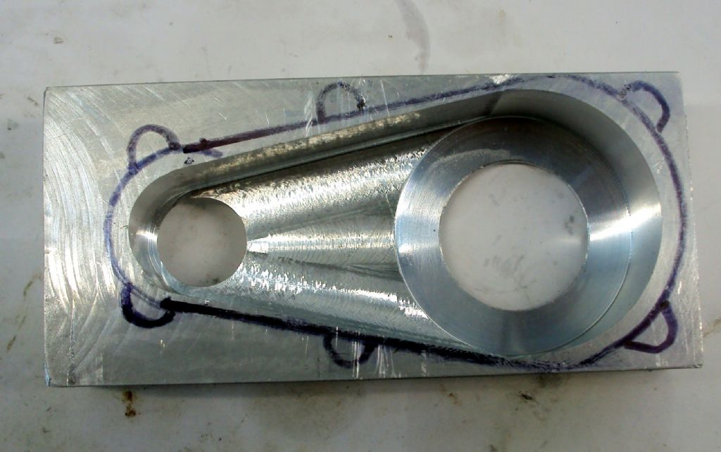

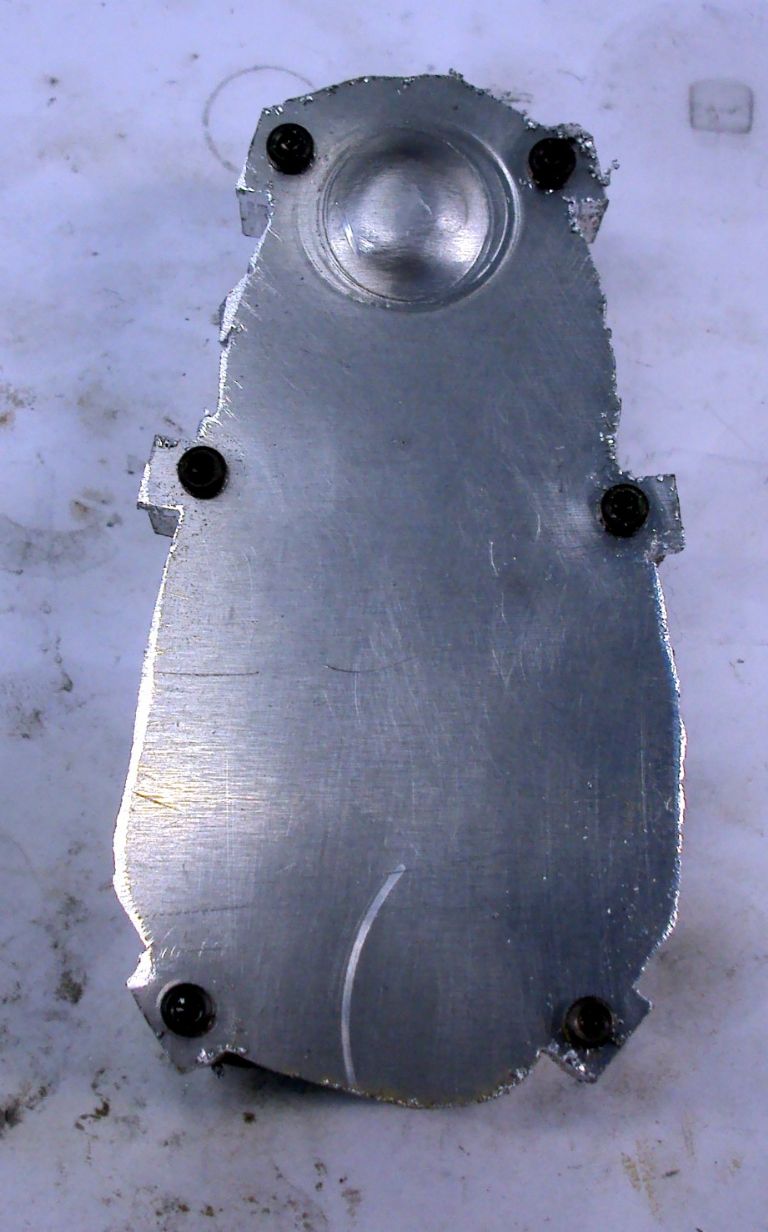

                                                So I have managed to make a bit more progress on the toothed belt drive for the v12, photos below show progress to date……………….
                                                cover plate.
                                                cover plate roughed out ready to finish to the back plate outline……
                                                all finished and bead blasted….
                                                Rear view of case.

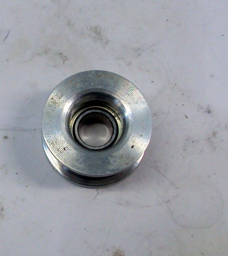

                                                Idler slash tensioner pully…….
                                                Test fitted to make sure it's all going to turn afterwards lol……….
                                                Better put the cover on to make sure its all still going to turn
                                                Cheers for now……..
                                                Dean

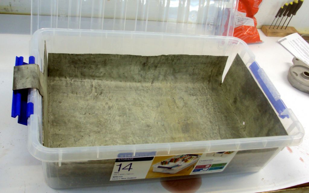

                                                #240432
                                                dean clarke 2
                                                  @deanclarke2

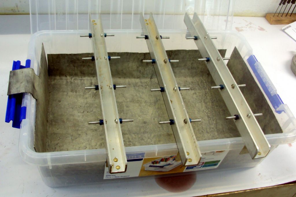

                                                  So it's been a little while since I last updated this thread so i though it was about time I pulled finger and got something done, here's the latest goings on with the anodising setup.
                                                  Now where did I put the acid?
                                                  Cheers for now
                                                  Dean
