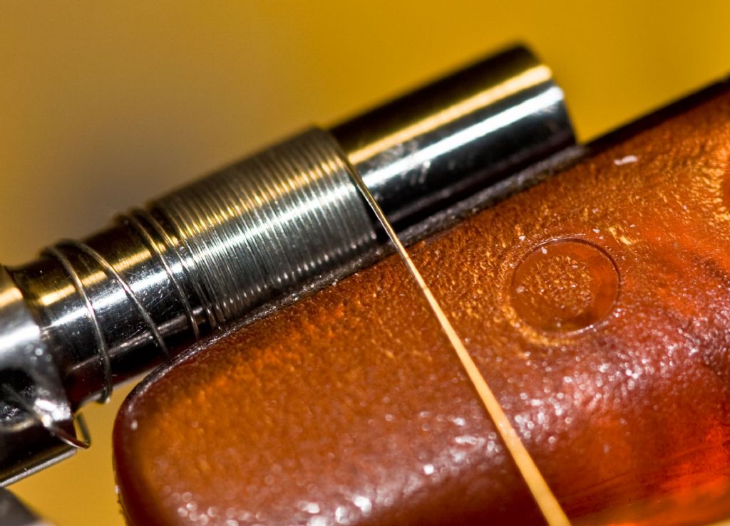

      When I introduced the thread about near empty tubes of super glue, and although it was a significant irritation at being ripped off, I was actually in the middle of some final experiments to make a usable balance spring for my skeleton clock.
      In previous threads about balance springs, I searched and tested several ideas to try to find (with my limited equipment), a reliable method. As my own notes show, I had determined that a wire diameter of 0.2mm (0.008″) would replace the flat section as used in the original clock design. This has since proved to be fairly accurate since the clock is now beating with an accuracy of less than 1 sec/hour, and responds well to fine adjustments.
      That said, I can briefly describe my approach to making my balance springs. The most significant problem I have had when winding the spring onto a 4.0mm diameter mandrel has been how to uncoil it successfully after winding. Once released, the usual result has been for the spring to fly open and to wrap itself into an unuseable mess. There have been some very useful comments posted, some of which pointed to additional twisting which takes place (unseen) during the winding process.
      Michael Williams wrote :- The traditional method of making very small springs with limited equipment is to pass the feed wire through a hole in a piece of flat soft wood and arrange for the flat part of the wood to bear down on the coils that you have already made . Until such time as you deliberately remove the wood the coil remains tight and under total control . You cut off surplus feed wire with the wood still in place and then slowly lift it away . As an added bonus there is an element of screw-cutting going on in the wood and after a few turns; a neat set of grooves form which help to keep the winding pitch constant . Please be very careful when winding springs under power – it is a terribly dangerous process.
      Perhaps it was the hidden twist and how I anchored both ends of the wire which were responsible.
      To avoid weakening the mandrel I had drilled the 1mm anchor hole through the larger 1/4″ diameter section. What seemed to be happening was that the wire was skidding down the side of the step, thus introducing extra twist. This was rectified in my final attempts.
      The free end was weighted and the wire was passed over a simple pulley. I took the trouble to stop the weight from spinning, expecting that any back and forth twisting would be transferred to the spring. Taking note of all the warnings, winding the wire onto the mandrel had always been done by hand with the main power switch turned off. This was very tedious and tiring for my old hands and fingers, since reaching the three-jaw was awkward. I had also chosen to wind the spring ACW so that I could see a little more of what was happening to the winding process.
      It was at that point that I decided to wind the wire under power with the lowest lathe speed (267 rpm), and in reverse. The chuck was bolted so there was never any danger from it unscrewing. I also calculated that I had at least 15 seconds before I had wound all of the 1 metre length of guitar string onto the mandrel. I stood ready to switch off, and hey presto, a nicely wound spring. That was until I removed the wood which Michael had suggested.
      Another tangled mess!
      That was when I went off at a tangent, and began to explore the possibility of gluing the wire to the mandrel, and using a solvent to let the spring slowly uncoil. The traditional `glue’ in clock making is shellac which dissolves in methylated sprits. This would be ideal, or so I thought. So I tried again giving the tightly wound wire a good coating of shellac, waiting overnight for it to set.
      It didn’t work so I figured that the shellac had not found its way under the wire and onto the mandrel. With that fixed, I tried again. The wire instantly flew into another mess, and another guitar string went into the bin. I interpreted this result to mean that the shellac was too brittle, and/or hadn’t bonded sufficiently. It was also possible that the meths had not fully evaporated completely from under the coils.
      That’s where the super glue came into the picture. I should (again) point out that super glue (cyanoacrylate) sets by combining with moisture from the atmosphere or from your breath. It is also supposed to soften in acetone, which would be ideal, or so I thought. With a very thin coating of super glue applied to the surface of the mandrel, I tried once more, applying two coats to the tightly wound coils. Several hours later, I cut the wire.
      Whoops!
      The wire uncoiled but didn’t tangle. But the freed wire was stuck together over much of the length of the spring, albeit at about the correct spring diameter of 9mm. I had my bottle of acetone (nail-polish remover) ready, and promptly dropped the spring into it. Nothing seemed to be happening. The coils remained stuck together, and the acetone seemed to be doing nothing either.
      When I fished the spring from the acetone, it became clear that although the glue had turned white(ish) it was still present. Very carefully, I teased the coils free, and found that I had to strip off whiskery lengths of glue still attached to the wire.
      Remember, the diameter of the wire is only 0.008″.

        I wanted a reliable means of controlling the wire.

          Because the nail polish remover is not pure, it has oils added to stop the spirit damaging the cuticles.
          Unfortunately its hard to get Acetone in small quantities.
          Perhaps buy the specialised super glue solvent!

              Some super glues contain things such as setting time inhibitors and thickening agents – the glue itself will dissolve but not these additional components .
              All your problems arise from putting secondary twists and varying bending forces into the wire when coiling . The only way to guarantee success with such a tiny spring is to either :
              (1) Work with hardened wire and contrive a winding system where every action is controlled and repeatable so that even when it goes wrong you can make it go wrong the same way every time and learn and adapt . This really means making a set up where the wire is controlled by mechanical means at all times during winding – you don’t handle it at all .
              (2) Work with softened wire and solve the rehardening and clean up problems . Probably not as difficult as it seems at first sight – Traditional method of hardening is to put spring onto a plain or threaded bar , cover spring with mixture of lime and soap and then harden and temper the whole lot using an exposed bit of the bar to judge temperature . The soap/lime mixture will dissolve away slowly in water leaving the spring clean and with a pleasing metallic grey type of finish . A variation on this method is to put the spring covered in a small open topped tray of fine sand and use a slip of plain steel as an indicator .
              Personally I would put all my efforts into the hardened wire process .

                          In getting close to completing each step of my skeleton clock, I believe that I owe several of you gentlemen a thank you and at least show my final method for making the balance spring. I must preface my notes by reviewing a few issues, and to intersperse acknowledgments for the ideas of others who helped me to reach what I believe is a viable solution.
                          Background
                          I have already mentioned in previous discussions that the helical spring in my John Stevens skeleton clock was originally intended to be a rectangular cross-section from wire 0.020″ x 0.005″ (I will stay in Imperial units for this exercise). It can be appreciated that a spring wound from wire with a rectangular cross-section offers lots of vertical stiffness, while remaining far less rigid in the direction it will bend in use. For a wide range of reasons, too numerous to list here, I elected to recalculate the stiffness in terms of round wire. This was a simple exercise to determine the equivalent stiffness (moment of inertia) in my CAD package. A wire 0.008″ in diameter was the result.
                          Where to get this size of wire?
                          Someone suggested guitar strings, and I was lucky enough to discover from a friend who owns a music shop, that this was the smallest string normally available over the counter. Such luck!
                          The finished sizes of the helical spring were to be 3/8″ OD and nine turns to produce a working length of about 3/8″. Had I still retained my Myford and other workshop machinery, I could have set the pitch accurately and wound the spring with the pitch built into the winding process. I would also have guided the wire onto the mandrel as was also recommended in various places and by the kind thoughts of other contributors. However, I had borrowed a lathe which was not very attractive in the screw-cutting department, and therefore elected to close-coil the wire. In other words, the wire would be touching itself on each successive rotation of the mandrel. I have also to say here, and as was explained to me some time ago, the wire is itself, caused to twist on its axis during the process of winding. I have no idea how this manifests itself, so I chose to ignore it other than to allow the wire to have the maximum amount of freedom as winding took place.
                          Winding tests showed that a 5/32″ steel mandrel would, when the wire was cut free, produce the requisite spring OD of 3/8″. Up until now, I had turned the power off to the lathe, and only turned the three-jaw chuck (backwards) by hand. Very tedious, but also fairly safe. Unlike running under power which is not recommended.
                          Controlling how the wire was held in place on the mandrel both during the winding stage, and before being released, had already been discussed elsewhere and amounted to applying pressure to the coils with a fixed piece of soft wood and running this with the lead-screw feed set to the spring pitch.
                          My efforts were abysmal.
                          I couldn’t control the coils which would wrap themselves together in an unglorified tangle. I was also drawing attention from SWAMBO, who had begun to notice how much time I was spending in the music shop, and how much housekeeping was going on emptying the music shop of guitar strings. So I needed another method of stopping the coils flying apart uncontrollably once I had made that necessary cut.
                          Method
                          Before explaining my technique, it is essential that you take great care to avoid accidents.
                          WINDING SPRINGS CAN CAUSE SERIOUS INJURY.
                          Using 0.008″ diameter guitar strings, which are about 39″ long, I ran a weighted nylon thread over a pulley for more than this length so that the guitar string had plenty of freedom to twist on its axis should that be taking place. My weight was a convenient drill chuck off the lathe, and weighed about 1/4 lb. The next tricky bit was threading the guitar string through a tiny hole drilled across the mandrel, sharp edges removed, and then rotating the lathe chuck until the end of the wire was caught and secure. The position of this hole in earlier attempts (with the hole drilled into the adjacent larger diameter of the mandrel) had, I believe, introduced some addition twisting into the wire as the wire slid briefly down onto the working diameter of the mandrel. The nylon thread (with weight attached), and the wire are suitably connected, and the winding process can begin. I also took great care to avoid kinking the wire in any way. Clearly, this would affect the desired outcome.
                          While I am certainly not recommending driving the chuck under power, I was running out of time, patience, guitar strings, and the need to avoid getting cramp in my old hands. I calculated that the winding time under power would be about 15 seconds, so I set the lathe in reverse (it has a bolt-on chuck so would not unscrew), and standing well clear, I turned on the power. It worked like a charm.
                          But I still had to stop the coils from spinning off the mandrel. It was then that I hit on the rather ludicrous idea of gluing the wire to the mandrel. Having noted on many an occasion that clock and watch makers use shellac as a glue, I pasted some of my own concoction over the coils, hoping that I could later soak the glue and the wire in meths and trusting that the coils would uncoil themselves slowly and under control.
                          It failed!
                          The shellac had not f

                              The shellac had not found its way between the wire and the mandrel, or if it had, it had failed to set/dry. OK, I’ll use super-glue!
                              Have you ever bought 3ml tubes of super glue, and found that they contain less than half a ml? But that’s another story.
                              Super glue sets as it combines with moisture in the atmosphere. It also dissolves in acetone. You get my picture? I was down to my last guitar string, so my last attempt had to work. I painted a very thin layer of super glue onto the mandrel, and wound my remaining string as before. Then I painted an ample coating of super glue onto the coils, before heading off to my nearest (and cheapest) source of acetone. The Cheap Shop had nail-polish remover for a couple of dollars. Now came the witching hour as I cut the wire.
                              Zipp! The wire flew off the mandrel as before, but this time (it would appear), there was enough super glue remaining to hold the coils together rather than having them fly around. I dropped the promising result into the glass bottle of nail-polish remover, and waited for several hours, observing occasionally, that nothing was happening. Mumble grunt.
                              When I did finally fish the wire from the nail-polish remover, I could see under magnification, that there was still undissolved glue holding the coils in place. Gradually, I peeled off the glue to expose what I now consider to be a near perfect result. I was later informed by a kind gentleman that nail polish remover contains certain oils which could preclude the dissolving process, and that pure acetone might be the better option.
                              There, gentlemen is my method.

                                          Finally, you almost brought tears to my eyes when you mentioned nickel chrome. Not the wire so much as it being a favourite steel for plastics moulds, the business I started in as a raw apprentice.
                                          Best regards,
                                          Sam
