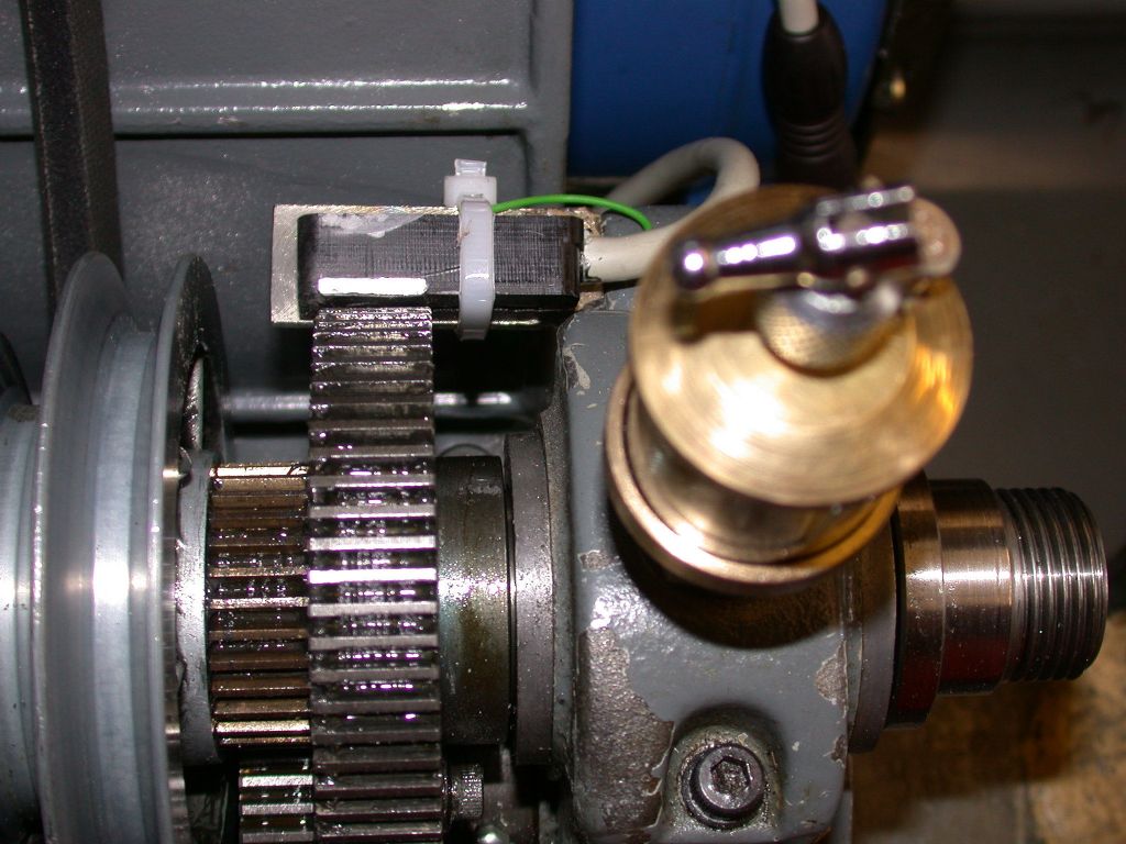

                  If you don’t mind building at tachometer yourself there is a design on my website that may suit you.
                  I did submit the design to MEW about two years ago but I have not heard of any plans to publish it.
                  There is a picture of how Roy Stark mounted a hall sensor on his Myford in “My photos” in the album “misc” (For some reason this photo will not insert into this reply.)

                        Here is the picture that would not insert into my last post. (After loading into paint shop pro and saving a copy of it.)
                        Les.
