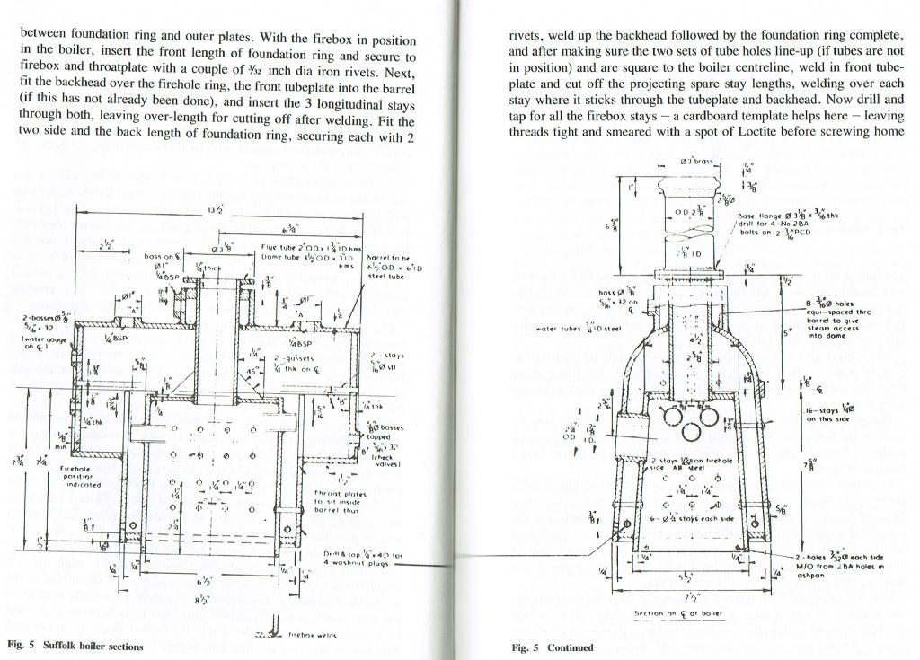

              Thanks for that Its the bucket articles I'm after. its the flange the chimney bolts to that wobbles,I cant see how its fixed to the boiler flue
              #169883
                Should be welded, click image for larger view
                #169895
                Wiliam Henson
                  @wiliamhenson14652
                  Thanks Jason. Mines a copper boiler so I guess its silver soldered
