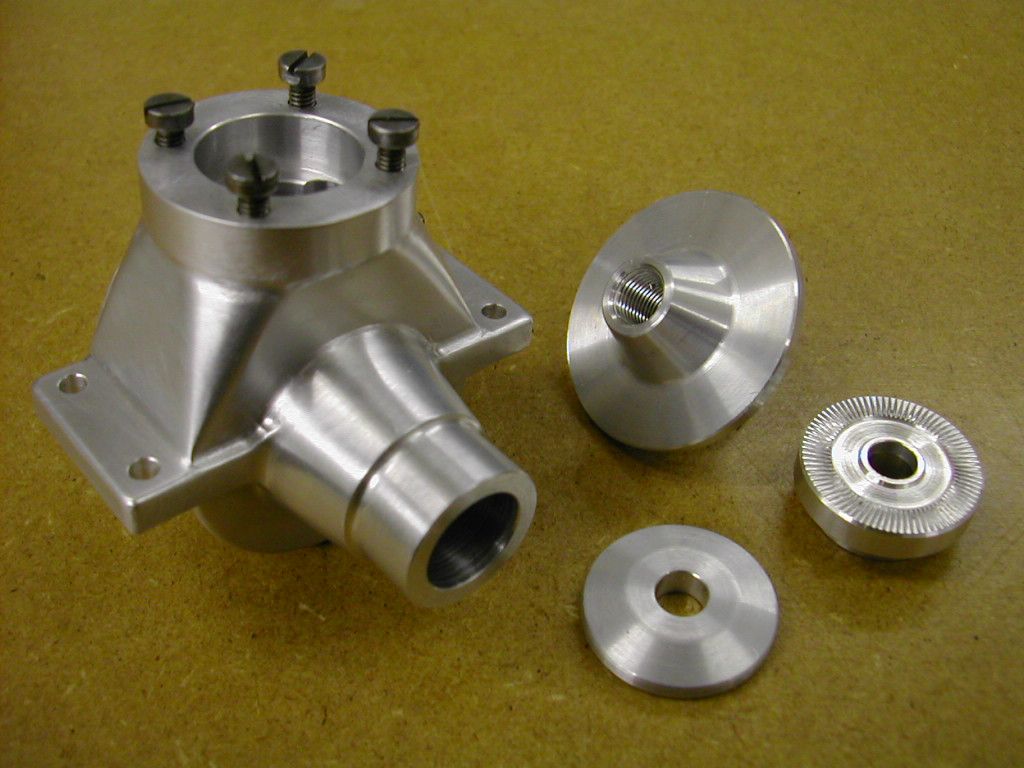

                Thanks everyone – I will digest all that later on. I just wanted to post some progress as opposed to problems. So here is a summary of the work on the covers. This is the second attempt:
                Smaller cutters, smaller cuts, lower speed:
                Surfacer the top, so all square:
                Co-ordinate drilled the holes, deep enough to get two slices:
                Hacksawed the first slice of, re-faced, then sawed the second one off:
                Then cleaned up the sawn faces:
                #605116
                Dr_GMJN
                  @dr_gmjn
                  Then setup in the rotary table, centering on the oiler hole. This is what the blanks looked like:
                  I set up an air line to blow the chips away, I didn’t want them getting stuck in the recess:
                  Milling the outline:
                  Then rotated the table around the central hole to give a radiussed pad:
                  Then tapped the 5BA threads for the oilers (which I need to make):
                  Then faced to the correct thickness:
                  Result:
                  Primed:
                  Test fitted to the other bits:
                  Might not look much at the moment, but there is a lot of work just in those assemblies…

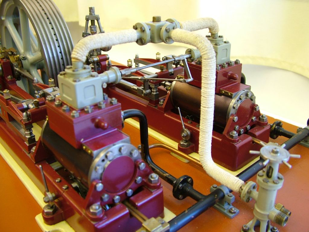

                          As an aside Doc – how are you going to bring the 'steam' (air) in if you are mounting oilers on the steam chest. Do you have an inlet in the side of the valve chest that's out of sight in those images
                          Most large stationary engines had steam directly into the top face of the cylinder where a larger surface are allowed for a bigger inlet valve Whilst there would no doubt be oilers mounted on the steam chest the steam inlet would usually be there too.
                          The throttles for the governor are within the blocks. I didn't make butterfly types but rotary ones similar to a model aircraft engine carb. Obviously if it's a twin set up unlike a compound the governor should control both cylinders
                          Hope that's of use

                                The oiler on mine is that point on the top of the central manifold. I had originally intended to fit a working oiler plumbed to that point but that never happened. The engine was displayed a lot, originally on steam then on air. Oiling was carried out by removing the plug, squeezing a slug of steam oil in from a syringe and replacing the plug. On steam that would last quite a while but virtually all day on air.
                                When I have run my other engines as such I just squeeze the oil in to where the airline enters. I always use steam oil even on air – works well without emulsifying.

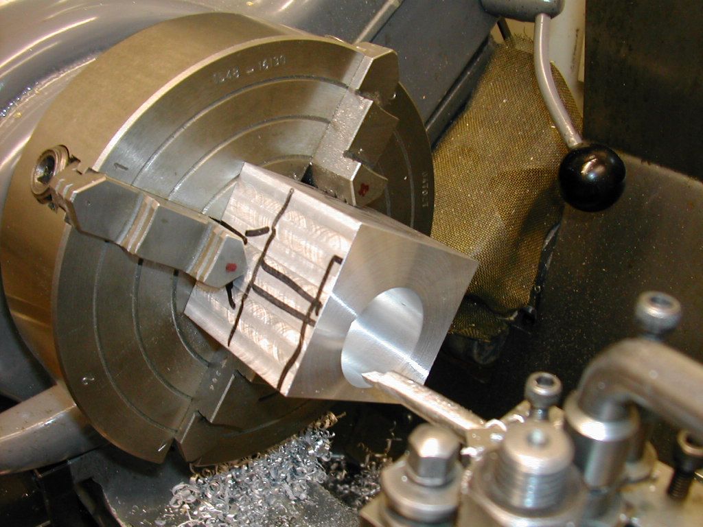

                                      Here's an example – this could have begun from a sawn off block straight in the lathe but blocking first gave firm reference faces – the turned face and bores the first datum finished to dimension from which all else is referenced to – much more difficult to create if if the block was still sawn
                                      Here's the result
                                      I'm now off to put some more into the F4 – enjoy your day
                                      Best – R

                                                Hate to put my safety hat on Doc but that's exactly what I meant too – you'd have found it had it hit you in the face sad
                                                The idea that the video shows is indeed a quick way to ensure 5 sides of a square or rectangular block are true to each other and is one tried and endorsed but both Jason and I are trying to get you to see that no matter how good the surfaces look when sawn the chances of them being parallel are pretty slim.
                                                Had you have taken a skim over all side faces of the block beforehand the next time you pick it up it will pop straight in the vise – to my mind it's a bad habit to get into and one which will eventually lead to a decision 'not to do that again' but then of course by then something will be truly spoilt – workpiece, machine or flesh – potentially all three together.
                                                Each time you grip something like that in the vise – packing or not – you will be straining the vise beyond it's design parameters at the very least.
                                                Just saying!
