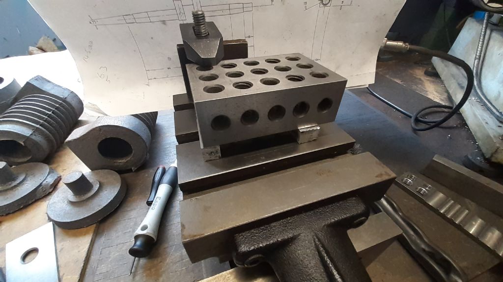

    Clive Brown 1
      @clivebrown1
      Posted by Dr_GMJN on 27/07/2021 00:21:41:
      ETA I could remove the top clamp for the final fine cuts to eliminate any distortion I guess?
      Edited By Dr_GMJN on 27/07/2021 00:31:44
      I think that's the last thing I'd want to do. Distortion of the CI casting will be insignificant and there's a chance of the set-up moving slightly.

          Dr_GMJN
            @dr_gmjn
            Posted by Zan on 27/07/2021 09:13:14:
            The problem with a strap clamp like yours is that all the down force could be on a single pimple point on the valve face, thus you only have in effect one clamping point with a very high force on it. This makes them a bit of a problem compared to 4 clamps . Do be certain to use t bars not t nuts or there is a real risk of breaking the t slot in the cross slide, there wupill be considerable force on them
            Edited By Zan on 27/07/2021 09:14:38
            Thanks Zan, what's a T-Bar?

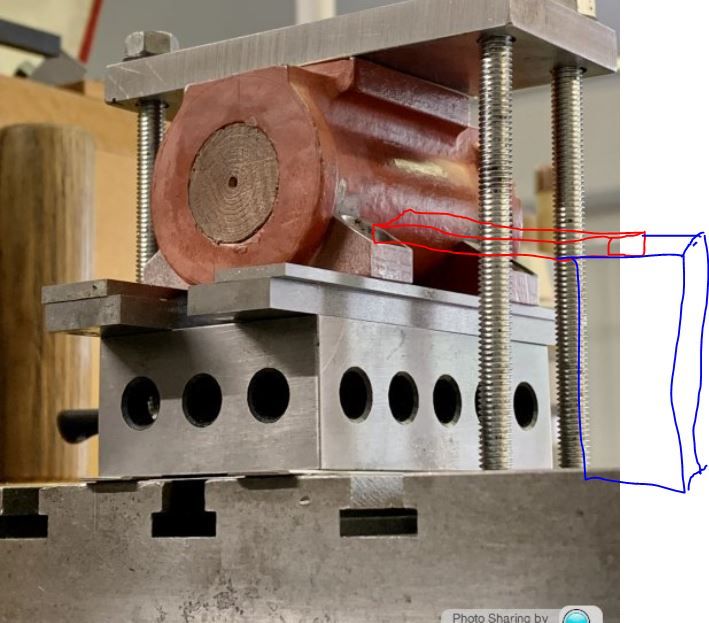

                I'm not sure why you are saying there are not enough tee slots. You could use the slots that the existing top clamp is held down by and easily fit 4 individual clamps with narrowed ends onto each foot pocket and support the other end with blocks.
                The machining plate that the casting could be screwed down onto is another method I use quite often usually to hold the whole base of an open crank engine with as the sides of the plate also act as a good straight surface to clock with a DTI
                On the other hand I would say many of these 2 x 1 Stuart cylinders have been machined with just a simple top clamp over the top as that is how Andrew Smith shows them being done in his books and the way I did my beam engine many moons ago and the bar was only 1/4" x 3/4" with a M6 stud either side. Even Tubal Cain uses little more than that in teh Princess Royal article, looks like a bit os 1 x 1 x 1/8" angle to mesmiley
                Edited By JasonB on 27/07/2021 10:17:44

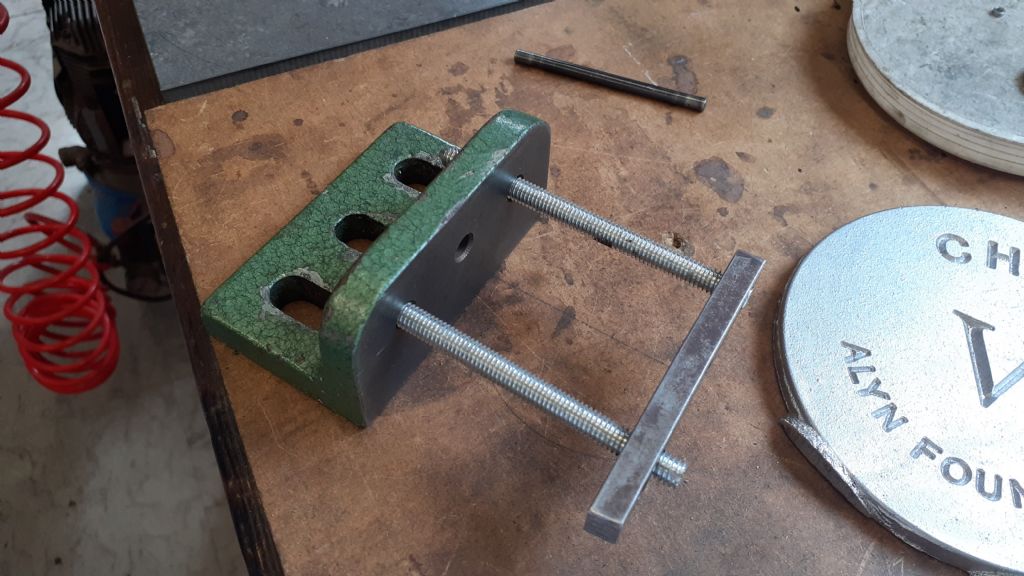

                  Just had a rumage and found the clamping bar used on my Beam cylinder, probably did not have the othet holes at the time. This clamped the casting to a small faceplate so minimal clamp contact and a smaller "flat" face as I used the port face against the angle plate rather than your wider spread feet. All spinning on the faceplate. This is as I said how Andrew Smith shows it in all his books and I was using his beam engine book as my guide at the time as have many others.

                  Dr_GMJN
                    @dr_gmjn
                    Thanks both. Jason – the other side of the part to your sketch has virtually no room to put a clamp support. It’s the t-slot, a bit of land then fresh air. I can’t move it further over the other way because there are no t-slots where the top slide locates in its hole.
                    I take the point about potentially having a single small contact area on the (unmachined) valve face, but even so, the clamp load has to react somewhere, so this can only be through the machined feet, onto the parallels. BTW I did put a piece of thick paper on the valve face to give a bit more grip.
                    As Jason says, I think the way I’ve done it is similar to what I’ve seen before for this type of thing, but it does seem like it could do with a belt and braces approach.
                    Cheers.

                    Dr_GMJN
                      @dr_gmjn
                      Also – I had to shim and pack to get the right height, and this gives lots of interfaces, all with the potential to slip. I might re-visit the vertical slide method to get around this, but that was also problematic in terms of clamp space when I tried it the other day.

                          I'd say you still have plenty of room at the back for the packing that the clamp bears on, only needs to be 1/4" wide which will easily keep the stud on the work side of the clamp.
                          Regarding the possible slippyness of the stack of packers, it looks like you are 3/8" plus some feeler gauges. If you have a bit of the 1" x 1/2" aluminium left over from the base take a 2" length, saw it down the middle and then mill to the thickness of what all your packers measure and use one each end of the 1-2-3 block
                          #555982

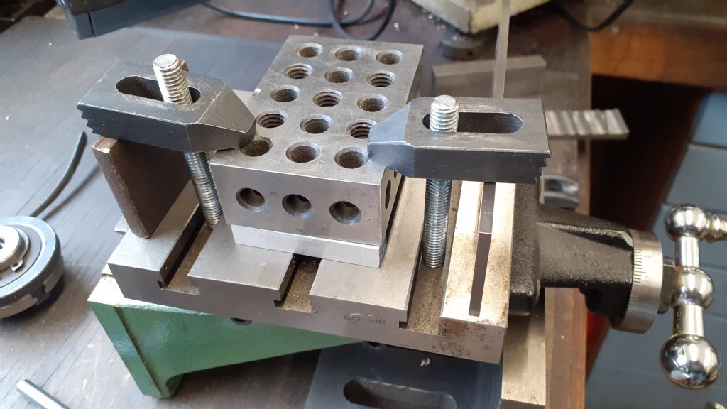

                              I don't have a Myford but am fairly sure the tee slots on the vertical slide are at the same spacing as the lathe's cross slide so you could clamp along these lines but two clamps at the back an dtwo at the front so you are clamping on all 4 feet.
                              I've also added the bits of aluminium to replace the stack of packers, though thinking about it would probably have them on top of the 1-2-3 block then the "casting" has something soft to sit down onto
                              #555999

                                Yes – would agree with that Jason – much more secure.
                                I also prefer to use a vertical slide in situations like this though have used the saddle as Doc is doing but the vertical slide enables precise location in both planes yes Depends on whether you have one of course

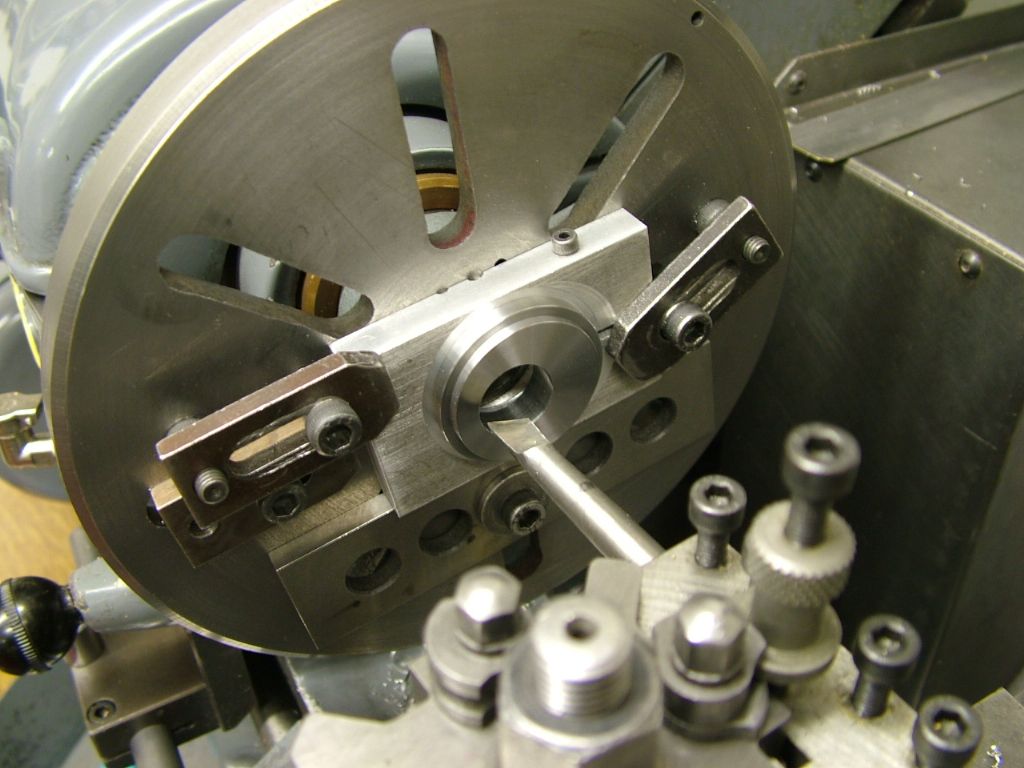

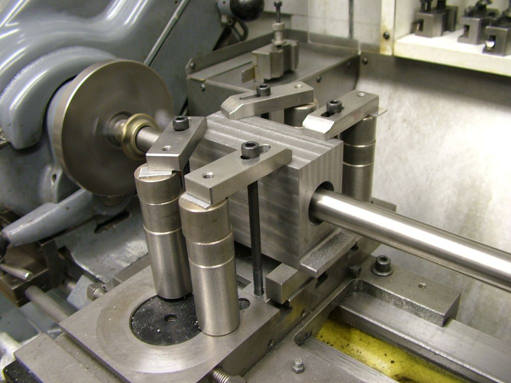

                                  Ramon Wilson
                                    @ramonwilson3
                                    I've been try to find an image of a set up used but this is the only one I have similar to yours Doc
                                    The bolts as said are M6 and the clamps are home made from mild steel. They are the largest I possess. The packing is differing lengths of 25mm dia BMS drilled through 6.5 and counterbored to take an M6 caphead head diameter so they can be bolted to the table or faceplate etc if desired. The thin packing provides a slight downward angle to the clamp so pressure is always on the work area and not on the edge.
                                    These small clamps are from my very first lathe, a Unimat SL. They see a lot of use in all sorts of set ups, I have just four of them. The tapped holes in either clamp is so that a cap head screw in reverse to the bolt can be used as adjustable packing as here.
                                    You do not need big clamps to secure large parts but it's always best to use several strategically placed
                                    Only three are being used here because the part is sitting on three points of contact. Always try to have a solid support between the clamp and the table where ever possible. Sometimes that isn't always the case but be aware that even the slightest tension on an unsupported casting can and probably will, lead to distortion however slight.
                                    Bolting the part to a subplate is of course an acceptable solution too but the rigidity of the setup is down to the size of the bolts. There can be quite a bit of force in boring the first cut on a cylinder from 'as cast' especially if going through a hard spot .
                                    Theres nothing to fear about this op – just want to see you do it successfully yes
                                    Regards – Ramon
