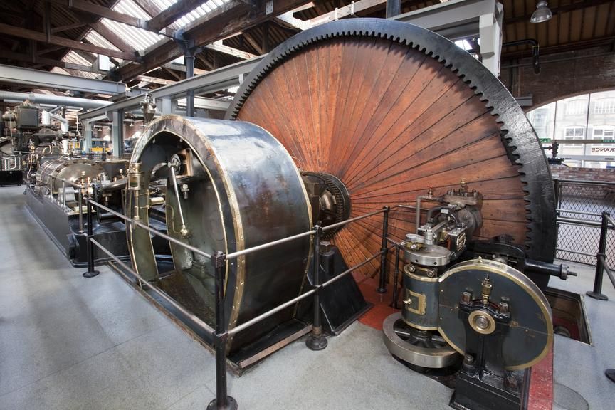

      Posted by Dr_GMJN on 20/10/2020 21:22:09:
      Does anyone have reference images of real-life twin cylinder mill engines as inspiration for perhaps adding a few other details?
      Thanks very much all.
      I can't remember if it's twin cylinder or not, but the Stuart Victoria always puts me in mind of the mill engine at the Manchester Science & Industry Museum. Some nice pictures of details on the museum site, but no general view of the engine:
      https://collection.sciencemuseumgroup.org.uk/objects/co8404994/firgrove-mill-steam-engine-steam-engine

        Personal preference, but for me the flywheel is one of the focal points of a stationary engine, and looks wrong boarded over.
        Like I say – just personal preference.

          Dr G if you have any doubts on JB Weld I think it's fair to say, having used both over many years in varying situations, that it is a far superior product than Araldite in this type of application. It has a very high tensile strength and will not break down under higher temperatures. During a build described over on MEM I did some pressure testing of it – not exactly under scientific conditions but enough to prove it's value as a high strength material. I then built a one piece cylinder block for a Double Ten with it – no issues on 60 psi 'dried' but not superheated steam. I can post the link if you require.
          As Roy says, many, though not all, mill engines had their flywheels boarded in to reduce windage. Andy – is this the one you are thinking of at the Manchester museum?
          This McNaught Corliss twin tandem is a truly lovely engine but I think you'd have to go along way to make a Victoria look like it. That said of course there's 'nowt like tryin'
          Flywheels can be built up of course so that is another option but personally I don't think I could live with knowing it's solid under the boarding – but then that's just me wink

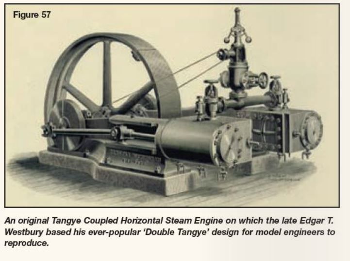

                                    Ramon as for full size practice with a single governor one of the main problem is finding engines being run as double high particularly in the larger sizes as the Doc wants to represent as most would have been cross compounds but I think we can take it as doable if Tangyes are anything to go by. If going down the route of fabrication the cylinders then no reason not to opt for compound if only from the outside and some inventive passages to get the air/steam into the right places if keeping the model as double high mechanically.
