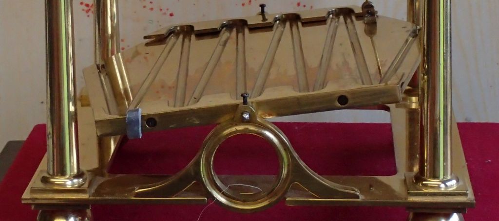

      I am trying to service (fix) a Congreve Clock. The table is suspended on two small – four ball – bearings. The outer race is mounted in the edge of the table, and the inner race comprises tapered steel pins which insert from each side.
      Table – the bearing pins are held by a locking screw in the mounts.

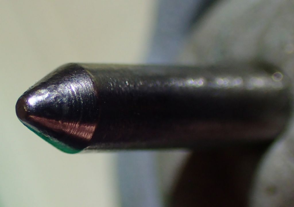

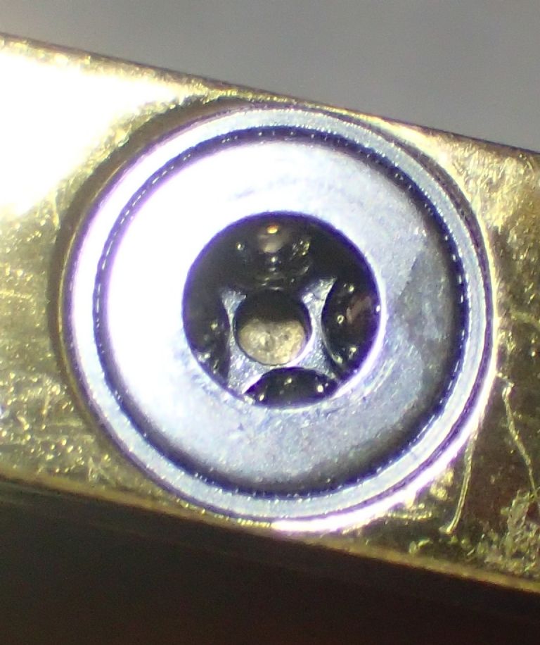

      The bearings have four balls in a cage, and are 7.75mm OD as near as I can measure in situ, while the open end is 3.50mm ID. The pins are poor shape, and don't seem to be hardened
      I will make new pins from silver steel and harden them, but I wonder if anyone can point me in the direction of a source of new bearings – should I need them.

          It is possible to buy just bearing balls, and that's likely what you'd need do.
          You say your measurement is necessarily approximate, so that odd-looking 7.75mm might be an Imperial diameter, 5/16" (7.94mm) being the closest.

            I doubt if anyone will stock the original type of bearing assembly but you could replace the balls if the guides are not worn,  Suppliers of ball bearings, here in Australia, also sell just the balls. Those in the UK should also do the same.
            Is it possible to use a standard ball bearing with the same OD and make an insert for the centre that will engage with the location pins ?  Or a smaller bearing that will accept the location pins and make an addaptor for the bearing OD ?

                I have seen that pattern of bearing mentioned somewhere with a horological connection, but can't remember where. I must say that I'd be inclined to replace them with conventional small unshielded ball races, or ceramic ball ones, with the grease washed out (not ultrasonically cleaned). Someone in Australia did extensive measurements of friction of standard ball races and found they compared favourably even with jewelled bearings. Seems to me to be no advantage in only having balls below the pin, the ones above won't be carrying any load so in effect "won't be there".

                    Thanks all. I am not sure that new individual balls are going to be the answer, as the outer "shield" of the bearings looks as if it has been inserted in the same way as conventional bearings – and removing it will probably be a destructive process. I suspect if I need new bearings Paul and John's suggestion to replace them with conventional bearings and modify the support pins for the ID of the new ones is the most sensible route.
                    Yes John, I have seen the papers on running small bearings dry and clean in clocks, and will be treating these bearings ( and the conventional shielded one on the escapement arbour) to a good flush out. I suspect the reference to similar bearings in a horological context you mention may be the Eureka clock bearings which come in two and three ball styles with two balls below the pivot and one ( in the three ball arrangement) above. Those however are loose balls retained on one side by a glass plate.

                      I recon that when you replace the shaft with one that has hardened ends everything will be hunky dory. The balls and outer race are hard already and just need washing and relubricating. I have seen lots of this type of bearing in aircraft instruments, they are very low friction.

                          I've found that if I just need a couple of balls I buy an unshielded ball race and press out the cage, move the balls all to one side and remove the inner race. Simples. The interesting thing I've found is that metric ball races often have Imperial sized balls ! This may be because the machines that make the balls were originally imperial and they never bothered to change the design but there may be other reasons.
