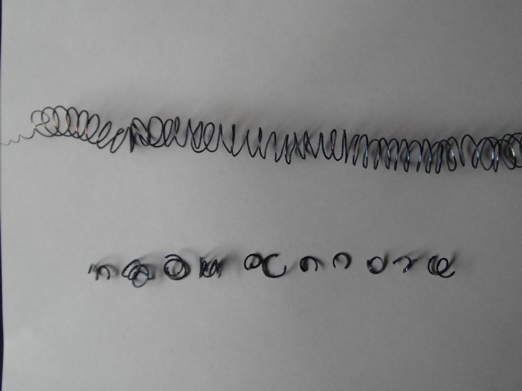

        Turning aluminium or steel my lathe produces long ribbons of swarf most of the time, up to 5m long! It does this with HSS and Carbide despite both tools having chip-breaker edges.
        The ribbons get tangled around the tool-post and have to be cleared regularly. They get caught between the tool and the work and spoil the finish. When I had a mini-lathe a ribbon found it's way into the electrics and started a firework display. Blood has been drawn by a ball of swarf flung in my face when it caught in the chuck, and the steel ribbon can be razor sharp and smoking hot. I do not like ribbons.
        Once in a while the lathe breaks the ribbon at each turn or so. This is exactly what I want, but I don't know what I'm doing different to cause chips to form.
        I have a book that says the cure is to increase the depth of cut. Trying this just produces heavier ribbons:
        The top example is from 1" diameter mild-steel cut 0.6mm (24 thou) deep (ie 1.2mm off the diameter) at 2000rpm with a carbide insert. Though the lathe doesn't seem to mind I think this is a heavy cut. The example underneath is the same rod cut 0.2mm deep.
        The two lower examples are 20mm diameter Aluminum Alloy cut with HSS at 500 rpm. The lower example is a 0.1mm deep cut, the upper 0.2mm (8 thou).
        The lathe is a Warco WM280 with a 1500W 3-phase motor and VDF.
        What's the best way of producing chips rather than ribbons please?

              First thing is to bin the book.
              Second thing is to repeat this mantra – feedrate, feedrate, feedrate
              For 1" diameter steel I'd be running at 1200rpm. The DOC ideally needs to be more than the nose radius of of the insert, although that it does depend upon the material. For roughing I use 0.1" (0.2" off the diameter) which is convenient as it is one turn of the cross slide handle. Finishing cuts may be 20-40 thou depending upon how much material is left.
              To get the insert chip breakers to work you need higher feedrates. For steel 4 thou per rev is about the minimum I use, but often 6 thou per rev for roughing. Aluminium seems to need higher feedrates, say 8-10 thou per rev, even with inserts designed for aluminium.
              If you buy inserts in quantity they come in boxes with cutting details on the back. Here are some typical figures:
              Korloy CCMT09T304 NC3220 for steel: DOC 0.30 to 3.00mm feedrate 0.08 to 0.23mm surface speed 150 to 350m/min
              Korloy CCGT09T304 H01 for aluminium: DOC 0.10 to 5.00mm feedrate 0.02 to 0.30mm surface speed 100 to 200m/min
              It's interesting that the minimum recommended DOC, feedrate and surface speeds are less for aluminium than for steel.
              Andrew

                I'd got into the habit of leaving the lathe set at the lowest feed-rate with the notion that this produced the best finish. Well maybe for the finishing cuts, but I hadn't thought it through.
                After chanting the manta I just tried the lathe at 1200rpm with 4x the feed-rate. The tendency to ribbon is much reduced, it cuts well and – bonus – it removes metal much faster.
                There's an odd bit of stainless scrap piping in the chuck at the moment so I shall be trying again tomorrow with a known mild steel. I'm pretty confident in the result though. I shall look into the insert too – it came with the holder and although it cuts it may not be ideal.
                Yet again I'm feeling dim – I must have tried changing everything on the lathe apart from the feed-rate. I've also twigged that there was less ribbon produced when I cranked the saddle by hand rather than using self-act. If only I'd joined the dots…

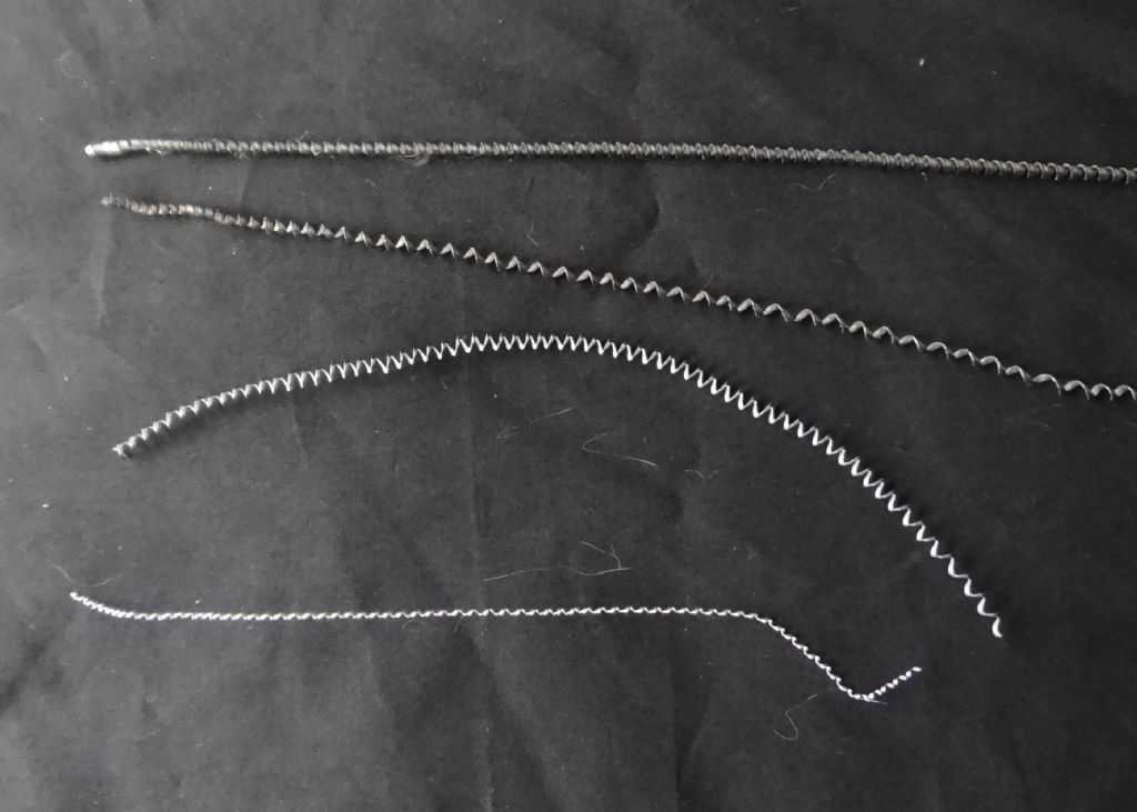

                    This brings to mind the tests I did some time ago, provoked by some photos of gratuitous swarf in the South Bend book. It seems that in those days, a machinist had to aim for giant swarf if he wanted to consider himself a real man in the lathe department.
                    As Andrew says, cranking the feedrate (and surface speed) up is usually the solution when using inserts. The chipbreakers don't tend to work otherwise.
                    Murray

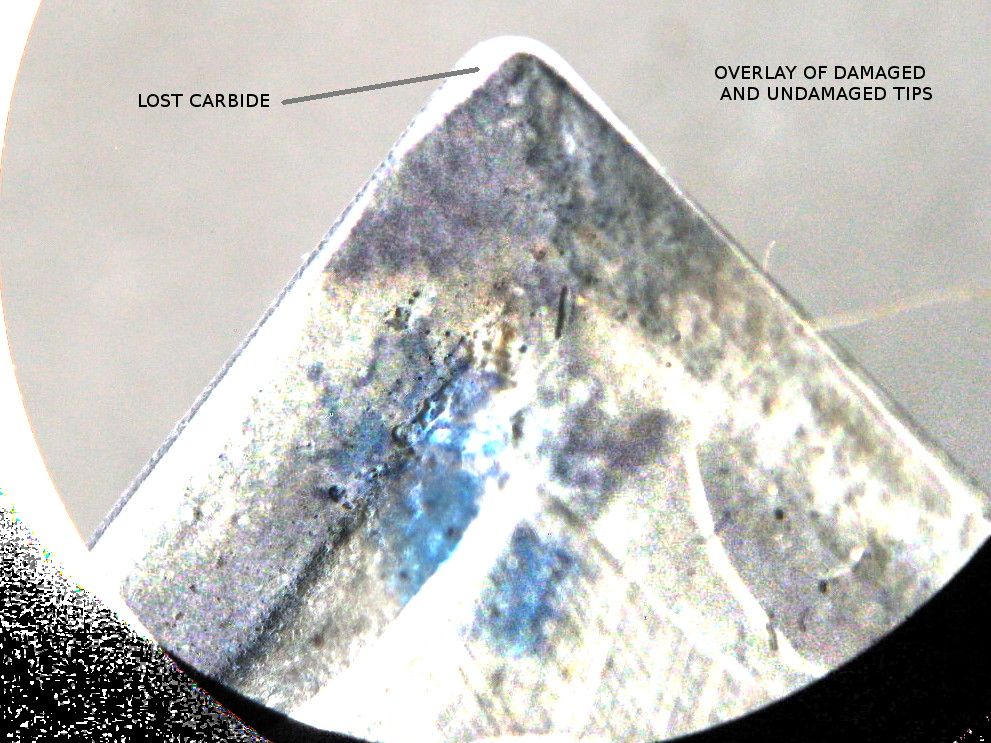

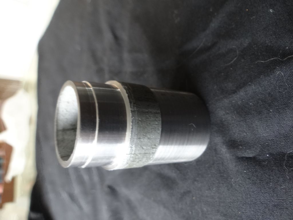

                            I've been playing about this morning and came across another factor.
                            The photo is, I think, 'quite interesting' in that it shows that the state of the carbide insert matters as well as the feed-rate.
                            The test piece is an unknown variety of stainless steel pipe. It doesn't seem to work harden. The top coil of swarf was produced at medium feed-rate with the well-used tip of a triangular insert used mostly on steel. The broken up sample underneath resulted from exactly the same settings (Cut 0.3mm deep at 1200 rpm) except that the insert was rotated in the holder to present a fresh tip.
                            It appears that a blunt tip is more likely to produce ribbons than a sharp one. But how do you tell when a tip used on a variety of metals by an amateur is worn? It's not obvious by eye-balling it.

                              Not being funny but if a tip is worn/blunt you will be able to see some physical difference compared to a new tip. There may also be a build up of metal on the tip itself which could affect performance
                              Tony

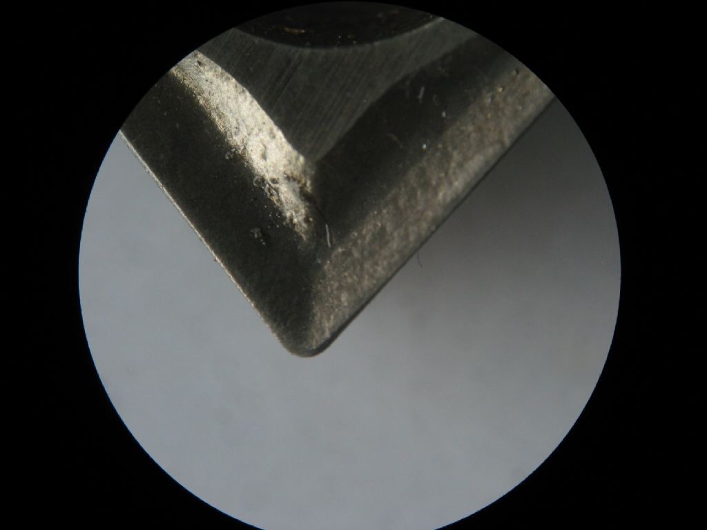

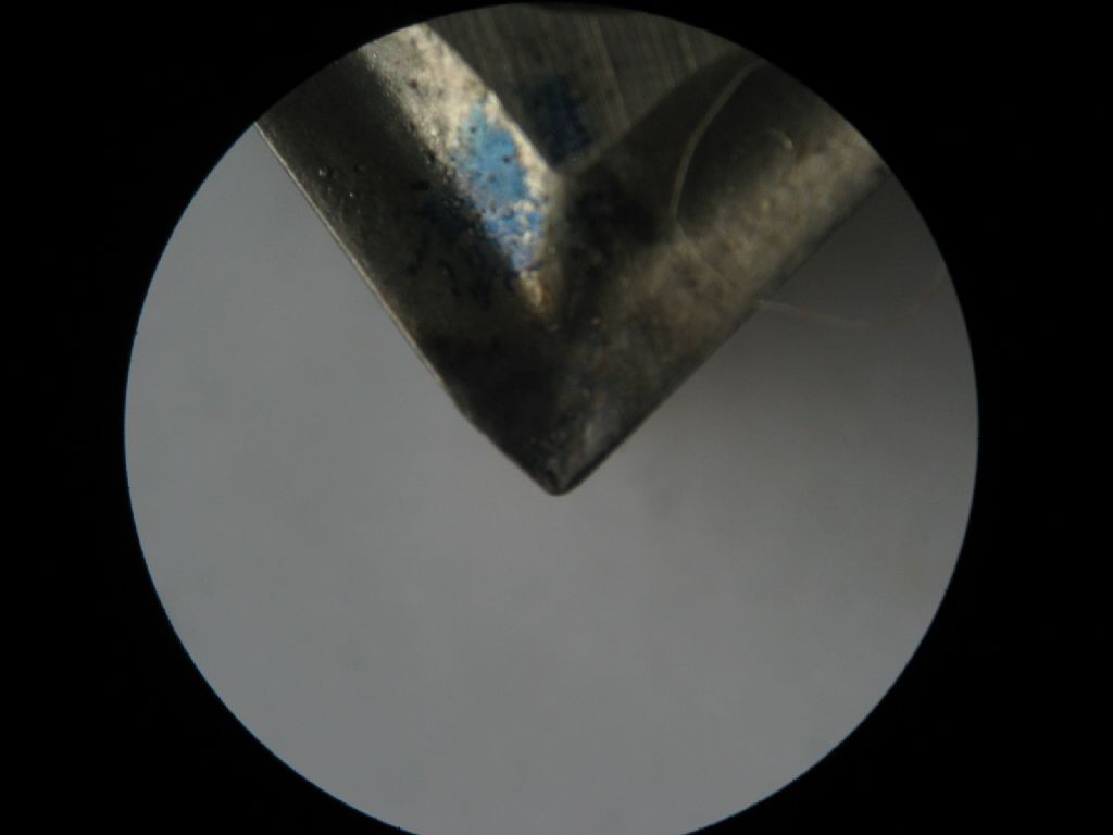

                                    Posted by Tony Pratt 1 on 28/05/2017 11:44:06:
                                    Tony
                                    Yes, it may be my eye-sight. With a loupe I can see damage, and it's even more obvious with a low power microscope.
                                    First undamaged tip with a neat radius:
                                    Second, damaged tip, much more pointy:
                                    Third, an overlay of the two tips digitally tweaked to highlight the difference:
                                    Not sure how I did the damage – might have been me rather than fair wear and tear. Clive mentions rubbing and I did tweak the tool-height to discourage that fairly recently. Or possibly it was rubbing because of the damage. Dunno.

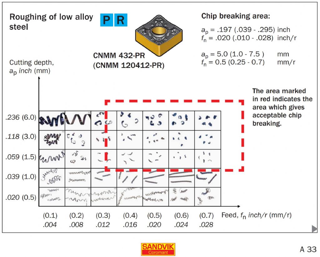

                                      If memory serves me right that seems pretty similar to some of the pictures in my copy of the Sandvik publication "Modern Metal Cutting.". Unfortunately its not the easiest of books to dip into and out of. probably because it was produced as a reference work accompanying an online course. Presumably if you took the course you'd understand where to find what.
                                      Maybe the downloads here :- **LINK** would be useful. Training Guide and Turning Handbook look promising.
                                      A fast skim through the first few pages of the Training Guide pulls up some nice pictures of the speeds and feeds pertaining to the acceptable chip breaking region for, presumably, typical inserts.

                                        Yes, interesting to browse through this kind of material Clive. One section that stands out is the pages around page A33 including this "chip breaking area" illustration. You probably need to get the surface speed right too but this is interesting on its own:
                                        Clearly the actual numbers will be dependent on the type of insert geometry, not least positive or negative insert rake angle. The final rake angle is also a function of the particular geometry at the cutting edge itself which can vary even within a particular family of insert styles.
                                        Murray

                                              The Sandvik manual has a rule of thumb "the depth of cut should be no less than 2/3 of the nose radius". That seems to make sense.
                                              Personally, for roughing I try to turn the speed up to somewhere near the peak power rating of the motor / VFD, to get the inserts working in a region approaching the recommendations. The surface finish tends to be improved as well as the swarf and material removal rate.
