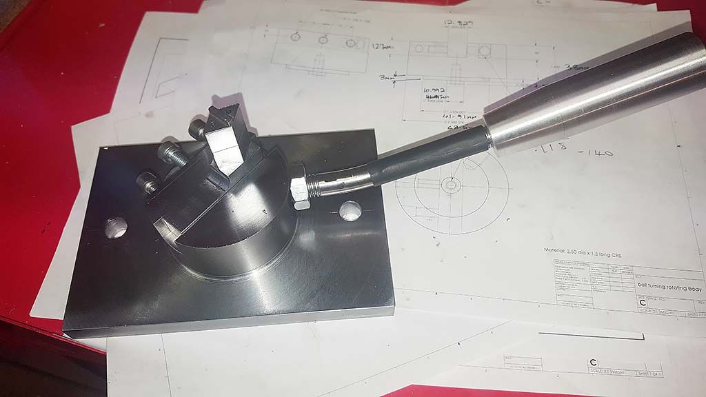

                          Vic
                            @vic
                            This is mine, I chose a slim insert to give good access.
                            Like some others I also put a bearing in the bottom of mine.

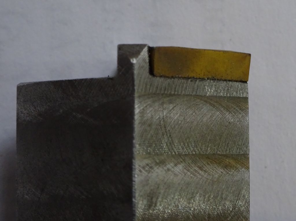

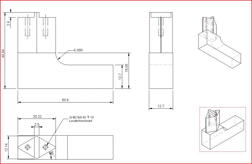

                                      Posted by JasonB on 29/04/2017 07:24:02:
                                      Nicely made and a good video too.
                                      For anyone thinking of making one who can see large concave work in their future then the "post" can be made double sided
                                      Jason can I ask you for some sizes please. Its the top of the tool holder. What size is the piece between the two tools inserts? How much does the insert overhang the tool holder and what size is the thread for holding the tool?
                                      #295630
                                        2.5mm between inserts
                                        The bottom of the insert matches the shape of teh post so it is only the 7degree angle of the insert overhanging
                                        M2.5 thread, best to put an insert into position, locate its ctr and then move 0.1mm towards the central divider and then drill your hole this mill mean the screw pulls the insert tight against the central divider
                                        Drawing, click to make bigger. The 40.64 is OK on my machine but may need adjusting on yours to set the insert on ctr height.

                                            So far so good, have made the tool holder up the point of putting the 4 30deg angles.
                                            Just wondering whats the best way to do this. I was going to mount the work in the vice and then rotate it 30deg but is there a better way?
                                            #295686
                                              From the rather agricultural finish on mine it looks like I did it on its side and angled it 30deg. I actually took the pic earlier to show how little the insert overhangs
                                              I can't quite remember how I machined it but would say your best bet is to do the top first cutting the two lower areas for the insert to sit on then drill and tap the holes. Blue the seat, screw on an insert and then scribe a line along the two edges. You can then machine the angled faces back to the scribed line as it is not ultra critical.
                                              Edited By JasonB on 30/04/2017 19:54:11
