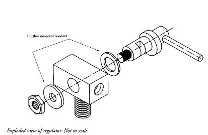

      Anyone know where I can find plans for a steam valve to turn my little engine on and off with?

            Tubal Cain shows one in "Building simple model steam engines" part 1 and Stan Bray likewise in "Making simple model steam engines". Searching for regulator in the magazine indices might be fruitful.

                  Hi Wolfie,
                  The Stan Bray version is quite simple and is a proper regulator. If you would like a copy of the detail drawing PM me. Here is the G.A.

                    Thanks all. I have both of those books, never thought of looking in there. Doh!
                    Found it now.

                      The little taps that I have made have been ones with a tapered plug, with a transverse hole, I'v never drawn one, I just build it. I make a reamer at the same setting as I turn the plug. Ian S C
