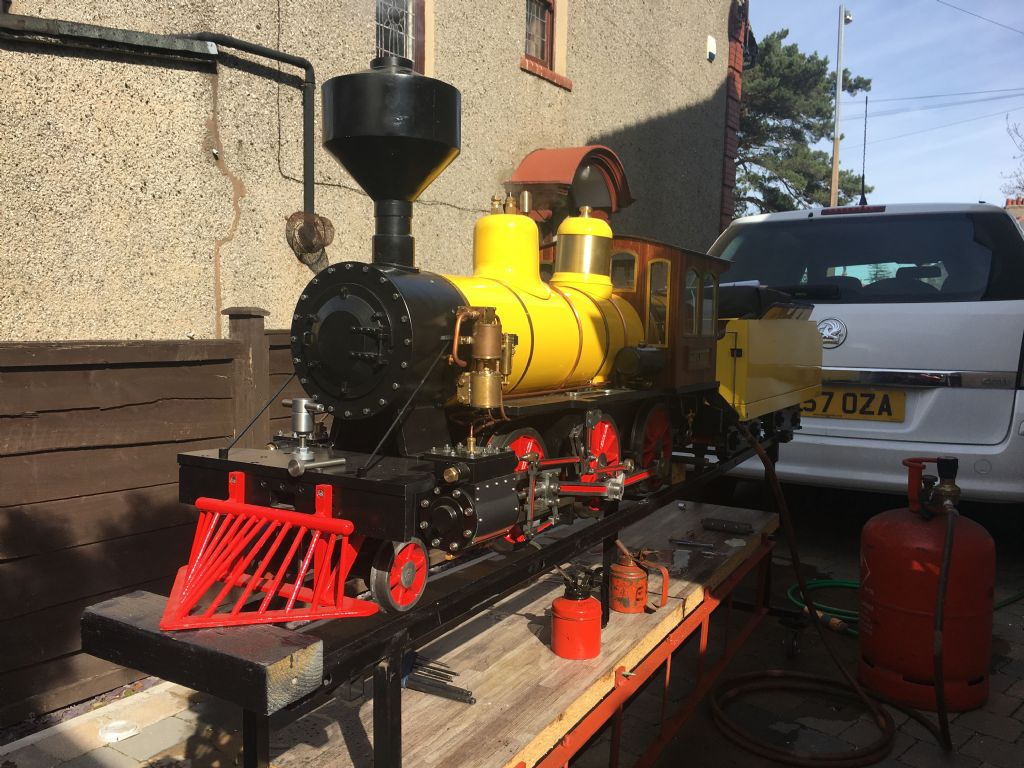

      Hi all,
      I have just made a worthington single type steam water feed pump and it works a treat until it goes under pressure when on the loco.Any ideas what the problem could be?
      Cheers

              No checked the clacks and pipework blockages,Glands were leaking so repacked them ,just need to test again.
              When i tried it last week it would pump twice then stop,wait a minute or two and it would start n stop again,strange.

                The Stuart steam pumps are famous for not working, simply because, as designed, the steam piston covers the drain cock hoes before the end of the stroke, and you get a hydraulic lock. A small groove between the drain hole and the end of the bore, at both ends of course, fixes it. Could yours be doing something like this?
                Maurice

                  julian atkins
                    @julianatkins58923
                    Exactly which drawings /design have you used?
                    It works ok on air with the water side not connected to a pressure valve/pressurised vessel?
                    It works ok on steam with the water side as above?
                    It doesnt work on steam when water side connected to the loco boiler?
                    Where is the pump situated on the loco, and how long is the steam pipe to same and from where on the loco?
                    What is the bore of the steam side cylinder compared to the bore of water side cylinder?
                    What does the steam exhaust look like when running on steam on the loco?
                    Cheers,
                    Julian
                    #291266
                    Deltic007
                      @deltic007
                      Hi Julian,
                      Drawings were from Allen models in the US
                      No idea if it works with the water side disconnected and connected to pressure vessel(Good point and would answer your next question).
                      IT does work under steam all connected but only pumps a couple of times stops and after a minute restarts only to stop and the cycle goes on.
                      Pump is at the front of the loco about 14" from the steam valve
                      Steam cylinder bore is 1" water is 5/8
                      Cannot see the exhaust as it is piped into the smokebox.
                      Hope this helps and thanks for taking time to help me.

                              julian atkins
                                @julianatkins58923
                                If the steam supply were taken off the turret/manifold then fed through a hollow stay through the boiler to the smokebox then to the pump, I think you would find the pump will work. This, of course, wont be possible with a boiler without a spare hollow longitudinal stay, though you could swap the blower feed for same if it goes through a longitudinal hollow stay. The blower could be run off the manifold outside the boiler though you will get water up the chimney when first turned on.
                                The 14" long steam supply to the pump outside will definitely cause the steam side of the pump to be water logged due to condensation. This is the cause of the problem commented upon by others previously.
                                I doubt if lagging the steam supply pipe will help.
                                Cheers,
                                Julian
