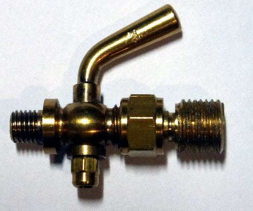

                      For using a tyre inflator, I made a two-part Schrader adaptor for a Stuart union cock:
                      union-cock1
                      The Schrader thread is 32tpi, which extremely close to 0.8mm pitch.

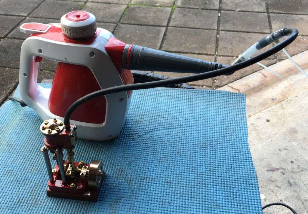

                        This is a link to my previous post on ME showing my engine running on a steam cleaner. Not sure how much pressure they generate but according to specs on Google. 3-5 bar (40-70 psi) but not much volume of steam.
                        https://www.model-engineer.co.uk/forums/topic/reversible-marine-engine/
                        Steam cleaner

                          That one of Paul Lousik’s will be ideal for what I need, a quick and easy source of steam to check joints etc. Thanks Paul.
