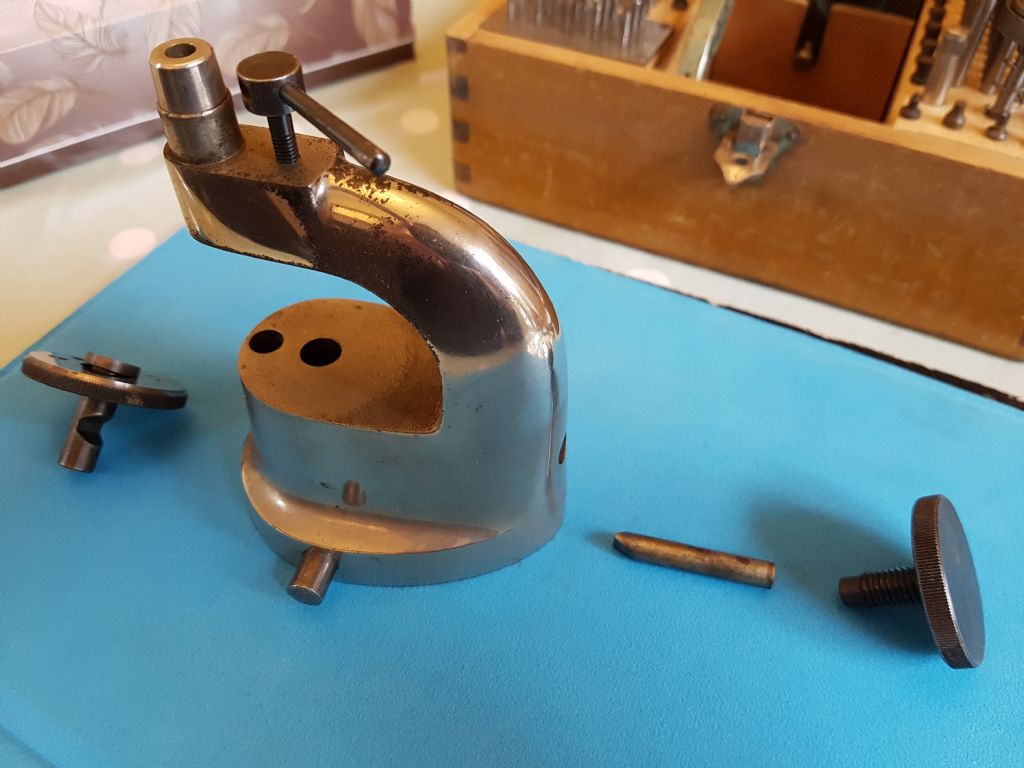

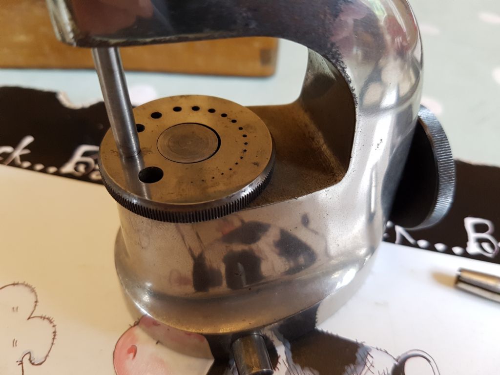

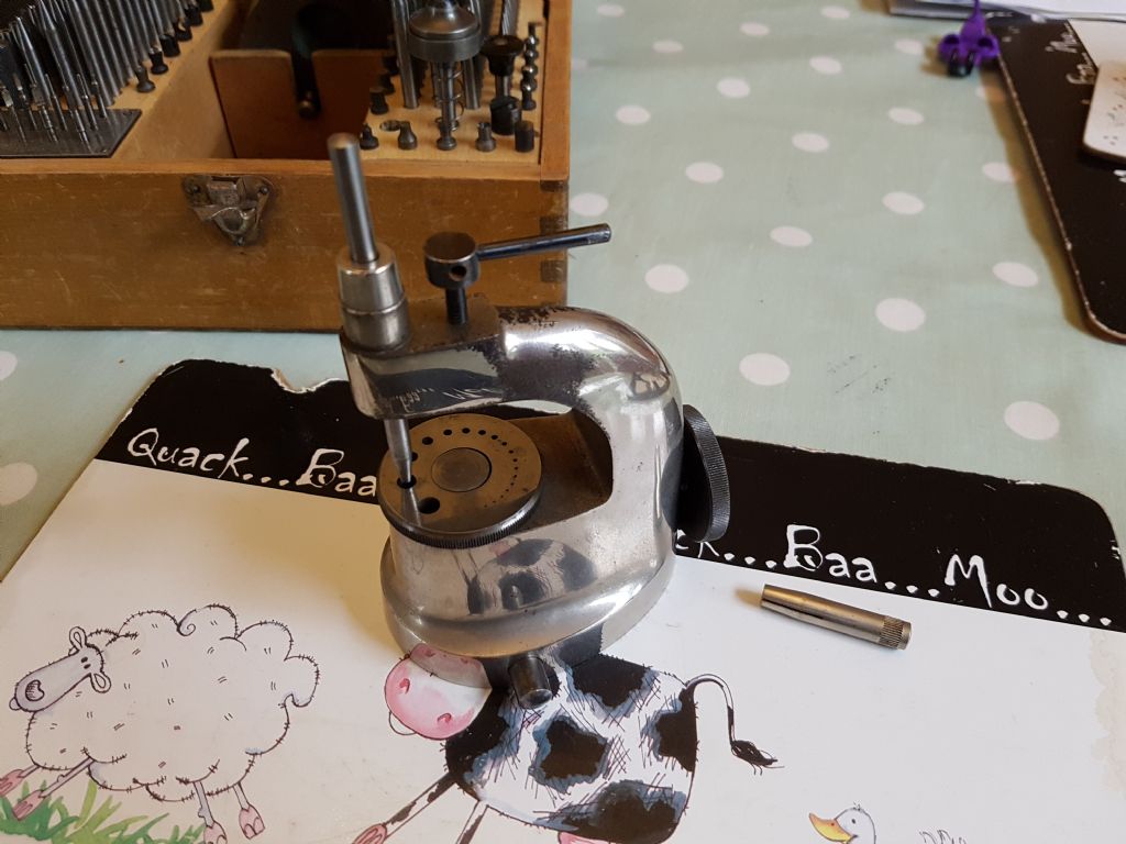

                    The float is (hopefully) intentional in order to ensure the anvil/hole is perfectly concentric with the stake. My staking tool has a threaded wheel at the back which may be tightened to lock the table in position. I've uploaded a couple of pictures to my album showing how the table is locked in position by a pin with a flat taper which engages with a notch in the table locking shaft. Hopefully the pictures are better than my pathetic description!
                    Step 1 : Unlock the table
                    Assembled Tool
                    Step 2 : Select the require hole and align with the stake using a tapered stake by lightly pressing it into the hole. I think there is normally a stake set aside just for this operation.
                    Aligning the table using a tapered stake
                    Step 3 : Lock the table in place and remove the aligning stake.
                    You are now ready to use the tool
                    Exploded Table assembly

                        Jimmeh, thanks for the photographs. Your staking tool looks great in chrome finish! Far better than my pea green crackle paint! Seriously I can see that your rotating table has a larger counter bore than the diameter of the shaft head, so it can move around in the same way as mine. The locking arrangement for the shaft is similar in concept to mine. But here is the rub, when I lock my shaft, the table is still free to move, which isn't the way your tool works!
                        It would appear from the photos that the position of the hole that takes the staking tool is fixed and the tool's position cannot be adjusted in any way. Whereas my version goes into a shaft housing that is eccentric and this enables it to move radially.
                        Maybe for some odd reason I have both means of adjusting the stake position relative to the "anvil" holes. But not being able to lock the table position is a touch worrying.

                          Oh Dear, embarrassed again! I have retried the locking of the shaft via the large screw. This time I found that it does clamp the table. My apologies for the false information. The pointed locking shaft could not have been entering the large dimple on the main shaft, on the previous time that I tried it!
                          So I have two alignment methods, the first being the movable table and the second being the eccentric bush that hold the tools! So why are there two methods of alignment?
