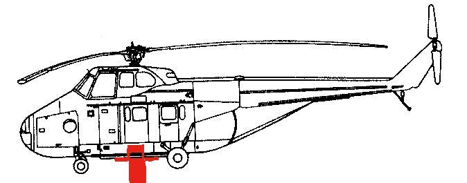

        With the house rebuild nearing completion, I've decided to make a custom windvane. The 'vane' is a profile model of my old favourite the S&R Whirlwind 10. I've cut it out of an off-cut of dense foam facia 'boarding' and now need to make a bearing mount. Obvious material is stainless for salt resistance and I reckon that a piece of tubing could have two saw-cuts at right angles to each other and two opposite 'leaves' bent through 90 degs to attach to the underside and the other two support the body vertically. I can obtain a short length of 16mm od tube with 12 mm internal diameter … Can anyone see any obvious problems, please?
        rgds
        Bill

          It will probably work better if you fit a center drilled pad at the top of the tube and a point at the top of the rod, make the rod a free fit in the tube and grease well.

              daveb – thank you for your suggestion. I'm afraid that my remaining 80 year old brain cell can't quite visualise the set upblush I see my main problem as being the material and its relative narrowness with no obvious method of attaching a support spindle. Thank you also, Julian for your advice and very kind offer. Again, the insubstantial nature of the material makes it difficult to attach to the main support spindle. I suspect that I shall have to resort to Gorilla glue and something like my original idea. Once I can devise an attachment of some sort, the main mounting can be traditional.
              To 'look the part', it will need to be painted in Rescue Yellow (?) but I have no idea if it is possible to apply paint to this type of fascia cladding and if so, what type would suitindecision … such a simple idea, I thought!sad

                For the bearing just put a suitable size of ball in the tube and a dollop of grease, will last for years.
