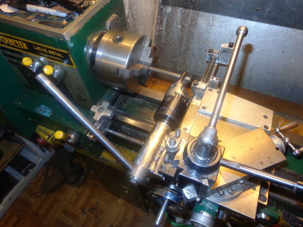

                Sam Stones
                  @samstones42903
                  Vic,
                  FWIW – I have a faint idea that this one was described in Model Engineer many years ago, perhaps in the 60's. A round cutter (e.g. a piece of broken drill bit) is inserted into the left hand end and pokes out as per the illustrations in the links above.
                  Other than making a couple of stainless steel handles (for a six-way turret and a rear tool post, oh and an aluminium ball on the end of the handle which I carelessly cropped off in the photograph), I hardly ever used it.
                  Capacity? About 50 mm max.
                  One extravagance was the bronze body, a left-over from another job.
                  The bronze body was made to be clamped in the normal (ML7) tool post.
                  I seem to recall making the lead screw with a 40 tpi thread. It allowed very fine adjustment.
                  Cheers,
                  Sam smile d

                      Sam,
                      It looks like an earlier version of the ball turners that use a boring head. (Possibly where the designer got the idea)

                      Sam Stones
                        @samstones42903
                        Yes Paul, very similar.
                        As my memory mist clears slightly, I feel sure it was described with drawings in ME. That would have to be pre '72.
                        When I made it I'm not sure. Late 60's or early 70's. It went out with my ML7 and most other stuff in '07.
