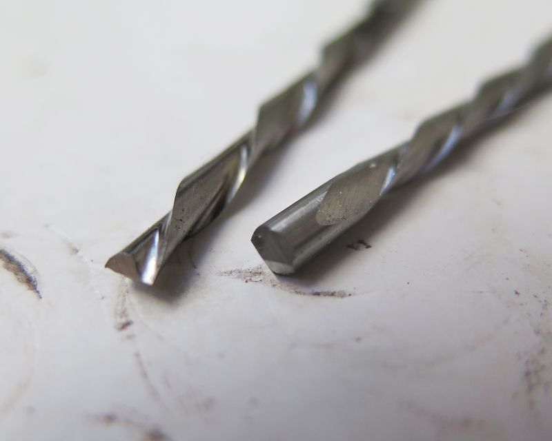

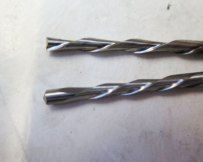

      A good while ago I purchased a couple of 3.3mm drills from Axminster. Today I was doing some tidying and took them out of the packet. ……………. Oh.!! surprise
      Not good at all eh.?
      But what I find most unusual is that obviously they are from the same batch but both with different faults.
      Nick

          They look more like Downward Spiral router cutters, used so that the surface is not damaged by the cutter, the reverse spiral pushes the surface finish down onto the substrate as the cut is made.
          Edited By JasonB on 07/05/2017 20:36:32
