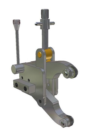

      I'm sure this is a beginner's question: I've been making the Hemingway Sensitive Knurling Tool, as in the picture below:
      As a rookie engineer, I made several mistakes in the making, mainly during the use of the Myford Super 7 for the milling operations. Specifically, I machined the side plate step 20thou too deep. This surface of this milled step is 2" x 7/8". My question is, rather than scrap the part and re-make it, can I 'add' a piece 20thou thick to this surface in some way?
      I also wondered whether anyone had any other tips for solving common engineering mistakes, at least for non-critical parts that aren't under any strain.

        John Hinkley
          @johnhinkley26699
          Mike,
          If I have understood your predicament correctly, instead of "adding thickness" to the side plates, I would personally remake the mating pieces in thicker material to 20 thou thicker. They look to be the easier to construct and from less expensive stock.
          Is the fact that there is extra clearance that critical? Depending on the construction, a large brass, or similar, washer might take up the "slack"?
          There's more than one way to skin a cat. I have no doubt others will come along soon with more ideas.

            Brian G
              @briang
              I don't know the component, but wonder if you can take the same amount off of the rest of the same component? From the picture I would guess it to be at least 3/8" thick, so at most there would only be a 5% reduction in stiffness.

              Mike Donnerstag
                @mikedonnerstag
                One idea was to sweat a thin piece of mild steel onto the piece using silver solder, or perhaps even 'glue' a piece on using loctite? I assume that 20thou isn't a thick enough piece to hold in place using any kind of countersunk screw. Ideally, the solution would not show on the outside of the tool.
                John: The knurling tool seems to work okay, traversing in both directions without excessive play in the arms, so you may well be right that I can leave it 'as is'. As the tool is near to being finished, it's too late to change the dimensions of any other pieces. If I were to use a brass washer or thin sheet, how should I fix it to the component?

                  Speedy Builder5
                    @speedybuilder5
                    Superglue a "shim" of metal to the inside face?
                    #420373
                    Mick B1
                      @mickb1
                      Fixing your errors in a sound and practical manner is one of the things engineering is about.
                      Everybody makes them, but not everybody owns up.
                      If the side plate step is where I think it is, some sort of shim 20 thou thick should work, but you need a way to stop it slipping out. I think I'd try drilling and tapping a couple of (say) 5 BA or M3-ish holes through both sideplate and shim and put screws or studs in to anchor it. Don't think you can have them protruding on the inside, so you'll need an exact length and Loctite 271 or suchlike would probably help. Whether you can remove invisibly or otherwise disguise the outer ends, countersink, or just leave them visible, is largely an aesthetic/social decision.

                      Enough!
                        @enough
                        Posted by Mick B1 on 22/07/2019 16:55:12:
                        Am I misunderstanding this? Is this feasible with a 20 thou shim?
                        What you (he) might be able to do though is to drill and tap say, four places. Insert and loctite screws then mill down the heads of the screws to 20 thou thickness and treat that as the shim.
                        (If it were me, I'd remake the easiest part as John Hinkley said).

                          AdrianR
                            @adrianr18614
                            If you want it perfect, remake the side. Adding shims will always remind you of your mistake. I would mill the rest of it down by 0.02" so the step returns to the correct size. I would probably do the same to the other side piece to make it symmetrical.
                            I really doubt 20 thou will be a strength problem for a knurling tool, but if it is you can always remake the part later.

                                  Mike Donnerstag
                                    @mikedonnerstag
                                    I knew you fellas wouldn't let me down!
                                    AdrianR: Why didn't I think about reducing the overall thickness of the side piece, and thereby reducing the over-milled step? That's exactly what I'm going to do, so many thanks! That way I'm not affecting any of the other (correctly sized) components. If anything goes wrong, I'll just re-make that side piece. (Did I say 'just'??)
                                    The side piece that is a close fit supports the knurling tool when it traverses towards the headstock, it's only when it traverses towards the tailstock that it is not so well supported, due to the over-milled side piece.
