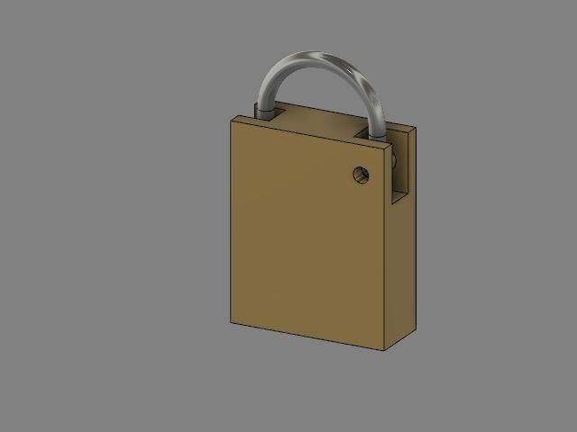

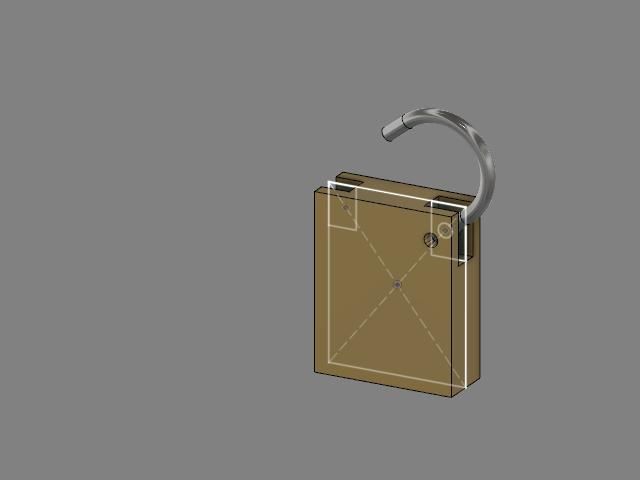

here is your lock:
the hoop and two sketches to create it
and with the joint open plus the single sketch for the body created by two simple extrusions
Finishes are stock brass and stainless steel materials, and Fusion suggests it will weigh 261g
I spent more time saving and uploading the JPEGs than I did creating the model….

I did see the white source outlines and realise their meaning, yes.
