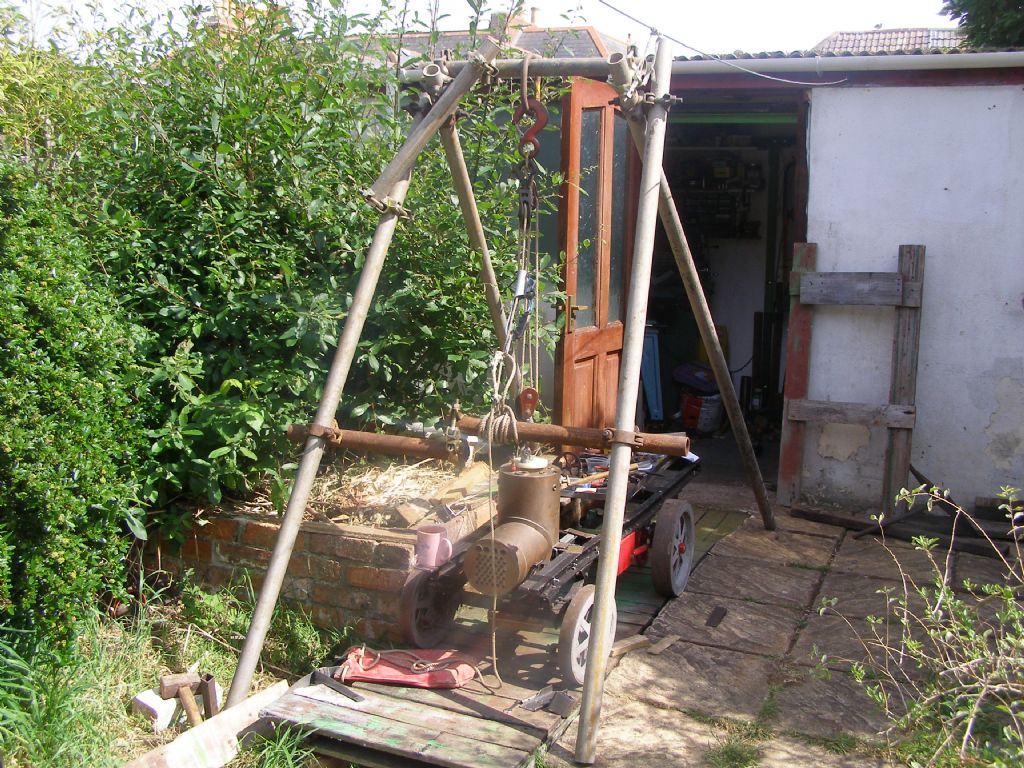

                                          The drawing below is probably the last isometric CAD attempt I have made so far, and many months ago.
                                          It is a general view of the 4" scale steam-wagon I have been taking far too long to make. There are no drawings for it, just a few old advertising photographs from 1908. This drawing reached my CAD skill limit, but despite parts removed, the construction stage is roughly that of the photo below it.
                                          I took that when trying to design the boiler-mountings I made eventually to a rough pencil sketch and bits of steel clamped to the chassis. The red bit in the photo is tentatively the outer plate for the transmission assembly.
                                          The drawing's two floating bits are a bunker and its floor, extended as the footplate. I took many attempts to draw that sub-assembly as neither a solid block (nowhere for the coal) nor lacking a floor (chassis rail visible in plan, the coal landing on the ground).
                                          The brown cylinder is the firebox, the boiler shell being a T-piece standing on its side. The wheel discs are not really solid but pairs of rose-pierced plates. The yellow block represents the water-tank (brass). The rear axle is correct by dimension but looks too far forwards. The disc behind the wheel is the differential, converted from a car unit to traction-engine pattern with through and cannon shafts, and fitted with chain sprocket
                                          I could have added the seats (two rectangular boxes) and symbolised the engine (another box, between the seats and behind the boiler). Detailing the wheels, adding the Ackermann steering-gear, springs etc – out of the question. All that lot is nearly as far as the vehicle itself has progressed.
                                          This drawing conveys far less than a photograph of the made parts. As a TurboCAD 3D model – merely an exercise; scrappy, unfinished, best deleted. As a design drawing – dimensionally right but useless. Its only value is as a self-assessment of ability.
                                          Experimenting though, I was surprised to find that TurboCAD will dimension a scanned photograph – but 2D only so useable only on planes perpendicular to the view. Nevertheless I used this to obtain some approximate dimensions for the engine-case.
