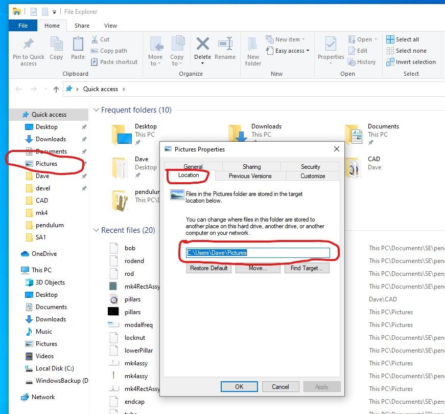

                  Having slept on it, I decided "it can't be that difficult", so here I am on Windows 10. Quite often file management stuff can be accessed using File Explorer to open a file's Properties, so I tried that first. Bingo, but it requires several steps and you may not feel it's worth the effort!
                  Open File Explorer:
                  Go to the Pictures folder (left ringed in red), and right click it. At the bottom of the pop-up list, left-click Properties, which will open the Pictures Properties dialogue. Left-click the 'Location' tab (red-ringed), and note what's is the lower text-box, also ringed in red. My computer is set to "C:UsersDavePictures", your's – if I'm on the right track – will be something like "D:UsersZanPictures".
                  If it is, IMPORTANT, take a backup copy of whatever is in the D: folder. Then delete the contents of the D:folder/
                  Back on the location screen, change the folder to "C:UsersZanPictures" and click the move button. This will move (transfer) the contents of the D:Pictures folders, to C: Won't take long because the D: folder is empty. After the move has finished, the C: folder is no longer redirected. Now install SE. Fingers crossed, now Pictures is just an ordinary folder, not redirected, SE will load.
                  Last step is to go back to the File Properties Location tab and redirect c: Pictures back to the D: drive, and then to finish off by restoring the backup taken earlier.

                            If Zan checks the Location as described above, it will show whether or not his Picture folder is redirected. If it is , then redirection is still a suspect. If not redirected, then I'm wrong and the other possibilities step forward. But I'm not keen to look for registry or previous install errors until redirection is definitely off the table.
