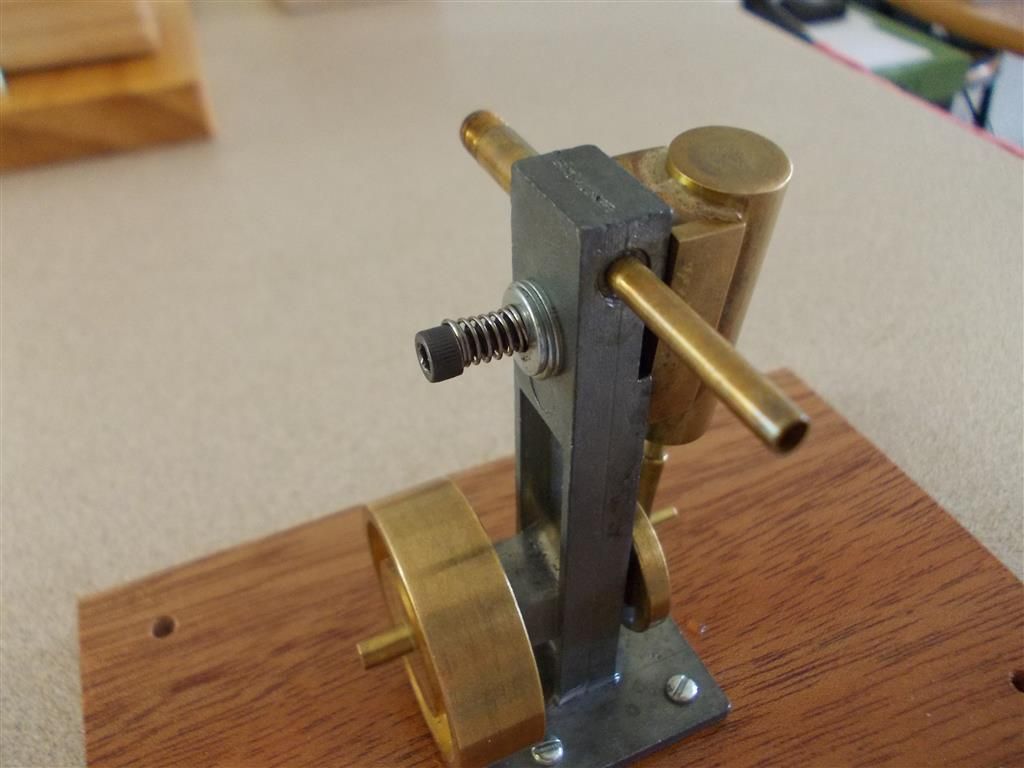

          I have got the little wobbler engine running nicely on air. It is a nice tight fit of the piston in the cylinder (it makes a pop sound when you pull it out by hand) and the cylinder spacer sits closely against the main frame. But when I run it on steam it only runs for about 45 seconds and then it runs out of steam….literally ! I am not sure what else can be done here other than to increase the heat source and hence produce more steam.

            The tablets produce a flame over a wider area so the bottom of the boiler will get heated, your small dia burner probably looses a lot up the flue.
            Try restricting the amount of steam that can get to the wobbler, pinching the silicon tube will do for a try, it will act like a regulator as not let all the steam rush through the engine so it should run for longer but at a slower speed. If that works you can think about adding a valve to regulate the flow.

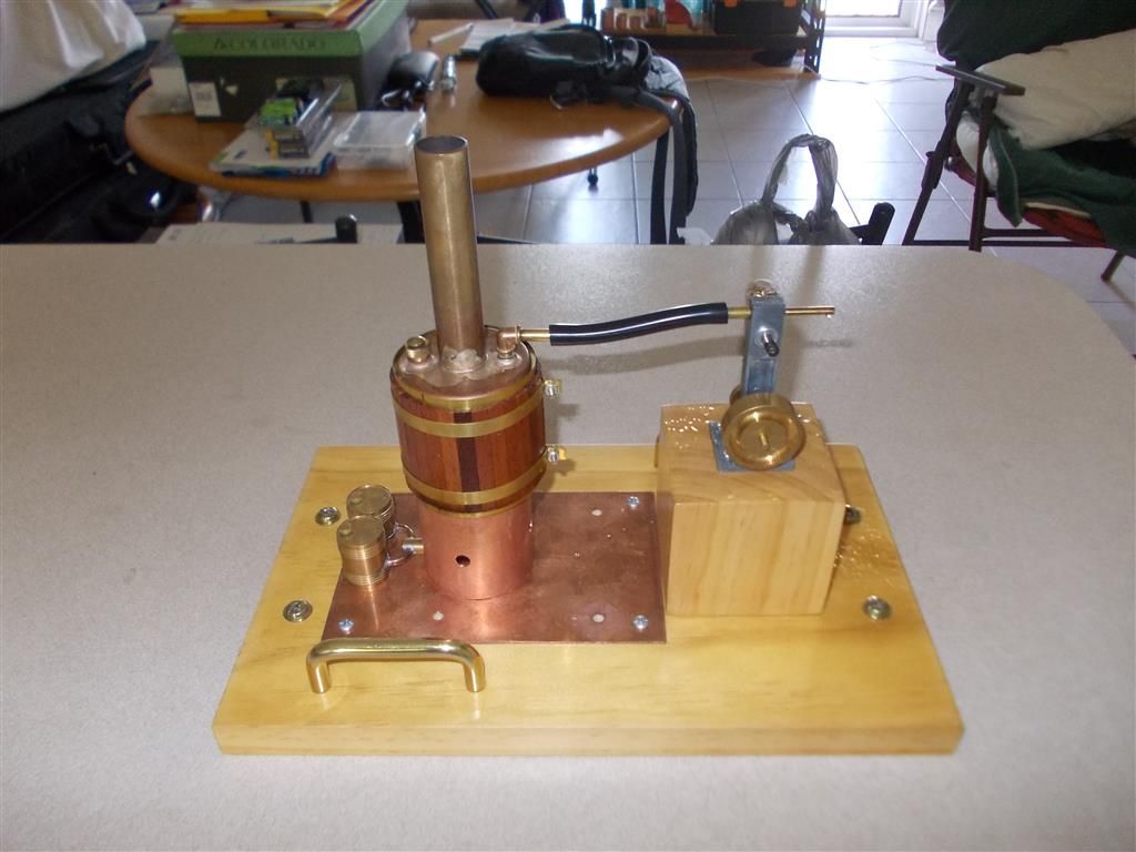

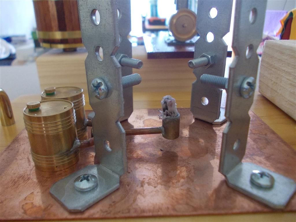

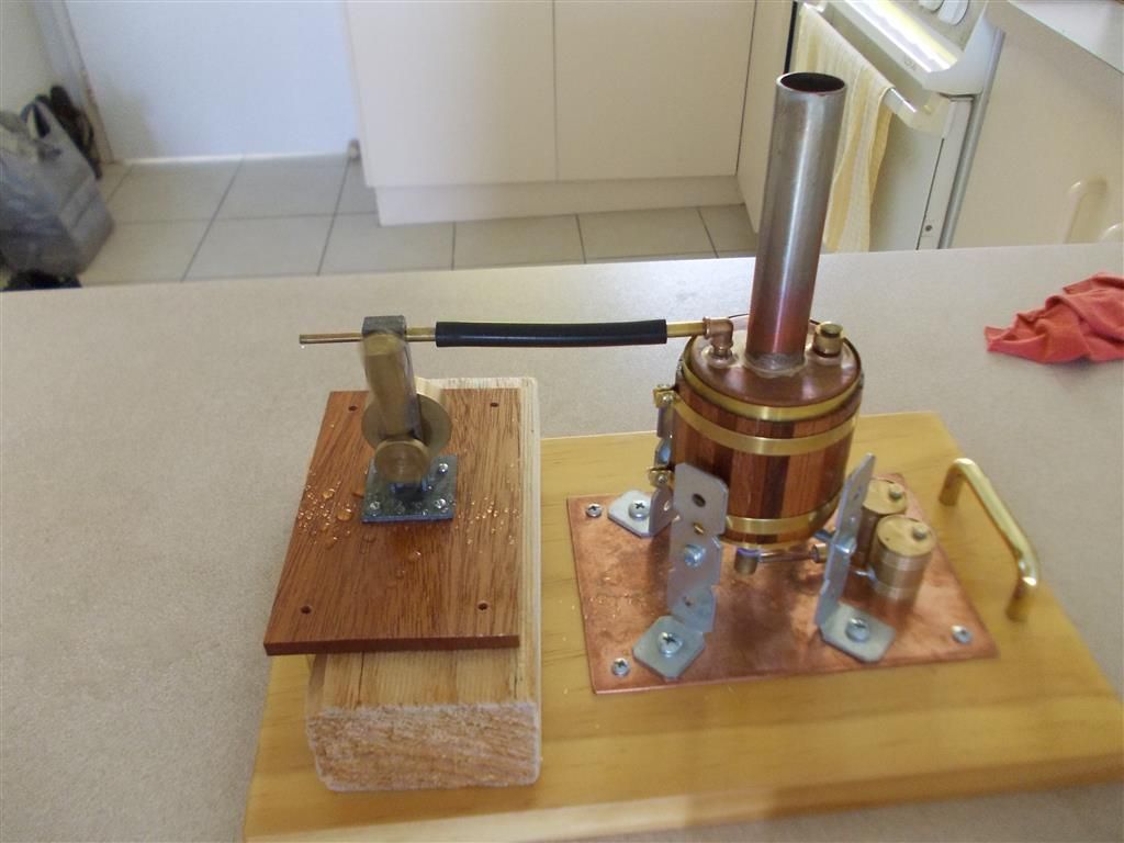

              I have made some adjustments and the engine runs successfully on one complete burn of the spirit burner. This only uses about 1/4 of the water in the boiler so I still need a bigger burner with a longer run time :

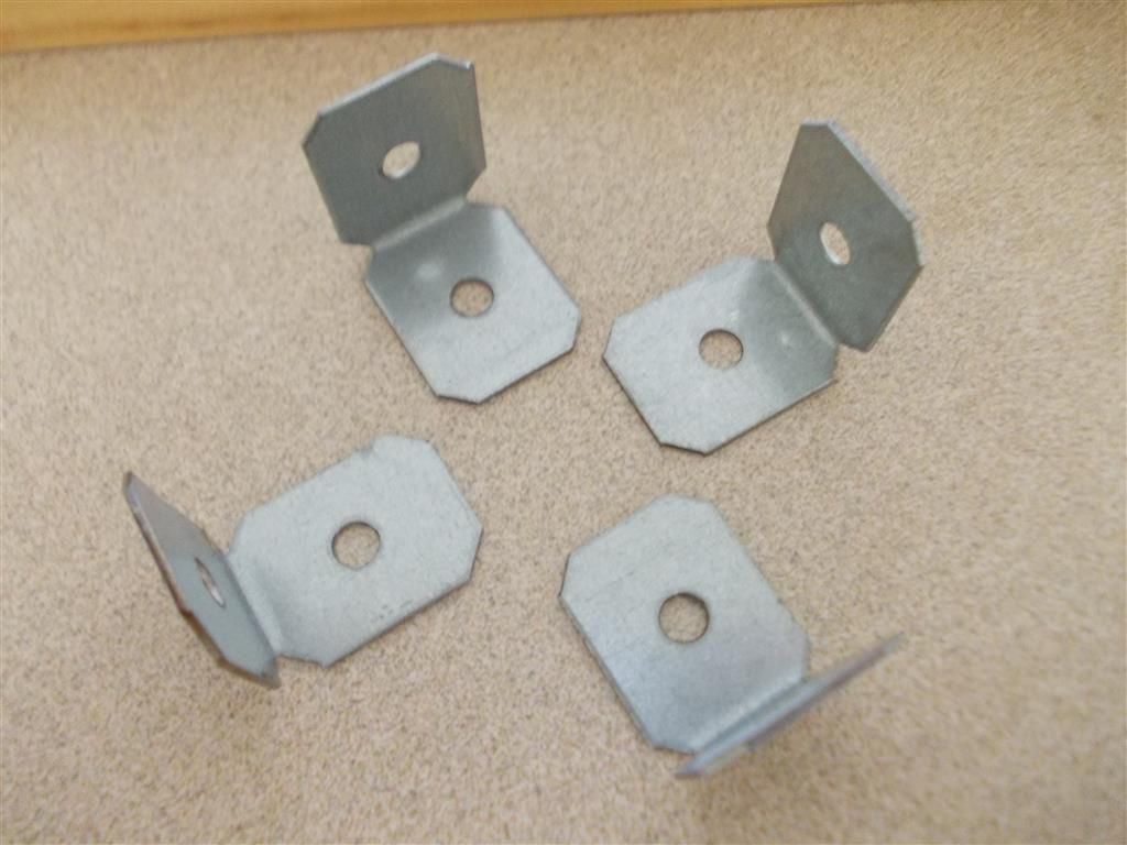

              First I changed the the angle plates that the boiler was sitting on and used 20mm M5 screws instead as I did not think the heat was getting to the bottom of the boiler efficiently. Photo 1 shows what I used initially and photo 2 shows what I replaced it with.
              I did try putting a clamp over the silicone tubing but that did not make much difference. I noticed that there was quite a bit of water forming around the top of the cylinder spacer where it meets the main frame so I tightened it up by adding an extra washer as per photo 3.
              This did the trick and it runs like the clappers as in photo 4. I am building a small plinth for the engine to sit on but it still requires a few coats of clear polyurethane. I may also raise the boiler a bit higher to the next set of holes as I think it may be sitting too low and too close to the flame.
              I do not like the way the top of the boiler ''ripples'' as it cools. The copper is only.38mm thick and was designed to be soft soldered. I hard soldered it and the extra heat may have made it soft…too soft ? I do not know but I wear full face protection when I am running it. I will build another boiler of the same design but the copper will be 1.8mm thick and should be much safer. I am also not sure about using wooden lagging. It looks great but it does char a bit around the bottom edges and may be more trouble than it is worth. Those boiler bands have to be very tight !

                Brian if your wood is charing then you are probably loosing a lot of the flame and therefore heat around the outside of teh boiler. With the original tubular base the heat would have nowhere else to go but the base of teh boiler then up the flue which are all heating area.
                Regarding the rippling of the boiler. when the remaining water/steam cools it will create a vacuum within the boiler, try and have somewhere open so the vacuum won't form

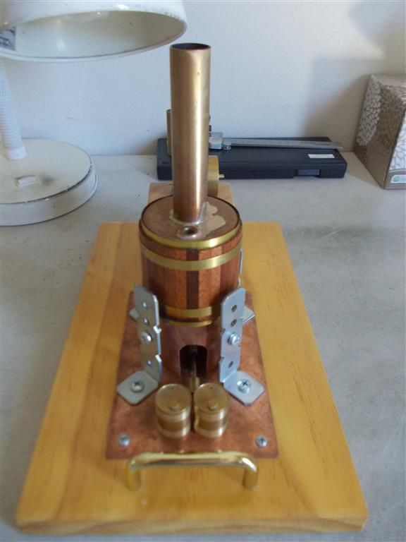

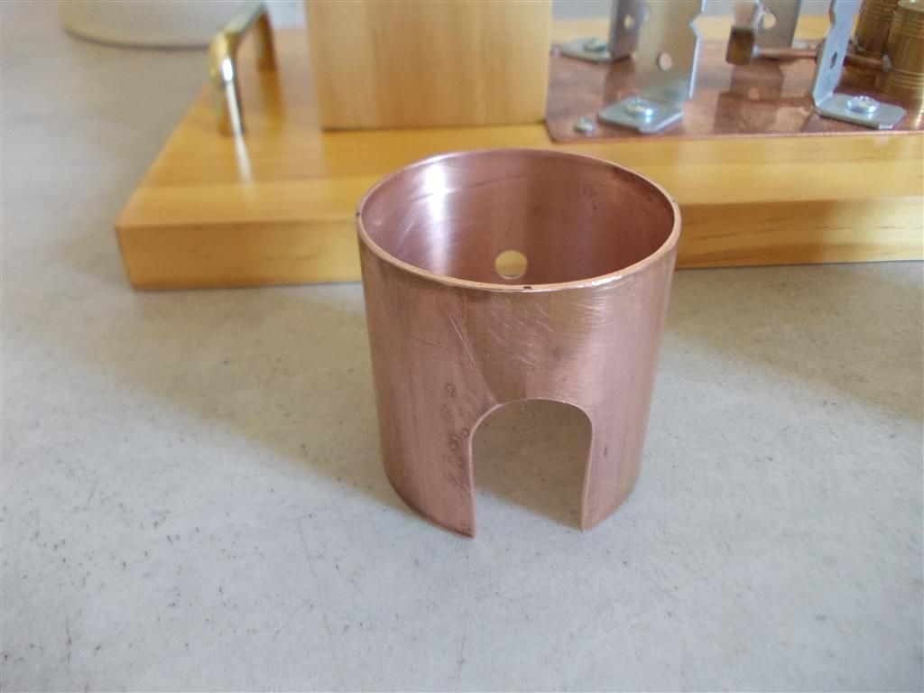

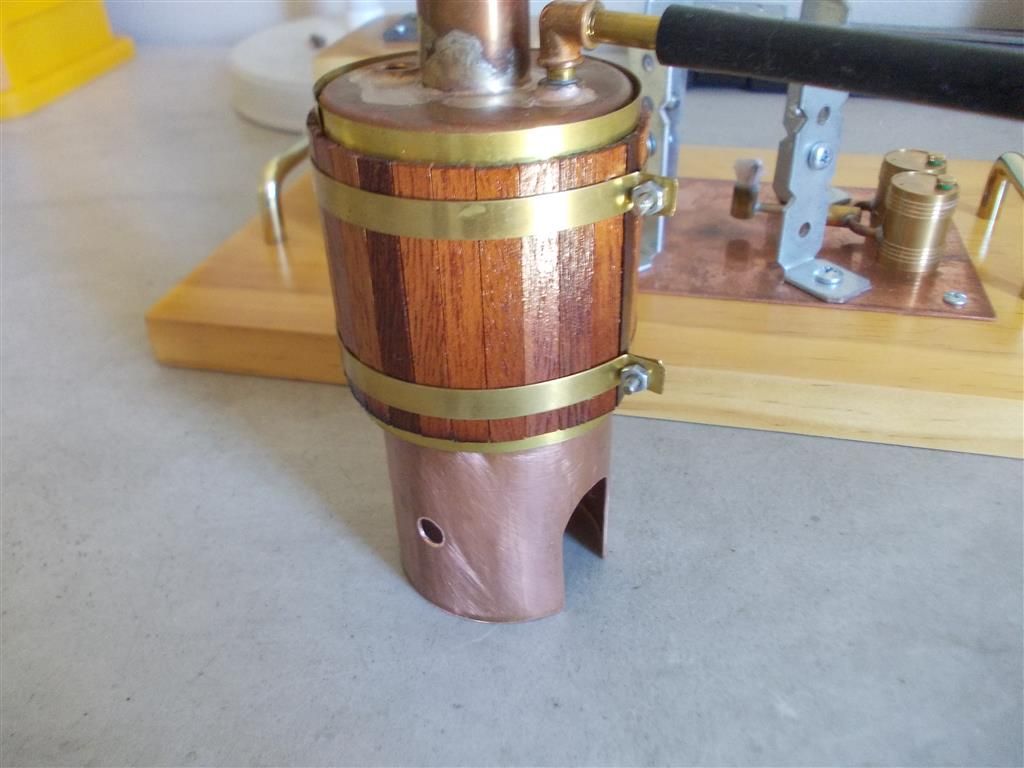

                            I have constructed a firebox out of 50mm copper tube…scrap yards are wonderful places ! I was going to just sit the boiler on top of the firebox as per the photos. Should I silver solder the firebox to the base of the boiler ? The aim is to prevent heat escaping around the base of the boiler and singeing the wooden lagging.

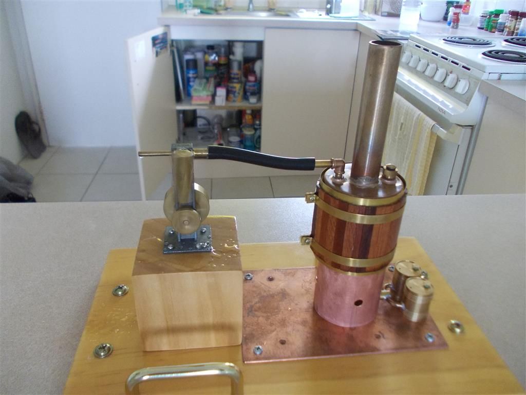

                              I reckon you've made a really good job there BJ, but I think the support brackets make it a bit clumsy looking, Are they permanent or do you have some cunning plans in mind.?
                              Mind you, once you have the boiler attached to the firebox you shouldn't need those brackets.
                              I would have thought that the firebox could literally be soft soldered to the boiler, it will be easier than trying to get the whole thing hot enough again and risk running an already made joint, and as the soft solder would be in contact with a 'water cooled' surface its unlikely to come apart with just a spirit burner flame.

                                1. Before the addition of the firebox the boiler was to sit on bolts passing through the brackets. The holes at various heights on the brackets allowed me to raise and lower the boiler above the flame. The brackets are probably not needed now. Yes, I think they are ugly too but they do prevent the boiler from toppling over.
                                2. I do not have much luck with soft soldering ; I do not know what I am doing wrong. I find silver soldering much easier !

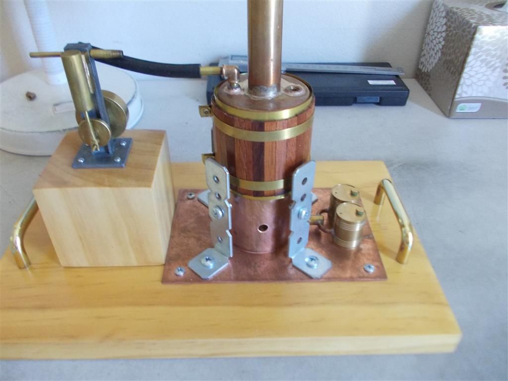

                                  Here it is running with the firebox which improves efficiency greatly. I will have to solder it to the boiler but I am still deciding whether to hard or soft solder it. The brackets had to be removed as they were not holding things as intended. I put a lot of work into those brackets !
                                  I had to shift the brass handles as they interfered with the placement of the spirit burner….something to remember next time. The wooden mounting block for the engine should also be about 10mm lower.
                                  I do not have any power tools for cutting timber. I was thinking of buying a jig saw and using a 100mm blade to cut this piece of 70mm X 70mm pine but some people have suggested that the blade will flex and I will not get a straight cut. What is the best way to remove 10mm from this mounting block ?
