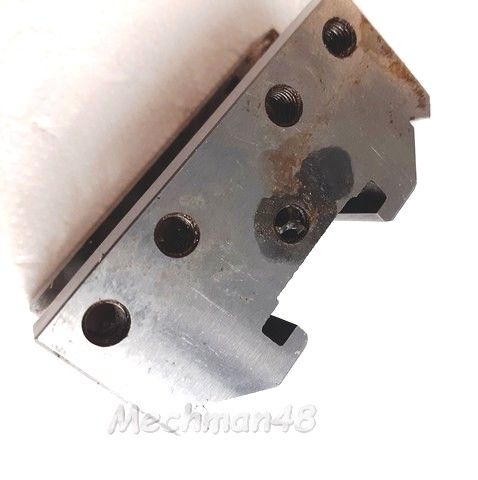

                                #540866
                                mechman48
                                  @mechman48
                                  Posted by peak4 on 02/04/2016 11:34:28:
                                  Posted by Michael Walters on 02/04/2016 11:09:18:
                                  Posted by john duffus 1 on 02/04/2016 00:50:51:
                                  I see lots here about how to use taps but as far as I can see nothing about removing taps that are broken in a job. Years ago in M.E. there was a mention in a letter that one should try ALUM. I was presented with a job with a broken 4BA HSS tap & submerged the offending part in a saturated solution of ALUM- bit of heat now & then & bingo- the tap more or less crumbled to a black dust after about 3 days. Give it time & a bit of heat- it works. The job was in mild steel & had no more than a grey finish on it. I was told by a chemist who used the same pub that there was likely something like a nickel-iron cell formed- if memory serves!
                                  That sounds very interesting, John, i'd like to know where you could buy that if you don't mind me asking?
                                  I've tapped a few holes since writing this and i'm pretty sure it was because the starter drill i was using was 0.1mm too small, doesnt sound much but makes a bit of a difference.
                                  Michael W
                                  Here You Go, alternatively try your local Indian/Asian supermarket for Fatakdi powder.
                                  Having a loose adjustment screw on one of my Dickson tool holders I decided to clean out the thread & tap a deeper thread, I used a set of 5 mm HSS taps to start the process as there only seemed to be aprrox 3 threads of engagement so tapping deeper was a logical progression.
                                  I only managed to get a turn on the 2nd tap when guess what ! yeah there is a broken tap in the hole, admittedly it''s not the first time I've broken a tap but it's annoying when its an expensive HSS one. I poured a few drops of some citric acid pickling solution into the hole & left it overnight, this morning it looks as though there is some reaction with the tap as it has started turning black, question is; has any one used this method of removing broken taps?. I don't have access to an EDM machine nor have the right size solid carbide drill ( expensive ).
                                  Having looked back through previous posts I came upon the above article describing the use of Alum so have ordered a sachet ( 100 gms ) via link & will try that, so the next questions are..
                                  What ration of alum powder to water is best ?.
                                  How often does it need to be heated ?
                                  Has /does Citric acid work as well ?
                                  Any other information would be very much appreciated.
                                  TIA
                                  George.
                                  #540867
                                    Alum is only really suitable for when the tap is stuck in non ferrous metal as it does not know the difference between a steel tap and a steel tool holder so will attack both. Same with most of the other acids
                                    Toolholders are hardened so that is what is the likely cause of breakage
                                    #540869
                                    Brian Hutchings
                                      @brianhutchings
                                      I can vouch for the efficacy of Alum solution to remove broken taps. Even when the tap is in steel the solution works to loosen the broken tap so that the core of it falls out, there is no need to disolve it completely but it may be necessary to retap to a larger size if the thread is at all critical. In copper or brass there are no such worries.
                                      Brian

                                            To remove the tap from the tool holder;……use a small stone on a Dremel to level up the broken tap then drill down gthe centre with a carbide drill,…..then slightly larger bits until just the outside of the tap is left in gthe hole then carefully use a scriber to break the remaining 'shell' of the tap and remove bits from hole.

                                              #540901
                                              mechman48
                                                @mechman48
                                                Thanks for the tip Bob, have done this method waaaaay back in the past & remember seeing the carbide drill glowing thinking , have also used carbide tap removal drills as in pic..
                                                **LINK**
                                                **LINK**.
                                                Both exhorbitant price; for the price of one of the Walton extractors I can buy a new toollholder. Thanks again.
                                                George.

                                                    mechman48
                                                      @mechman48
                                                      Posted by Bob Stevenson on 21/04/2021 15:30:08:
                                                      Probably the best way to go, have drilled out studs etc in similar fashion. I do have spiral flute /spiral point taps but didn't want to risk snapping these, as said it's probably 'cause the holder is case hardened & I was a bit over exhuberant with the tap, one of those instances when you know it's going to happen but seem powerless to stop giving it that 'bit extra' & all I wanted was to put a couple of extra threads into the holder.
                                                      I'll let the citric acid do it's stuff untill I get the Alum then try that; more a case of lets see what happens, it's not that I 'need' the holder as I've got 18 in all with various tools set up.
                                                      George.
