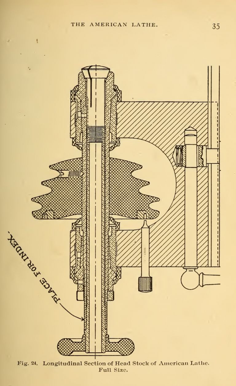

                                Thanks for the clarification, Steve yes
                                I've been thinking about your question whilst out for my 'fresh air and exercise' walk.
                                As you are very limited on space … I would make the body from good cast iron, or bronze, and turn the bearing surfaces directly into it. Preferably a double cone each end [as per the classic watchmaker's lathe headstock bearing]; but realistically, I'm sure a single cone each end would do nicely.
                                Plain cone bearings tend to 'bed in' rather than wearing out.

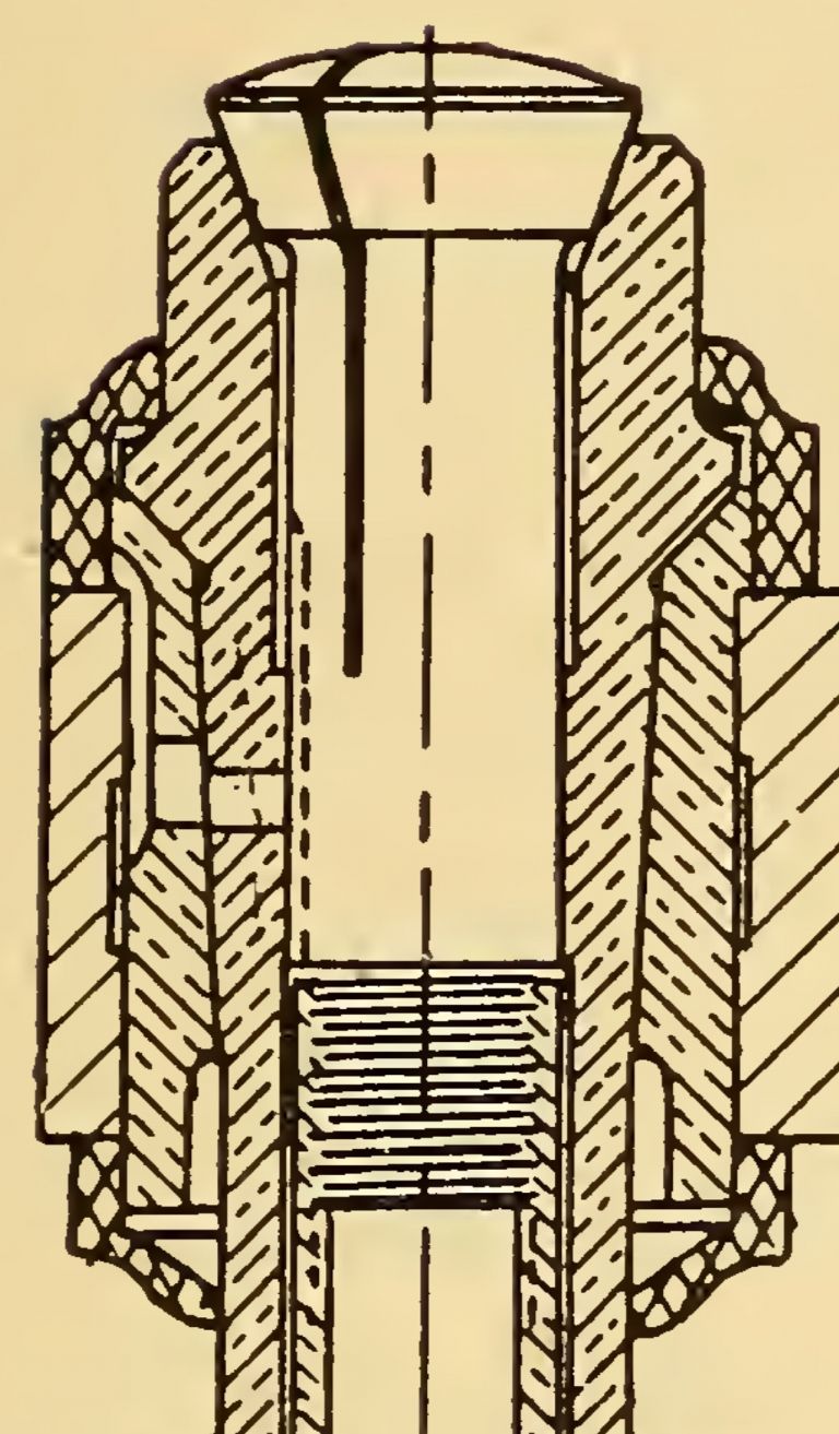

                                    Two at the front would not hurt and if you stay with the thin section ones they are only 4mm wide.
                                      Michael, I'm also liking your idea for cone bearings into bronze. Any idea of the best angle for such cones?
                                      Steve.
                                      In the potts article, MEW 73 the included angle is given as 8 degrees. It has a double cone at each end as per Michaels suggestion.

                                        Posted by Steve Crow on 08/01/2019 18:33:23:
                                        Any 'self releasing' taper would probably do
                                        … but I would guess 20° to 30° included angle. [*]
                                        The optimum would depend upon the balance of axial and radial forces.
                                        [*] Edit: assuming that we are talking about single tapers at each end.
                                        The double taper, of course, has one steeper and one shallower, to achieve the best of both.
                                        Edit: This may help inform your choice:

                                          These might be useful, for the traditional angles :
