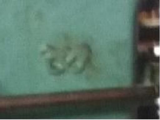

      After failing to buy an Elliott shaper and having a strongly pent up desire to make flat things I impulse spent £300 for a mill, 30 cutters and a 100 mile round trip delivery drive from the seller.
      Not sure if I over paid for it. The search for milling machines hasn't turned up anything better in the past and I can't get an X0 micro mill with table for that money so I don't think I will regret it strongly.
      Any way here are the seller pics
      Can anyone recognise the make? On the side view I can see a sort of celtic knot (I think thats the right word) but aside from that no numbering or lettering.

            The Celtic knot symbol is that of the Denbigh Engineering Co. You’ll find some info about them on lathes.co.uk where there is currently a Denbigh Miller for sale. I’m currently restoring a Denbigh mechanical hacksaw.

                It's a Stafford knot – see Wikepedia. It also used to be the logo of the Bourne and Hollingsworth department stores – but only senior members will remember them. The Southampton branch used to have a good tea shop!
                #308976
                  Indeed that's the Staffordshire Knot!

                    See also the Wiki page on the North Staffs Railway which was called the Knotty, and has knots on its crest.

                      Looks to be a Debnigh H4 auto. One piece cast overarm assembly rather than the two part rod and bracket type shown in the picture near the bottom of this page **LINK** suggests its an older, pre war one.
                      Almost brutally simple, all the essential bits and nowt more. Tough, durable and decently made, albeit aimed at the less prosperous end of the market. Will do what it says on the tin. Maybe a bit slower than a more modern machine but it will get there.
                      Assuming no serious wear in the slides thats a good buy. Simple engineering means you can make replacements for pretty much anything thats worn.
