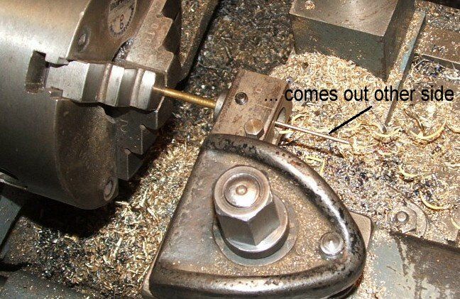

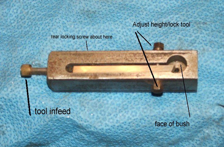

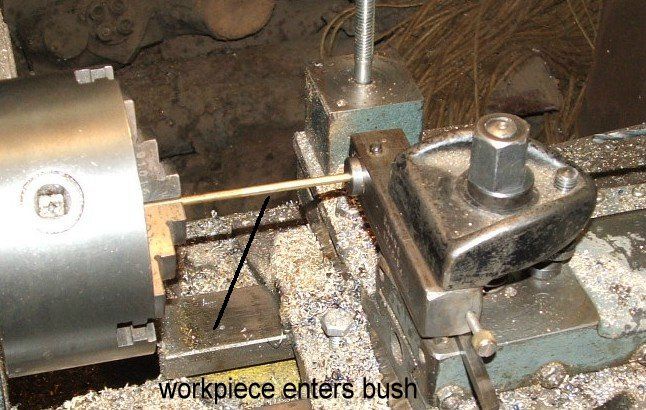

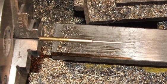

                    Terry Lane
                      @terrylane
                      At the risk of repeating mysellf ….. wink
                      box tool
                      box tool #4
                      box tool #5
                      box tool #6
