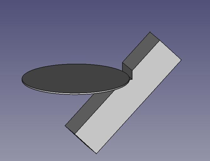

        When drilling or sawing at an angle I find it helps to cut a notch so the cut starts at a right angle to the face.
        Notch greatly exaggerated for clarity! In Iain's place I would cut a shallow notch with an end-mill before applying the saw.
        Iain's point about saws producing a good finish is a good one; another reason would be to make two fitting parts by cutting across a single blank.

            So I read "I'm cutting off about 1mm"
            Then I saw some of the responses.
            Then I read "Depth of cut 1mm"
            Then I saw the diagram.
            Then I saw some more responses.

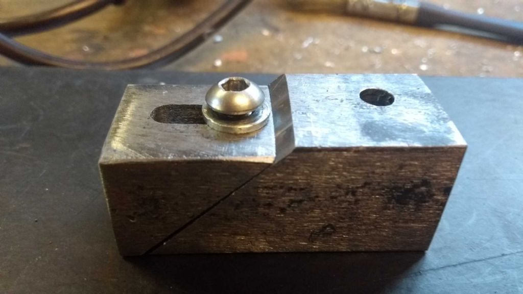

                My Wine Arm has in fact survived the exercise. Which I did do in two parts taking a breather in between.
                I milled the big end clean with a new 4 flute 10mm carbide end mill I picked up at the midlands show. Absolutely brilliant finish.
                I'm struggling to see how to hold the small end accurately, so I've cleaned it up the old fashioned way with a file.
                I shall post a picture of the clamp a bit later on when I've finished. Sadly I now have to cut right the way across the bar to separate it. No slit saw this time!

                  This is what all the fuss was about. After a design by Harold Hall! 45 deg eventually cut with hacksaw and the bigger end cleaned up with mill. Short end cleaned up with elbow grease and file. Appears to slide nicely so I have no further plans to lap or other wise process.
                  Iain
