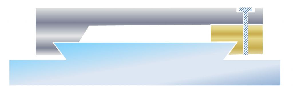

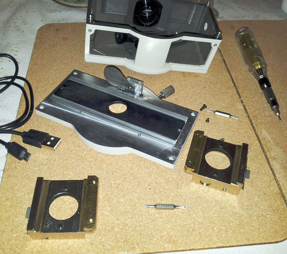

      I've been playing with a microscope flourecence cube holder. Different issue with it was described in another thread here
      There are two "cube carriages" which slide along a dovetail.
      Dovetail is about 3cm wide, 4mm tall. and 150 long.
      the contacting faces are about 4mm for the angled face then 5mm of flat, each side.
      Male part is machined out of Al alloy block, female (carriage) is steel one side, and bronze(?) the other.
      I have two of these. One was so stiff that I dismantled, cleaned out the remains of the old grease…. but it's not better. fine application of WD40, still no better. If anything it's worse. It takes a strong thumb pressure to get it to move.
      I know aluminium can "pick up" against Al, but does it do that with other metals too?
      I've got the carriages off, and though one side should unscrew, the screws are small and "glued" in with something. I don't fancy my chances of releasing them. Is there something I can leave them soaking in to soften thread locking stuff?
      What about the slides – is there a metal polish I can put in to work it with to remove some of the Al?
      A doodle:
      I could try a few wipes with 1200 grit WC paper?

          Are you sure there is no gib strip on the steel side? If there is no gib strip, and no way to adjust the tension of the bronze piece to the alum dovetail, I don't think your slide is fit for use, as it will be extremely difficult to adjust it to move smoothly along its' travel. It's a dumb design in my opinion.
          You might be able to salvage it by adding a steel strip / plate at the right of the assy, with screws into the right end face of the steel, and into the side face of the bronze. That way you could add shims between new strip and bronze to adjust the bronze piece's fit to the dovetail, or add two adjuster screws between the fastener screws of the new strip.
          Aluminum if tempered and anodized may JUST be OK for a dovetail if not used too much. It probably will not pick up, but it sure could wear. Is this item a cheapy from the far east, by any chance? It has the hallmarks of some products from there where materials not optimal for use together and not really suitable in the given mechanism are substituted to make a cheap saleable thing.
          Just food for thought.

                  Chris (R1) – There are many microscope focus stages and optical bench slides that are aluminium on aluminium and aluminium on brass – made by some of the top optical system manufacturers. Since there is very little weight bearing required and the movements are small and slow, lathe type slides and gibs are definitely NOT required!
                  To understand a little better – you say a very firm push is needed to move the slide – can you, to the best of your 'pushability', determine if the resistance to movement is is similar across the slides full length? This will at least tell that the dovetails are straight and aligned.
                  Then try this process over the full length of one side of the base dovetail.
                  Adapt the sanding block dimensions described to suit the length of the dovetail as I have no idea of the size of the device:
                  Cut a piece of Aluminium or brass sheet, say 2mm thick, around 50mm long and slightly wider than the acute angled section of the base dovetail. Make sure it is as flat as possible – work it flat against a sheet or 200 waterpaper on a sheet of glass maybe..Bevel one long edge so that the strip can fit snugly into the dovetail corner. LIGHTLY apply a contact adhesive to the strip face and glue on a strip of 1200/1600 water paper. Move the sliding stage to one end on the slide. Apply some turpentine or paraffin to the abrasive surface. Press the abrasive gently up against the dovetail and gently slide it back and forth 2 or 3 times. Keep wet with the lubricant.
                  Clean and move the slide to the now sanded end, noting the effort required to move the slide, Repeat the process at the other end, and keep doing this till the slide just begins to loosen up.
                  If the stage is tight at ant point, that location needs a few strokes more, etc.
                  As it loosens a little, clean and apply a thin oil to prevent galling, and move the slide end to end half a dozen times. Take a close look at the slides and see where the rubbing occurs and gently work those areas over – sort of like scraping slide surfaces..Abrade the rub mark away and keep repeating – it goes surprisingly quickly and leaves a good result – from experience! Go very gently on the abrading process, less and less pressure and fewer strokes as the slide loosens up.
                  When happy, clean, and apply a thin smear of a light grease.
                  There is another way, depending on the actual construction of the sliding part – you could apply a slight pressure to the centre line of the moving stage, ie, centred between the two dovetail edges, test the movement, and if still tight , apply a greater pressure, etc. The applied pressure needs to be WELL controlled – the idea being to slightly 'bend' the stage so that the dovetails move apart. The amount to bend would be in the order of a few thou, so very difficult to control, and if overdone, the stage is useless…

                    I would regard the use of abrasives as a last-ditch manoeuvre. There's always the risk of abrasive grains embedding themselves in the soft material and continuing to abrade for evermore. Also, you can't put the substrate back, after you've taken too much off. We've all done it…
                    If the thing is as sketched, I would expect that it was assembled by holding all bits tightly together, then tightening the screws. The through holes would have allowed a little movement, so the slide could be assembled rattle-free. With any luck, the screws are fixed with some form of Loctite-like adhesive. It would be worth cooking the assembly in the oven at, say 180C, to soften the adhesive, and then have another go at loosening the screws.
                    WD40 is a poor lubricant in some (many?) circumstances. When you've fixed the slide (by whatever means), there are specialised lubricants that increase their viscosity under shear – the opposite of thixotropic (can't remember the correct term. Was Kilopoise one trade name?). These make slow-speed mechanisms move beautifully, and are used in optical devices and things like rotary controls on hi-fi gear. RS Components used to sell them. I can't find any on the shelves here in NZ, but, for similar purposes (micrometer threads, etc.), use an 'assembly paste' (Molybond GA 50), which is a stiff grease containing 50% Molybdenum Disulphide. It's a pretty good substitute, and has the advantage that it's intended to prevent 'pick-up' and galling.

                      +1 from me for NOT cutting metal – at least not yet. I can't believe those jolly clever chaps at Nikon made something which isn't fit for purpose, they are much more diligent than that. This is the sort of thing they are good at.
                      Aluminium as a slider in this application is perfectly fine, and if it galled up you would be in deep trouble, it would be jammed absolutely solid. I feel this is more about age, and the sticky-ness of rancid and probably dirty grease.
                      WD40 is good at freeing things, but after a short time – a day or so – the residue it leaves starts to dry and go sticky again, so it may be that the cure is worse than the illness. I would be using IPA or even brake cleaner, carburettor cleaner is good too as it dries faster but it can pickle the paint. With the old grease out of the way the slide should move easily – too easily, so add some oil or grease to slow things down again. If the slider is still too stiff when you have cleaned it then there are still grease remnants in there, or a burr from someone else's heavy handed-ness trying to rectify the same problem.
                      I would bet almost anything that the slide doesn't need to be adjustable as it is made accurately enough to control the clearances. This isn't a machine tool its a precision instrument.
                      If I've understood correctly, you have managed to get the assembly with the stuck screws off the microscope. If they were assembled with Loctite your best bet is some heat – low oven, say 120 C or so. Loctite is pretty much immune to solvents – so soaking them is not going to help. If they are stuck because of the passage of anno domini, try some white spirit or paraffin.
                      HTH, go gently at it, and don't start introducing abrasives unless you can be sure to clean the residue out again afterwards.

                          Having worked on micrometer adjusted optical slides of similar, but not identical construction with similar issues I agree that its a completely take it apart, clean and re-assemble issue.
                          The trick is to maintain the correct spacing between the brass dovetail and the fixed dovetail as you tighten up the screws. Darned if I can recall exactly how I did it.
                          I imagine it involved tightening up the screws a tiny bit at a time followed by stroking backwards and forwards a few times to settle things absolutely parallel before tightening a bit more if no tight spots encountered. If a tight spot is found then the screws need to be released a fraction to let the slide take up a new position with enough clearance to move freely before stroking an few times and continuing with the tightening process.
                          Assuming the sketch isn't over-simplified I'd not consider it a clever design. In the optical lab equipment world similar systems used caged ball bearing slides giving a whisker more freedom of action and error tolerance. Still a total pain to get just so tho'. The fundamental issue with that design is that you only have control of dovetail way spacing but the top also sits on the return edge of the dovetail L shape. For the thing to work properly the top needs to be absolutely parallel to male dovetail so the brass, free, dovetail needs its top machined to exactly the right thickness. Difficult. I'd expect jack screws as well as fixing screws to get the top dead level. Which adds another level of complexity to free hand adjustment.
                          If it does have jack screws then original assembly might well have been in a jig holding the two female dovetails together on the male dovetail at the right clearance so the top could simply be screwed on against the jack screws. If done this way assembly would have been a very fast process with almost no fiddling around. If you have the facilities seriously consider making an external jig to set the dovetail clearance independent of the screw tightening process.

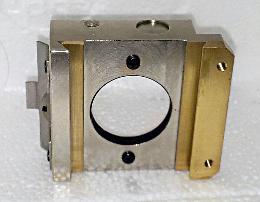

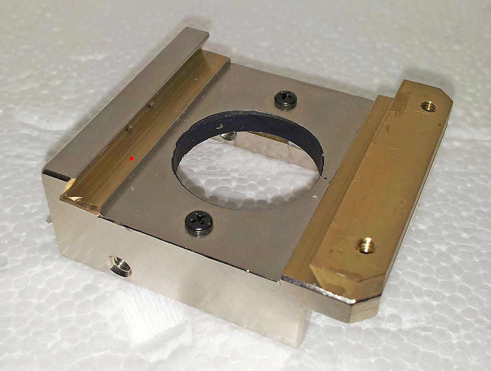

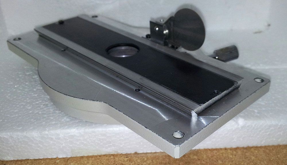

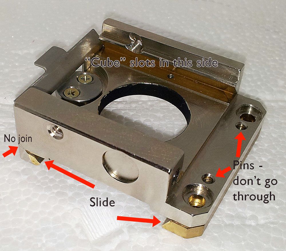

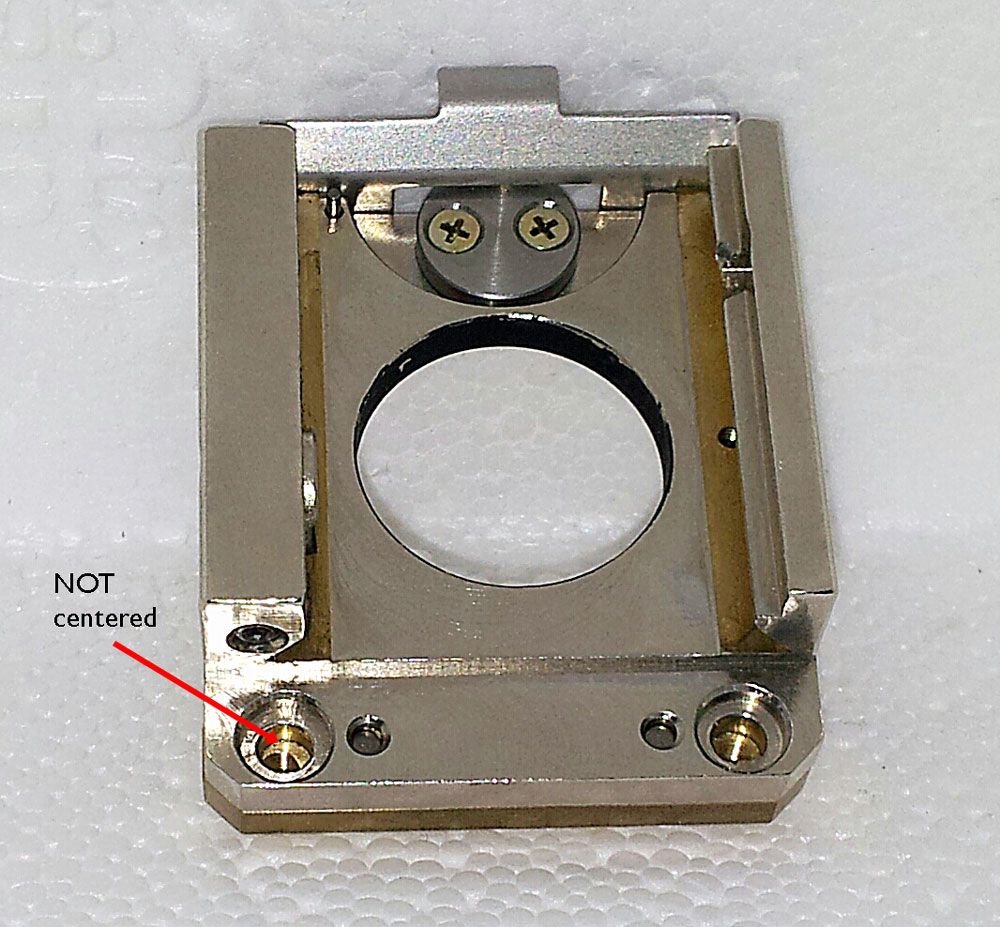

                                          Ugh lost a load of text when I went to upload pics – too tired to put it all in again, it's 02:43.
                                          I was wrong, It's not steel, it's all copper alloy. some plated -as someone suggested.
                                          The screws are out care of graffiti remover which dissolves everything. Even formica worktops. But the bits are still together. Pins of some sort..
                                          Surface with red dot is smoother than it looks.
                                          Hope it's clear, sorry they're grotty pics. Could do better. I have some fine SiC paper – but I'm bothered that the slide is just about jamming for part of its length and free elsewhere. I used lighter fuel and WD 40 – pretty sure all the old grease is off it.

                                                Chris T – "binds". Some grease has arrived so I'l try that. I'll get the luggage scales out. Maybe even embarrassed use a microscope.
                                                On the "particle of grit" debate, IME as an undergrad metallurgist, abrading metals on a series of wet papers is the way you get to a mirror finish (which you then etch with acid to show the structure). But if you didn't throroughly was all the old grit from previous papers away between grades, then you had an ugly score which meant you had to go back and do it again. Grit would rollaround, I don't remember any embedding. Some bearings (I remember "white metal" crankshaft shells as a case in point) were designed to be soft so they allowed embedding of hard particles so they wouldn't cause trouble.
                                                I wouldn't care to predict what could happen in a specific situation, ever, though.
                                                #394329
                                                Clive Foster
                                                  @clivefoster55965
                                                  Ah-Ha. The pictures of the complete assembly reveal all.
                                                  That unit would certainly have been assembled in a jig to keep both dovetail pieces absolutely parallel when the screws are tightened up. Jig would have had push adjustment screws, probably 3 or 5, to get the pressure and slide resistance just so before the screws were tightened up, carefully and bit by bit in sequence. Locating pin holes fitted next in self jigging process.
                                                  Fast, simple, reliable and very effective on the production line. With only two fixing screws your chances of getting it just so are slim to none. Fitting a third screw in the middle might make free hand assembly to "just so" standards possible. But I have worked on a system of that style with three screws. It was still aright PIA getting from "almost OK" to "dead nuts". That said I think the system I worked on was only intended to be pretty good not dead nuts.
                                                  No practical experience of setting / locating jigs in that sort of application but I have assembled things that pretty much worked in the same way as that sort of jig would and getting it right was pretty much a breeze.
                                                  For setting jig think square hole in thick plate received to clear the male dovetail with pusher screws to align the loose dovetail. Best made by careful machining with an accurately flat side sitting against the fixed dovetail but I've little doubt that something cruder with screws both sides could be got to work just fine.. Take 5 times a long tho'. You will need a smooth, fairly thick shim between the side of the loose dovetail and the pusher screws so the dovetail moves smoothly without friction or twist as the screws pull it into place. Pins go in after screws are tight. You may have to re-drill.
                                                  Regrettably its one of these things that takes three goes to get the technique just so and fine tune the equipment before it becomes fast and easy to do.
                                                  Clive.
                                                  #394333
                                                  Chris R 1
                                                    @chrisr1
                                                    Wouldn't it need springscrook? It's tight in one part of the length and OK at another. My nagging question – how did that happen?
                                                    If I tap a razor blade into the join to separate the bronzy side piece, do you think it will go back in the same position, as set by the pins?
                                                    I suppose the pins might be "riveted" to some extent. I mean plastically deformed such that they would 't work again if pulled out, unless hammered/pressed back. They aren't roll pins..
