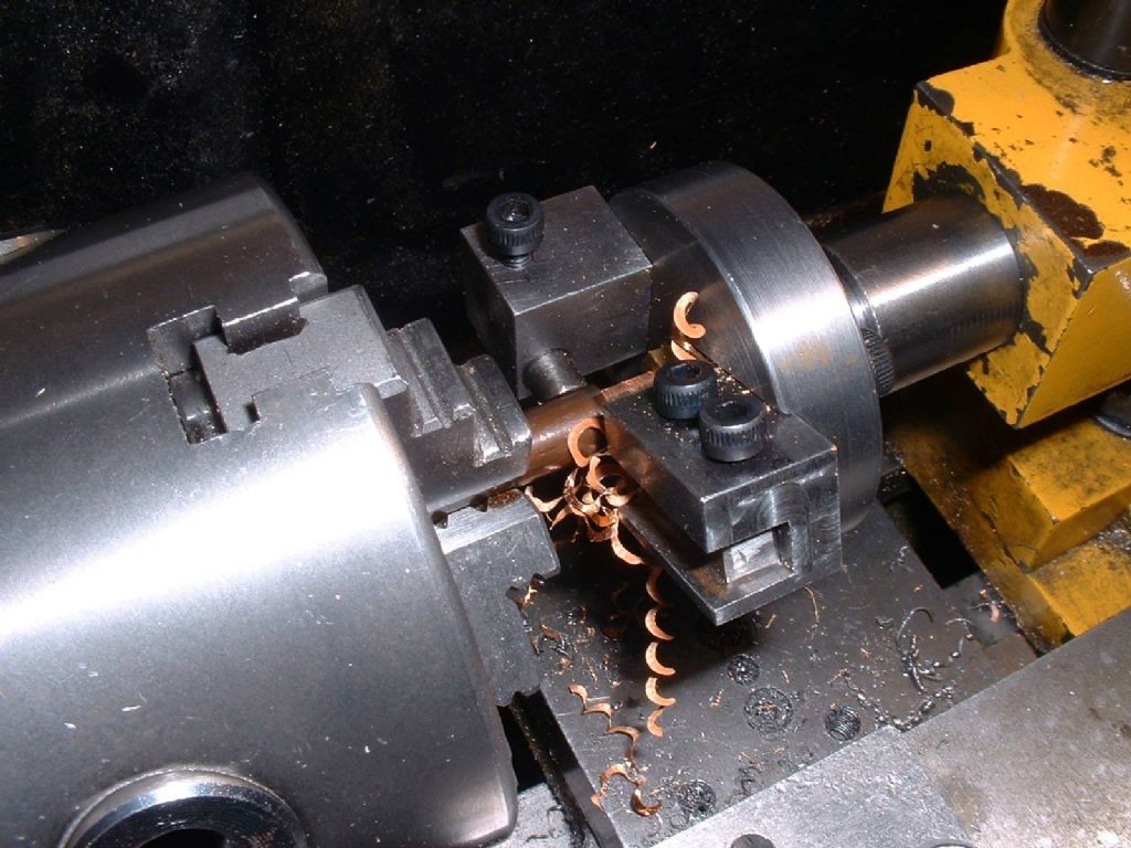

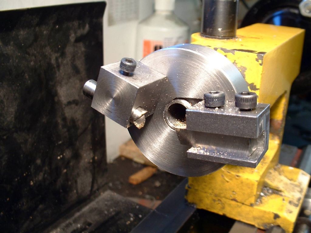

          Hello David,
          Its a steady rest, but I think you will search along while if you seek one that works like that.
          Alternatives include a box tool and making one yourself – which shouldn't be too difficult. It can be as simple as a bar clamped to the toolpost with a hole drilled in it. The difficult bit is setting the point of the tool to get the right cut.
          This is my box tool:

            Thanks Neil,
            It was most interesting to see that, I particularly liked the way it uses a V steady to stop the piece from both lifting and from pushing away whilst being adjustable for many diameters without having to make bushes.
            I was thinking of making something to go in the toolpost, so you could use it for long lengths and I am now wondering about a tool in the top (compound) slide, therefore finely adjustable for diameter, and providing the support from the back toolpost. I like making tools equally to making models, and despite my current resolution to "get on with the steam engine", it looks like a tool project may be on the way.

            #172842
              Chronos used to sell one but not seen it listed for a while, have a search on some of the other forums like MHEM, MEM and MECH the subject has been covered on them all. Not too hard to make one either.
              HMEM thread
              Edited By JasonB on 17/12/2014 20:55:00

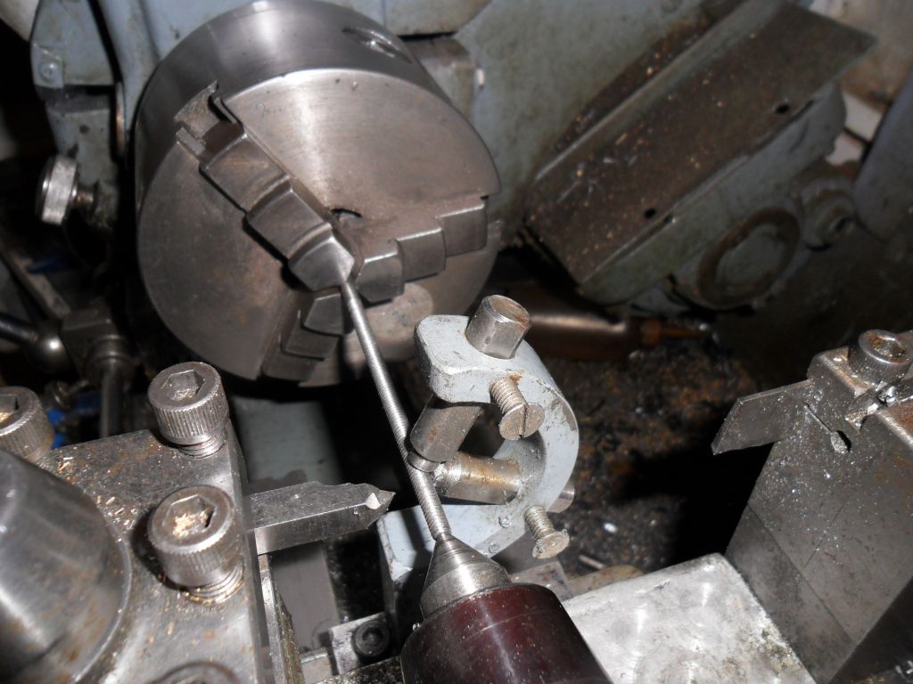

                                          #176598
                                          David Haythornthwaite
                                            @davidhaythornthwaite90386
                                            Thanks to all who contributed to this thread.
                                            I finished up turning lengths of silver steel down to 2.2mm diameter to cut into 8BA studs.
                                            I used the rear tool post to hold a Phosphor Bronze bush round the rod, and set my topslide at right angles to the lathe bed (almost 90 deg – full right angles is impossible on a standard ML7 top slide.) The cutting tool (tangential) was adjusted by the top slide feed screw.
                                            I attach a photo of my setup.
                                            The finish was not as bad as it appears.
                                            Thanks – David
