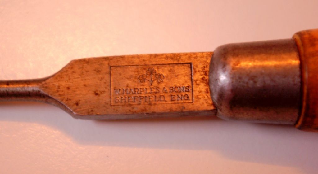

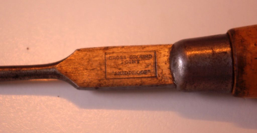

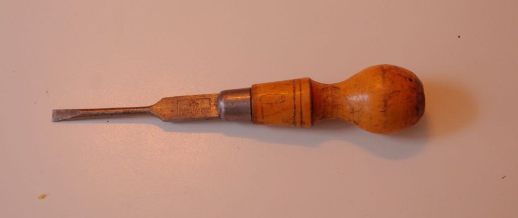

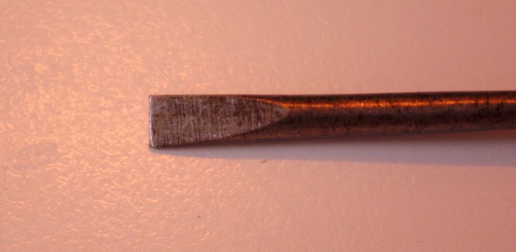

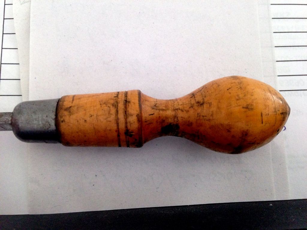

      6.1/2" long with a nice wood handle and unusually ground blade.
      Ibe never seen one ground in this fashion, hollow ground yes.
      Marples & Sons
      Marples & Sons
      Marples & Sons
      Marples & Sons
      Marples & Sons

          I have one of those, it was my Fathers. He always called it a cabinet screwdriver. I must search the boxes and find it. I still have his Marples wood chisels, they keep a superb edge.

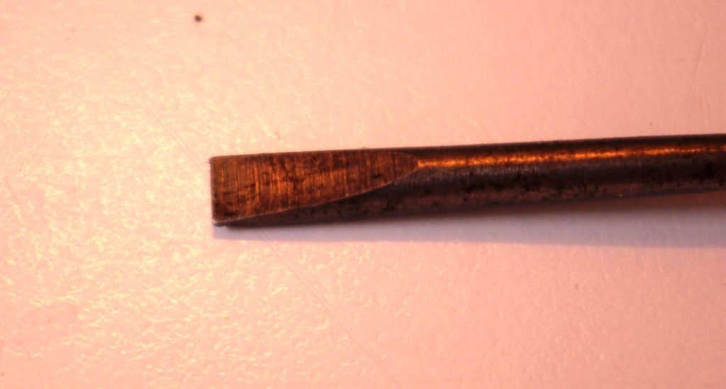

                  Am I seeing the blade hollow ground cross wise and not lengthwise as is more common.
                  I think this is the point the OP was trying to make, we have all seen hollow ground ones done lengthwise, but I have not seen one ground like this before.
                  I would be interested in seeing a photo of the tip end on.
                  Phil
                  Edited By Phil P on 20/03/2017 17:19:25

                      I too am curious how the skid resistance is achieved?
                      I recall seeing screwdrivers some time ago that had fine 'serrations' across the driving faces of the tip that were supposed to stop the blade sliding out of the ends of the slot. Not sure what the manufacturer described them as, but think it was 'anti-skid'

                            #289866
                            OuBallie
                              @ouballie

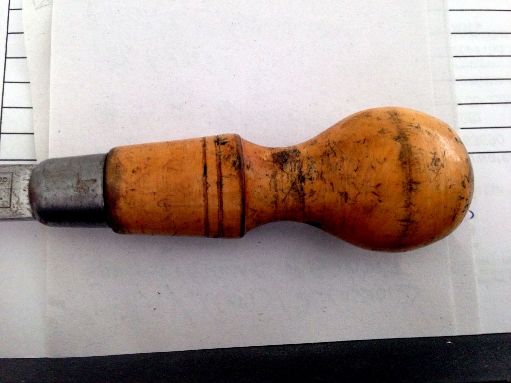

                              Blade not hollow ground.
                              Marples & Sons
                              Side view of handle
                              Marples & Sons
                              Front view
                              Marples & Sons

                                          I suppose the sideways grinding on Geoff's screwdriver is intended to have the same effect.
                                          Russell.
