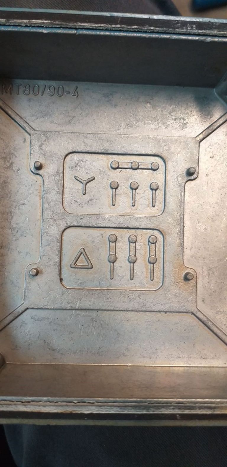

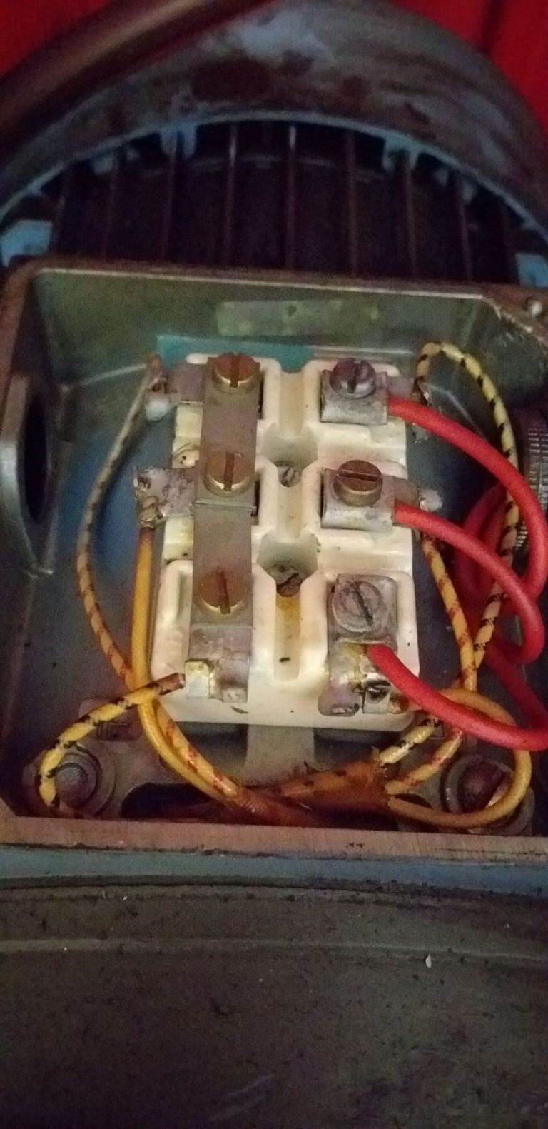

            The task in-hand is to run a little milling machine from a single phase supply, attached photos may help.

                Thats a nice little milling machine, AEW Viceroy / Horizon. The motor in your pictures will convert to delta for a VFD just fine.
                I see why a converter was used. Two motors. 2 hp on the spindle and 1/3 rd hp on the power feed I think.
