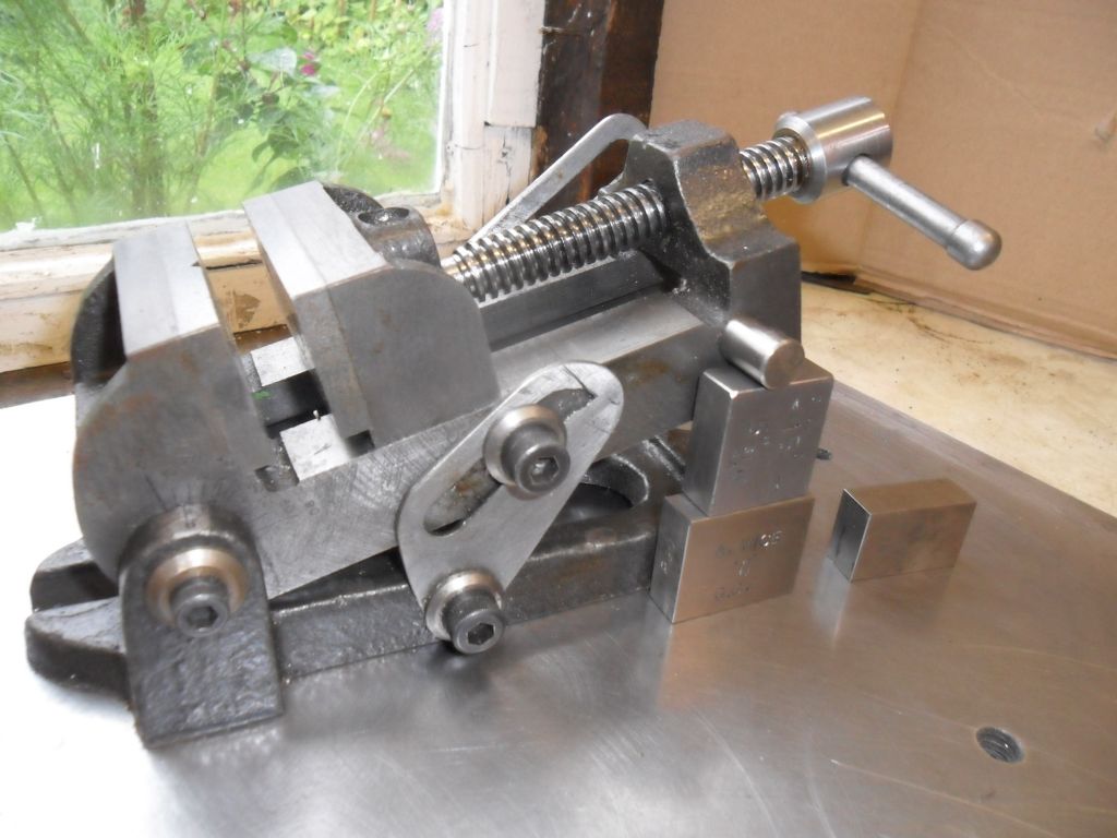

      Dear All,
      I have been lurking on the site for some time but have never posted before ,please excuse me if this question has been dealt with before. At the Midlands exhibition in 2010 I saw a sine vice which I believe had been made from a fairly cheap ubiquitous Tilting vice similar to the vice which formed the basis for an article on upgrading it in one of the very earliest Model Engineer’s workshop issues. I have had one of these vices at the back of a workshop cupboard since I first started in the hobby , and have always meant to rectify its deficiencies.Having re read the MEW article I got it out finally at the weekend to start the job [ Oh Boy its no better than a set of castings!!], and remembered the sine vice at the exhibition. I had phoiographed it on my phone but the detail is not great . Does anyone know if it was a one off or made to a plan or published article. I really would like to have a go at the conversion as part of playing with the ‘set of castings’ Thanks for any info

              Hi Ian
              I have made a sine vice using a commercial bought vice . please see picture in my album i could no add it here it would not insert?. You will see I have made some acccurate angle block 10 15 20 degrees etc to save using my best slips.
              the 5 ” center was picthed off from c/l of pivot using DRO on a bridgeport mill
              Regards Nobby

                @submandrel
                Neat idea Nobby! I shall improve mine in teh same way.
