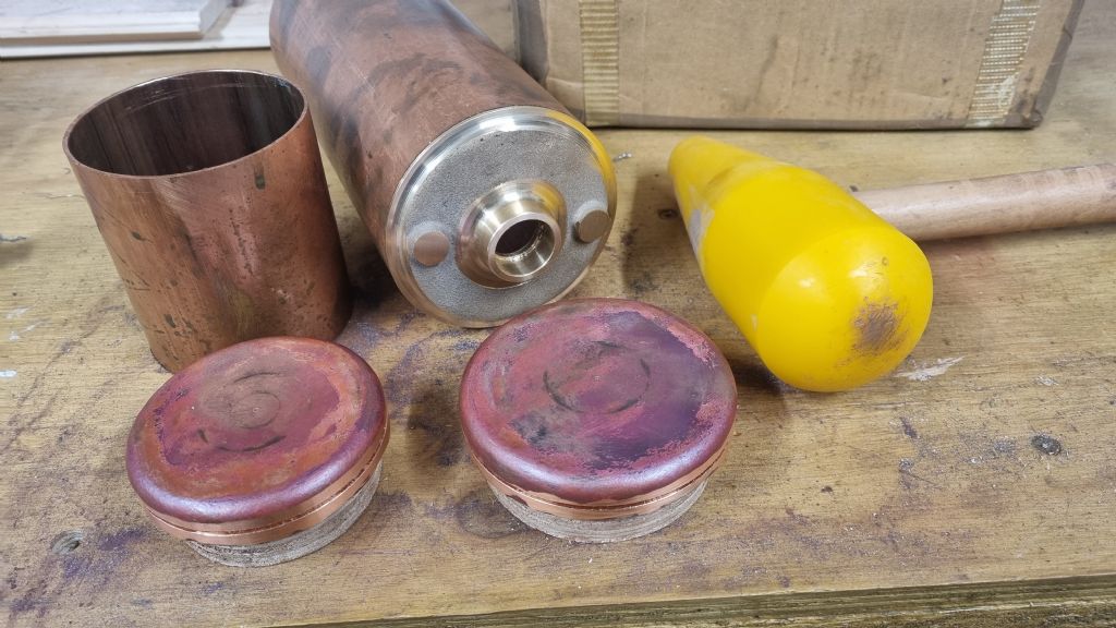

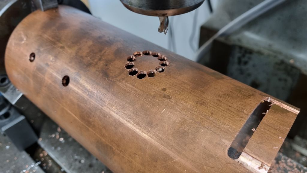

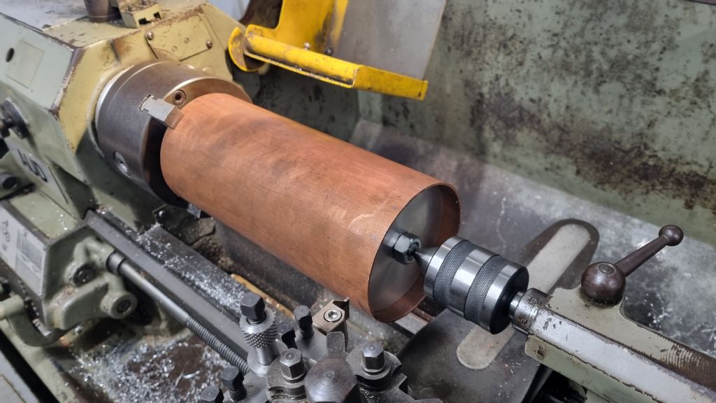

                    I have made some progress over the last couple of months, between doing other things.
                    Plates flanged, using wooden formers.
                    The outer shell & firebox were fitted on to aluminium end-caps on studding, with one end in the 3-jaw chuck, the other end supported with a centre, the ends turned.
                    The same setup was used on the mill with a dividing head to put all the holes in.

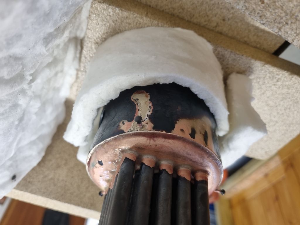

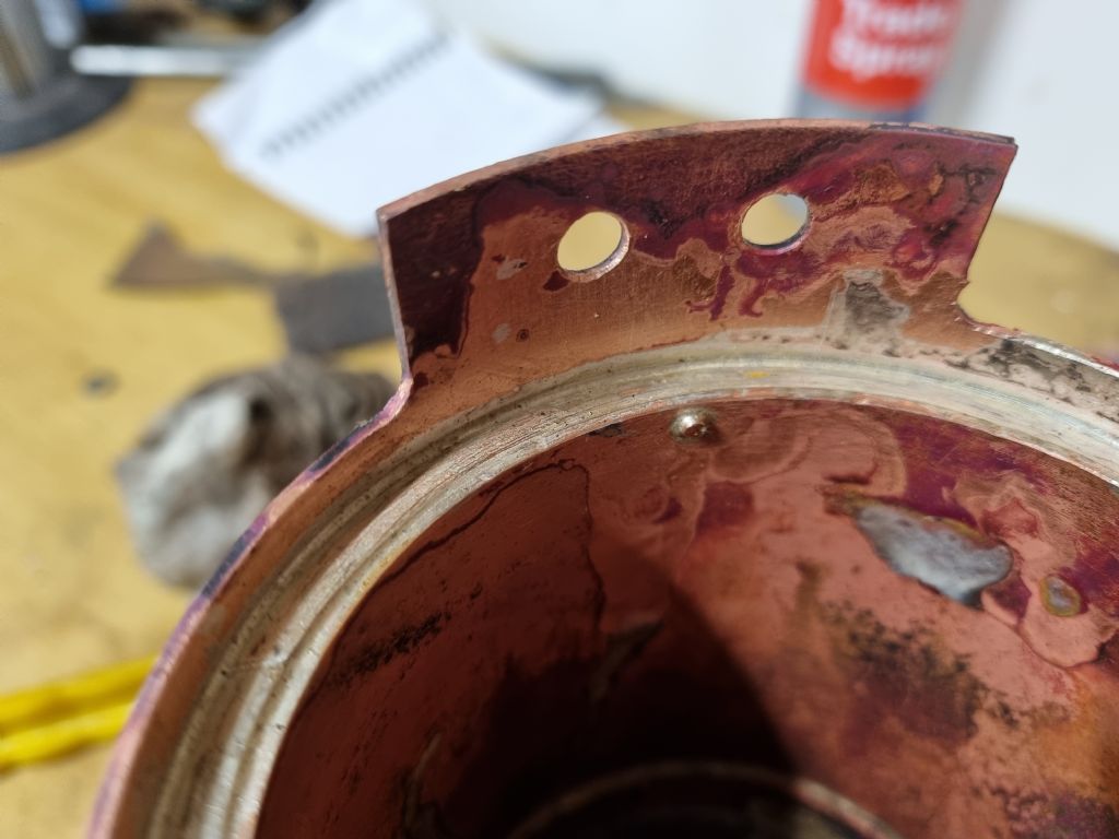

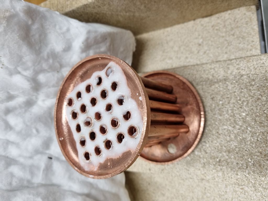

                    I decided to go with option 3, just as I could then access the tubes easier, I did have 1 tube I needed to revisit. This photo shows the tubes ready for soldering.
                    The firebox was fitted, making sure the rivets were soldered.
                    Then the inner was fitted to the shell, again making sure that the rivts were soldered, the solder flowed through the joint and came round the rivet.

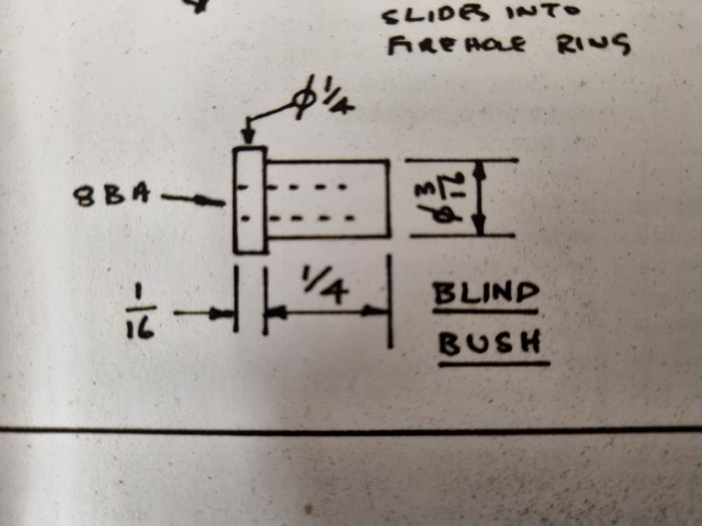

                    One issue I have is that the notes with the kit have a drawing for bushes to hold the fire-hole door, as drawn they are so long they will touch the inner, I only realised this after I made them, so will re-make them shorter with less thread, not that they need 1/4" depth, I will grind an older tap so it has a flat botton.
                    I now need to get some more solder, so there will be a pause until next weekend.

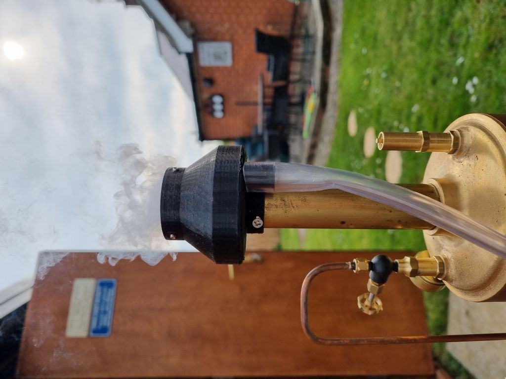

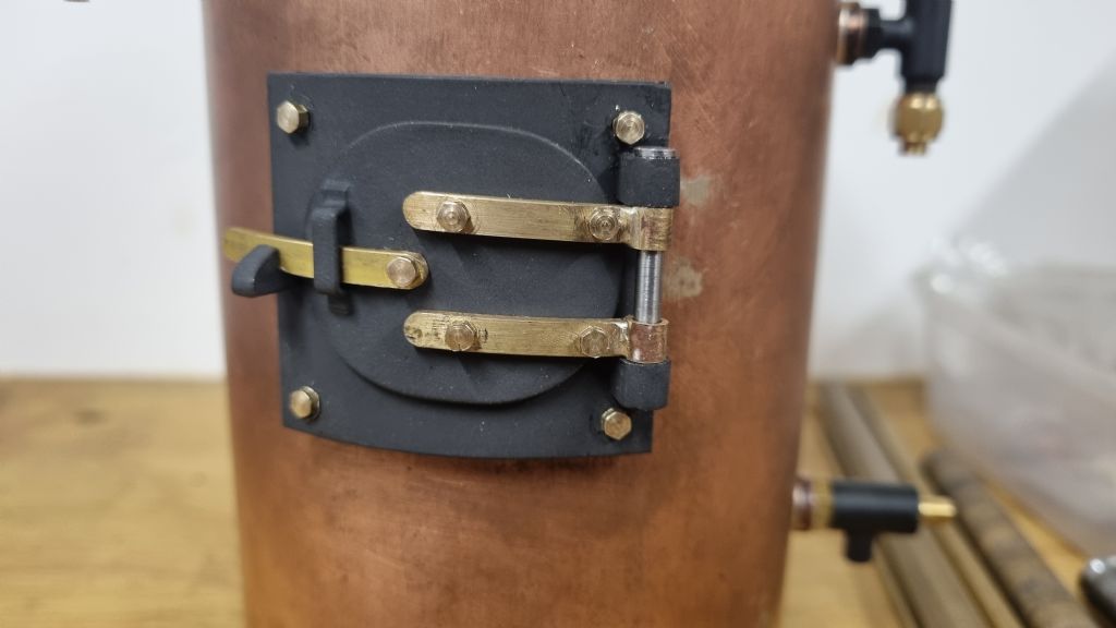

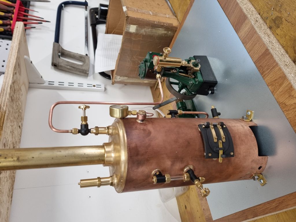

                      I realised I have not updated this in a while.
                      I soldered the top tubeplate quite happily, and then all the bushes for the fittings. I gave the shell a hydraulic test and a steam test, with no leaks in the boiler.
                      A firehole door & grate were made, then it was mounted on a board to connect to a pump and engine.
                      Sorry about the picture on it's side, it looks fine on my PC.
