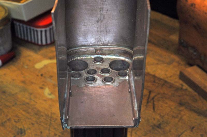

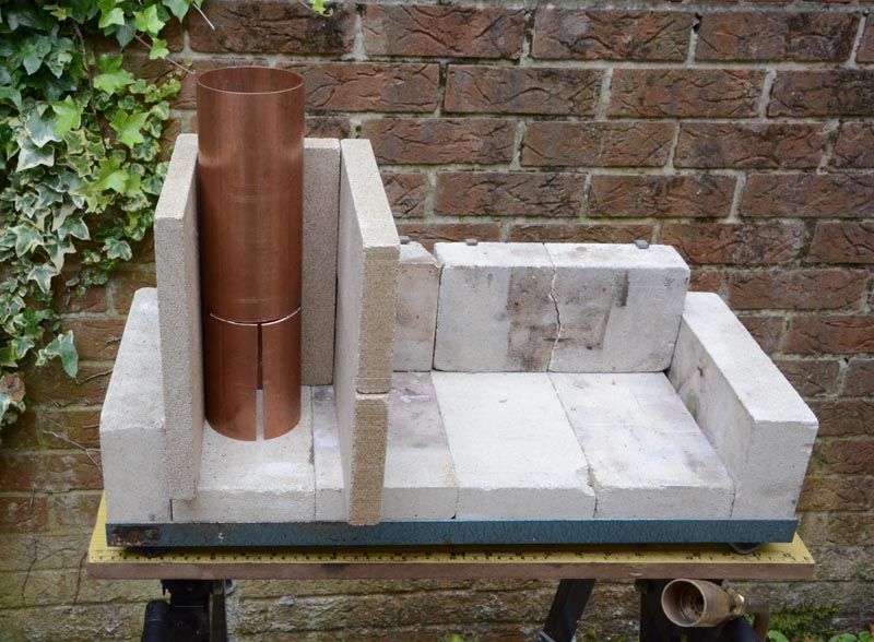

                        #283045
                        Roderick Jenkins
                          @roderickjenkins93242
                          Posted by Bob Stevenson on 08/02/2017 10:31:34:
                          …………but has anyone got the eurofriendly stuff to actually work?……….if you have then please tell us how!
                          Heat! I used this hearth with a Sievert 26kW (2942P) burner. Also used a ceramic insulation blanket.
                          This burn was with 38% Ag alloy and HT flux
                          This assembly with 55% Ag, also HT flux
                          It works. Melting temperatures are only about 30C higher than cadmium bearing alloys.
                          HTH,
                          Rod

                              As Rod explained, you just need more heat. His approach is spot on. Possibly use a bigger burner and insulation to keep the heat in. You may need a longer life flux like HT5
                              Watch the flux. When it has melted and started to flow apply the alloy. It is pointless trying to braze until the flux has melted. The joint is simply not hot enough. Do not heat the alloy. Allow it to get its' heat from the joint. Getting the alloy hot is one hing – getting the joint hot enough is another. If the joint is cold the alloy won't flow
