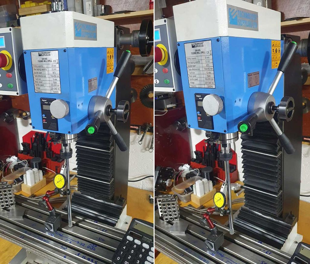

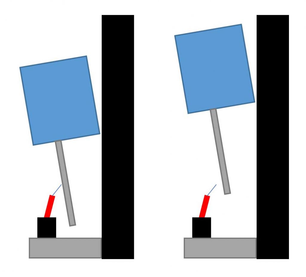

      I've recently acquired a Sieg SX2.7L clone, which I believe was built in 2019. The first job I ended up needing it for was fly cutting, with a large diameter (approx 13cm / 5&quot. I noticed that the cutter was taking more material on the trailing edge; which I understand would indicate the machine is slightly out of tram.

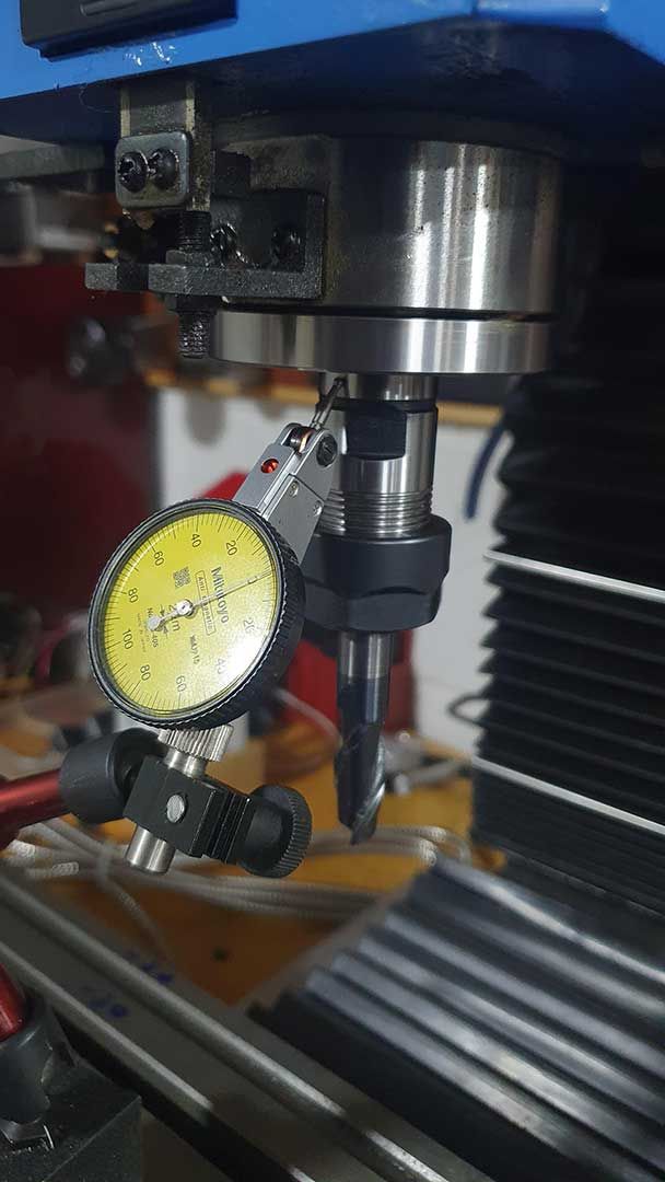

      I first checked the spindle runout with a DTI touching an MT3 ER collet mounted in the spindle (see image below). This showed 0.004mm of runout, so I'm assuming this is not of concern.

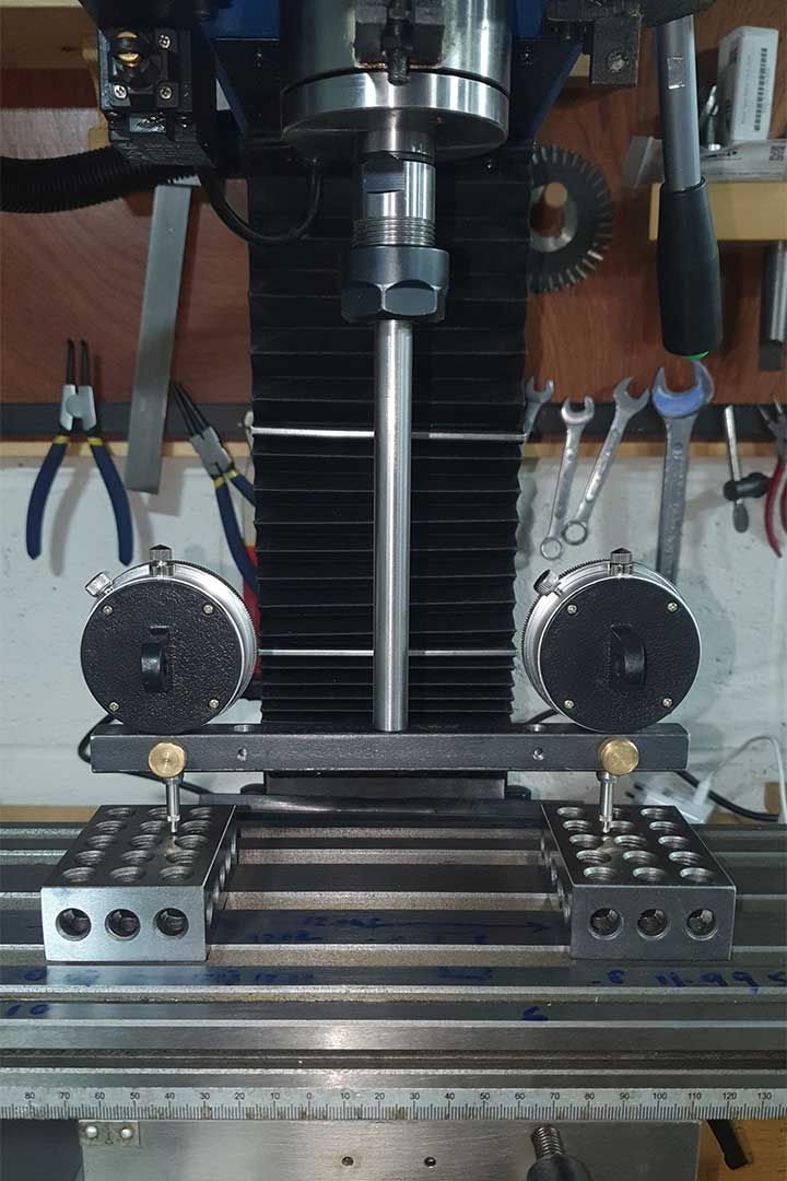

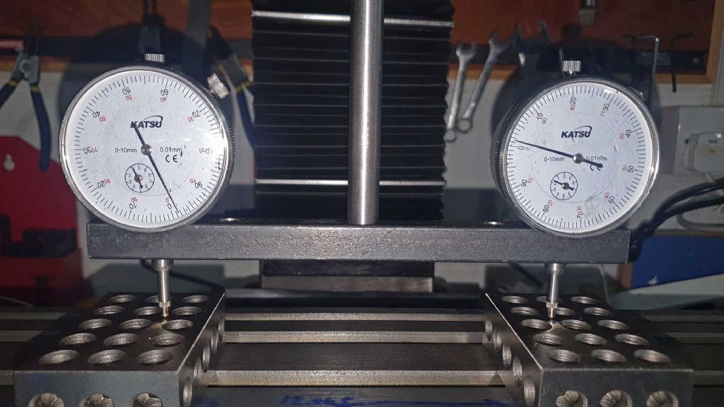

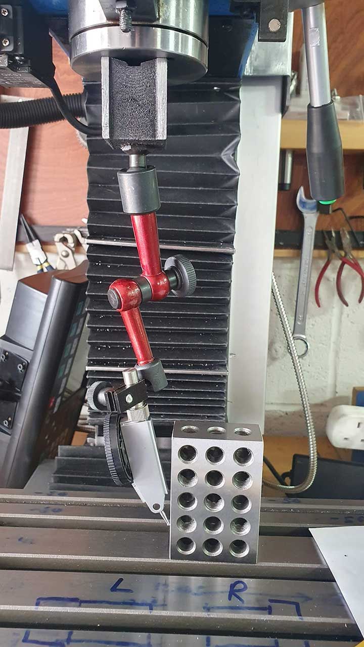

      Next I clocked the spindle across the length of table. Two indicators approx 150mm (6&quot apart, set to 0 when facing away from me.
      Turning the spindle 180 degrees shows around 0.015mm of deviation. As the left side of the table is low, right side high; I assume this means the column is tilted slightly to the right.
      I then took the same measurement across the width of table. That appears to show that the front of the table is high and the rear is low (by approx 0.06mm to 0.08mm). I assume this means the column is also tilted forward.

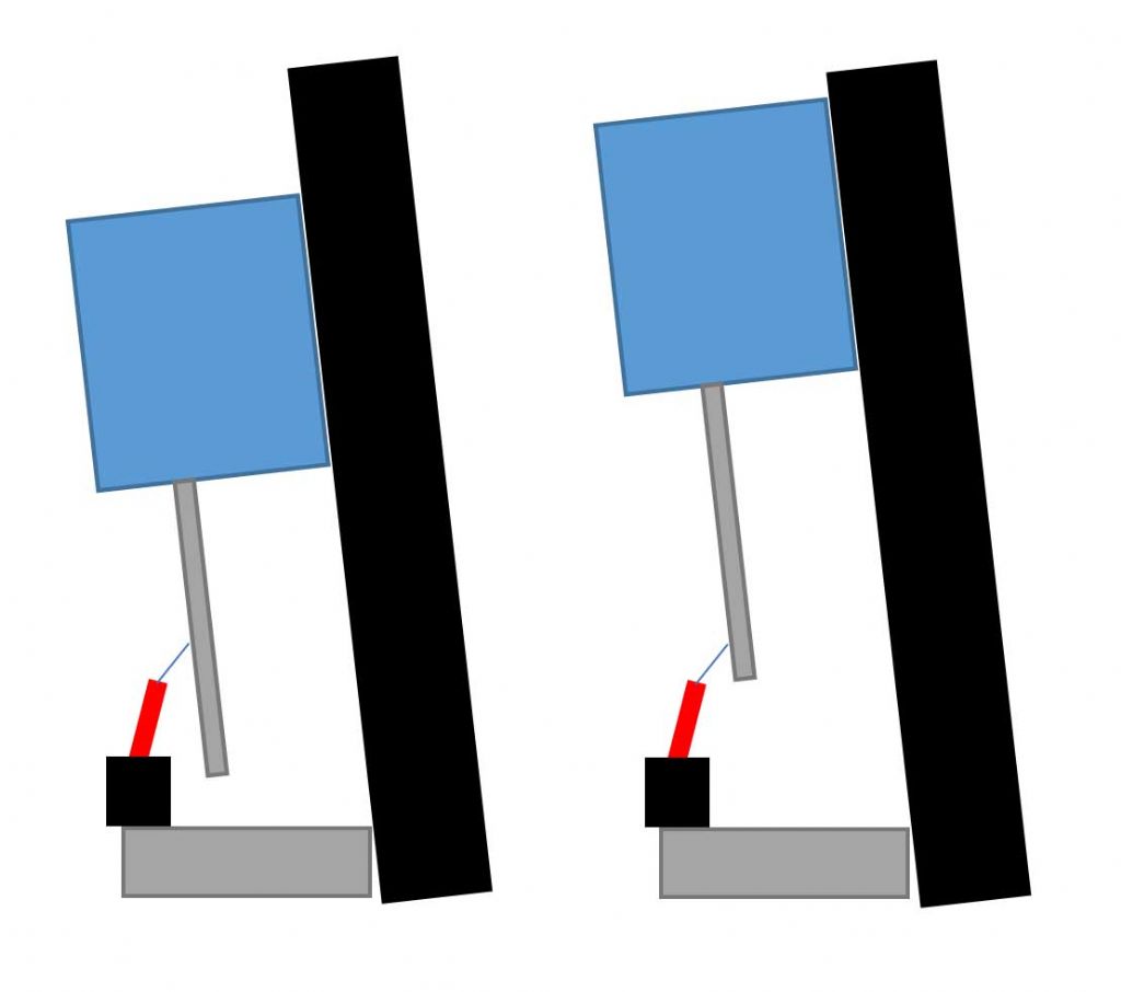

      However, I next swept a rod in the spindle along a DTI by raising the mill head up the column. As the head rose, the DTI reading dropped (rod moving away from the DTI) by 0.1mm over a distance of about 43mm of vertical travel.
      If I understand correctly, if just the column were out of square this reading would not change (see below for a very out of square column, with the head moving up, but the rod-to-DTI distance remaining constant).
      However, it would change if the head were nodded forward on the column; e.g. for a very out of square head, with the rod-to-DTI distance increasing as the head moves up the column.
      I repeated this test with the DTI to the side of the rod, and it showed essentially no change when the head was raised up the column; so I assume this means the head is not tilted left/right, and the 0.015mm deviation across the length of the table must be down to the column alignment.
      Assuming I'm taking the above measurements correctly (do tell me if I'm not), it looks as though the main/first issue is the nod on the head. How do I (can I?) correct the head nod on this machine?
      BTW for all tests so far the spindle has been fully raised; I'll check it once the head/column looks OK.

          Look at the head taper gib for a start if you feel it is the head nodding on the column, make sure both screws are in contact with the gib strip ends
          Out of interest have to clocked the end of that rod to see if it is running true that far out of the collet chuck?

            Good point – I haven't checked if that gib needs snugging up. I'll look at it in the morning; many thanks.
            That rod isn't actually running particularly true, but it was clearer for the photos. I ended up taking measurements on the rod for the tool that holds the two clocks; which is much closer to true. I did also repeat the measurements after rotating the spindle by 180 degrees; which I assume would have reversed the error if it were actually down to the rod being bent?

              Jason – I think tightening the gib has helped. I removed the gib screw for the vertical axis and confirmed that the head does make contact with the gib wedge. I then tightened it until I can just feel a little drag when raising and lowering the head on the column.
              With a DTI mounted on the table and a rod in the spindle I raised and lowered the head again. Rotating the spindle 180 degrees and repeating measurement was pretty consistent; so I assume the rod is straight. That gave me a reading of just under 0.08mm over 100mm of column travel. My earlier measurement of 0.1mm over 43mm would equate to 0.23mm over 100mm; so it's certainly improved.
              If I read the inspection record for the mill correctly, it claims 0.10mm over 100mm; so I'm within the claimed spec. Whether that's "good enough" for a home mill I've no idea.

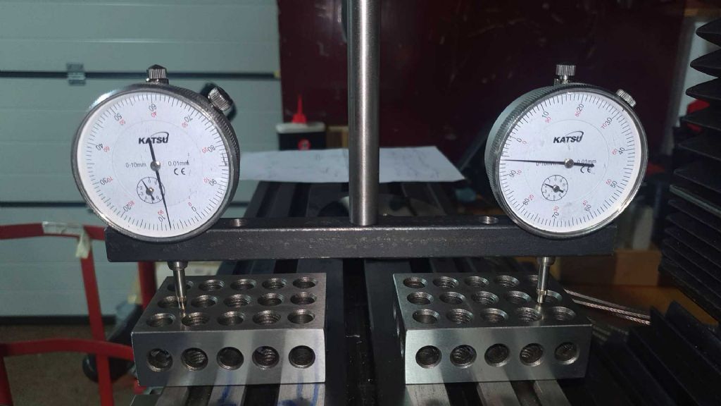

              Putting the DTI on the spindle then sweeping it around the table indicates the front to back height discrepancy is under 0.01mm over a sweep diameter of 130mm. Given that the inspection record claims 0.03mm over 100mm I can't complain.
              From that same test I appear to now have about 0.03mm discrepancy (over the same 130mm diameter) from the left to the right. Again that's within the claimed spec (0.03mm over 100mm), but I might risk torqueing the column bolts to see if I can reduce it a bit, then I'll check the spindle squareness.
              Overall though, I guess that's starting to look acceptable for a budget home mill. I don't really know what is "good" for this class of machine. Is there a general rule of thumb for how well trammed a machine needs to be to achieve a good fly cut finish (for a certain diameter of fly cutter sweep)?

                  You're right about locking an axis having an effect; I swept a DTI around the table with and without the vertical axis locked, and it measurably causes the head to twist slightly. However, just moderately locking the axis results in a pretty good reading; around 0.01mm over 130mm across the length of the table, and 0.006mm across the width. I'll take that.
                  I tried to check the spindle for squareness but I'm not sure that my cheap 123 blocks are that square. Regardless, the worst I saw was under 0.03mm of deviation over the 70mm spindle stroke. Again if I read the inspection report correctly that's within the claimed tolerance so I can't complain.

                                                Lots on recently so I've only just got back to looking at the mill. Following Martin's advice, I put a 123 block on the table and ran an indicator down the side by lowering and raising the whole head on the column (i.e. not extending the spindle).
                                                After running the indicator with block to the right of the spindle, I rotated the spindle 180 degrees, and also rotated the block around so that I was running on exactly the same surface (but with the block obviously now to the left of the spindle). I got a pretty repeatable 0.1mm change over 100mm of vertical movement; where the dial indicator is moving to the left as the head drops – I take that to mean the column is tilted slightly to the right (clockwise if looking from the front of the mill).
                                                Trying to improve it by changing the torque on the bolts holding the column to the mill base seems to be a bit hit and miss (either no change or too much change). If anyone has advice for doing this on the SX2.7 I'd be grateful.

                                                  Maybe partly answering my own question; from a bit of searching it seems that the technique is to tighten all four bolts holding the column (perhaps using a torque wrench for repeatability) take measurements, loosen the bolts to insert shims, tighten it back down again and repeat until happy/bored/insanity sets in.
                                                  I've also seen suggestions of drilling and tapping holes next to the bolt holes (for grub screws) and using grub screws for adjustment instead of shims. Sounds like an interesting idea but then I guess you don't have as much surface contact between the column foot and the mill base.

                                                    My experience on a X2.7 is like you say hit and miss but you do learn from your misses and you narrow then alterations down to a point whers it is close enough.
                                                    Mine ended up by: leaving the 2 lefthand bolts dogged down, and sliding cut up feeler gauges on the righthand side, then dog down the righthand bolts,
                                                    Not sure if you have a torque wrench with an open ended spanner, I thighten down dog tight.
                                                    0.14mm shimed righthand back.
                                                    0.04mm RH front
                                                    spindle tram 0.01mm x left to right over 200mm
                                                    and 0.01mm y front to back over 110mm
                                                    Allow a day or two.
                                                    Think everything is made of rubber and moves about
                                                    and never give up.
                                                    Also adjust your gibs before you start mine was 0.31mm x and 0.2mm y
                                                    after adjust it dropped the x to 0.21mm.
                                                    good luck
                                                    Lofty
                                                    #645408
                                                      over 100mm of movement of the head I get 0.02 in X (sideways)and 0.04 in Y (nod) adjusted with bits of feeler gauge.
                                                      Tramming spindle to table less than 0.01mm over 140mm circle
