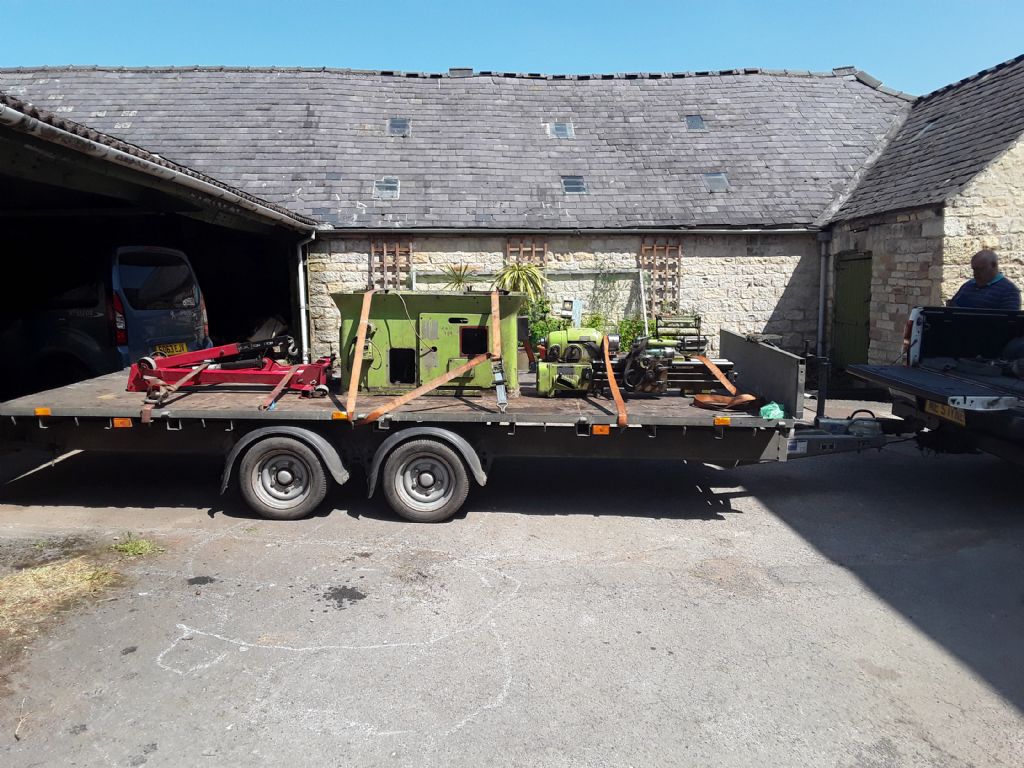

      Well the time has come to start some downsizing of my workshop equipment.
      My partner Ruth is severely disabled with MS and getting worse. So with my limited time and energy to tinker in the workshop and not wanting to become lumbered with large and heavy machines and all the problems of moving them in the future I have decided the bigger stuff may have to go. I hope to replace them with smaller lighter machines that can easily be lifted into a car or van for moving when needed.
      The fist casualty is my beloved Smart & Brown Model A lathe, here it is already loaded up and ready to go on the new owners trailer, he is a friend who owns and restores old buses and tractors.
      My plan was to put the cash towards a C3 Mini lathe and a new Sieg SC4 lathe, but I have just noticed that the Sieg SC4 lathe price from Arc has recently risen by about £300, so that has probably knocked that dea on the head.
      I have owned the old S&B lathe for at least 25 years, it was great to use and sad it has gone, but time moves on and circumstances change so it is the first that had to go.
