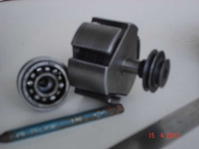

                                                    Ian S C
                                                      @iansc
                                                      019 (640x480).jpgI have a number of generators and alternators, this is a 6 pole, shaded pole motor, modified with a permanant magnet claw type armature. The shading rings have been cut, but this makes little, if any difference. It uses 2 Ferrite magnets from old speakers, another source of these magnets is old Micro Wave ovens.
                                                      Edited By Ian S C on 11/10/2016 10:06:16
