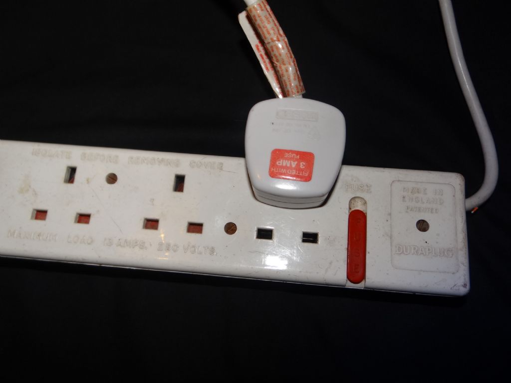

      I have a 4-way socket outlet in my workshop which is hidden behind a grinding wheel and some other junk. Reaching over without looking to plug in a Radio, I managed to do this:
      Putting the plug in upside down opens the safety shutters and exposes Live and Neutral. Shock, horror. I could have been electrocuted!
      The outlet isn't a nasty cheap import, it was 'Made in England'. Turns out I have several Kite-marked socket outlets that can be opened in exactly the same way with an upside down plug.
      Not really a Chernobyl in the making, but is this a design fault or a flaw in the British Standard?

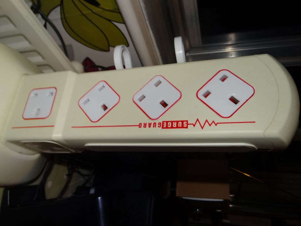

                      Well, the powers that be have decided the answer to that is no, you shouldn't. It's why new appliances come fitted with sealed 13A plugs. Spoilsports!
                      This is a better design I feel – plugs can't be inserted upside down:

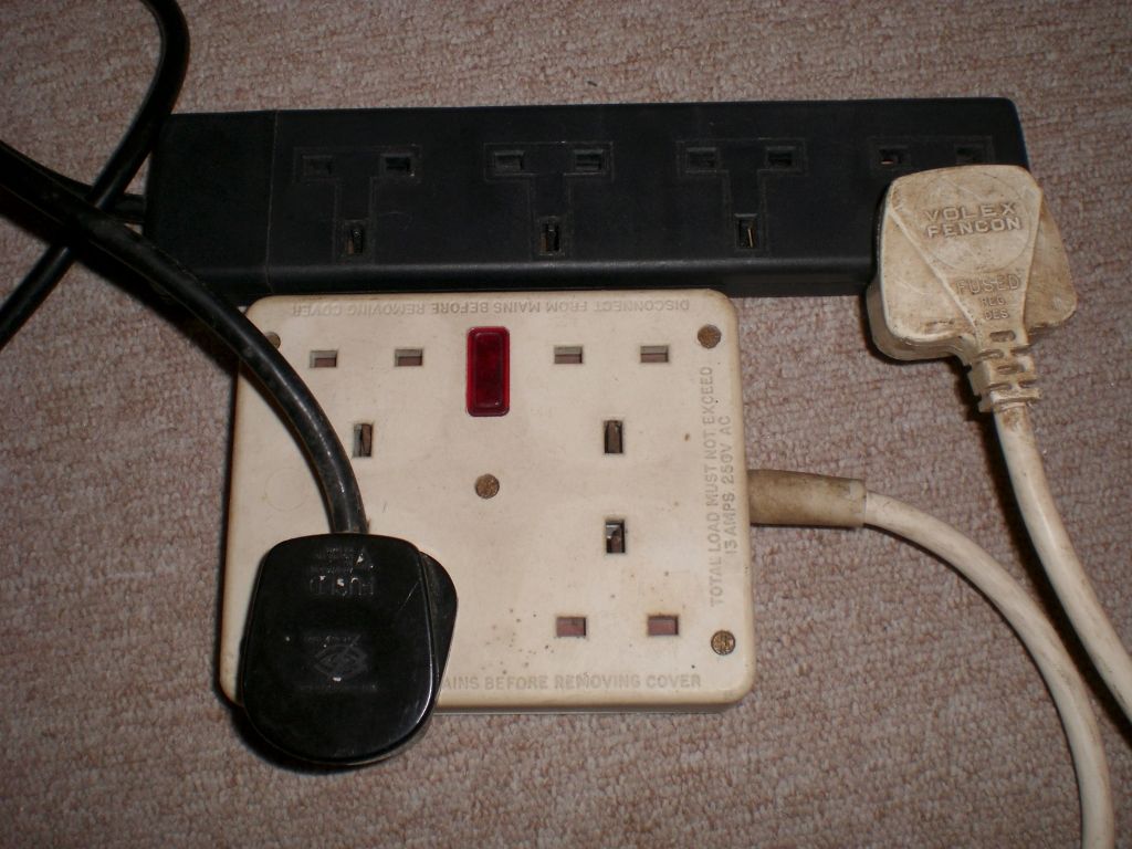

                                      I was able to put the black plug into the white multi-socket the wrong way round, by using a small screwdriver in the earth hole to open the shutters. OK, it can't be done accidently, but the design isn't a good one, however it is a fairly old one. As you can see, the black multi-socket allows the earth pin to be plugged in, same as SillyOldDuffer's one.
                                      Regards Nick.
                                      P.S. The white one has BS1363A on the moulded plug, which I assume covers the whole unit and was made in England. The black one has a replaceable plug and has BS1363/A on the multi socket itself, along with the kite mark and is badged as JoJo (UK) England.
