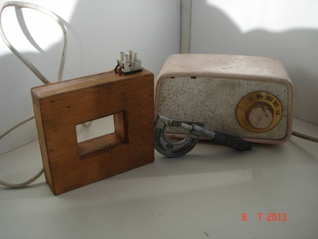

                      #168392
                      Ian S C
                        @iansc
                        #168394
                        Oompa Lumpa
                          @oompalumpa34302
                          How many channels does that radio get Ian?

                              Not as cheap as Len P's but at 4.37 ex Toolstation the Wera magnetiser/demagnetiser does the job for me on screwdrivers etc
                              I have an old transformer that I modified some years ago that demags bigger stuff Needless to say I can't find the detail of the mod but feel it must have been in an old ME. I remember cutting a slot through some or all of the laminations and then back filled with araldite. Ring any bells with any one? (Preferably not alarm bells since its lasted for at least 20 years)
