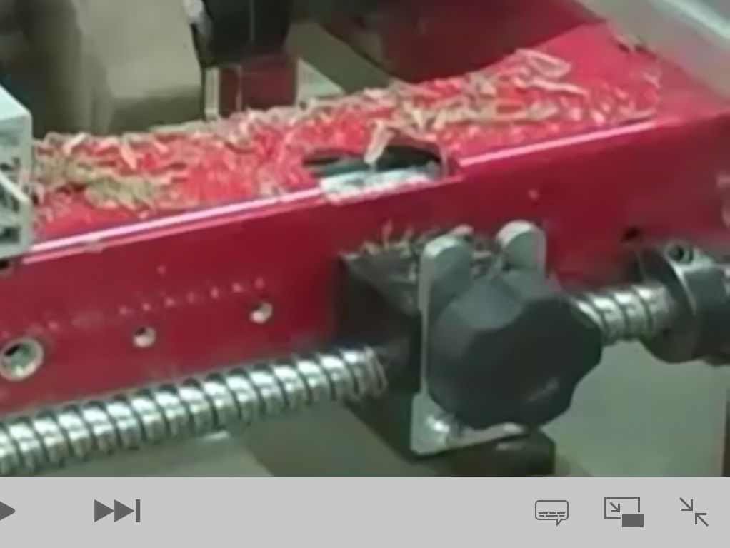

                                Robin,
                                I grabbed an image from the video [at 5min 21sec] **LINK**
                                http://legacywoodworking.com/demoVideo.cfm
                                Assuming this is the right machine … it looks like the thread is a special.
                                Edited By Michael Gilligan on 17/10/2016 14:54:49

                                  That's it. Like I said earlier (fourth reply), easy enough to make one by 'squeeze and heat', then machine to size afterwards.

                                    Posted by not done it yet on 17/10/2016 15:43:15:
                                    Curiously:
                                    (a) no-one else but you seems to have noticed Richard's original query
                                    http://www.model-engineer.co.uk/forums/postings.asp?th=121161
                                    (b) from what I can see on the video, that could not strictly be called an Acme thread.
                                    Given what it looks like … I agree that heated and squeezed Delrin is the obvious answer yes
