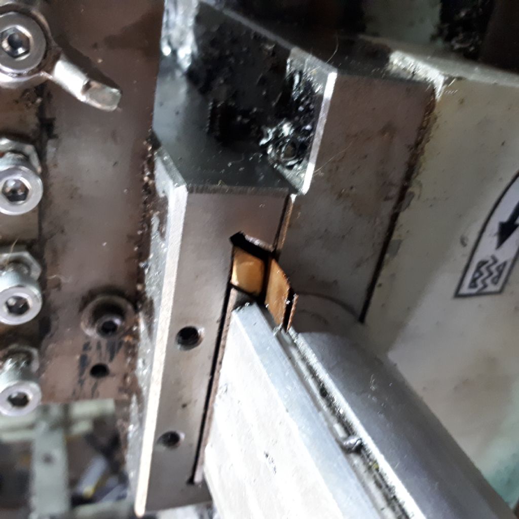

      I recently purchased an SC3 from Arc which I've had a few problems with. To be wholly fair to Arc they have been most helpful and accommodating in overcoming the issues and I have absolutely no complaint about them. Despite following their recent advice I'm still having difficulty with the cross slide gib strip, and I'm lost as to where I go now.
      If the cross slide is sitting with it's left hand dovetail hard against the saddle dovetail, and the brass gib strip is also hard against the saddle gib strip, how much clearance would you expect between the gib strip and the cross slide dovetail? On mine it's about 1.0mm, maybe a tad more, this maybe right but I'm struggling to get the whole assembly tight enough to make the tool rigid whilst retaining sensible movement of the cross slide fed screw. Any thoughts?
      Regards

          Hi Martin,
          Can you please take a photo and post it of the area that has this 1mm ish gap.
          Nick

              Here we go
              #309394
              Lathejack
                @lathejack
                The gap down the side of the gib strip bearing against the gib adjusting screws shouldn't cause any problems, as long as the bearing surface of the gib strip fits snuggly against the cross slide dovetail.
                But on your first photo, gib bottom left hand corner, the bottom edge of the gib strip appears to be fouling the root of the crosslide dovetail. The relief groove in the bottom of your crosslide dovetail seems a bit shallow, this together with the sharp bottom edge of the gib strip maybe preventing the gib from seating correctly on the bearing surface of the dovetail.
                If you remove the sharp edge from along the gib and leave a slight flat there to give some clearence between it and the root of the dovetail it might improve things.
                Edited By Lathejack on 29/07/2017 23:36:05
                Edited By Lathejack on 29/07/2017 23:38:48
                #309411
                  In short, the size of the gap doesn't matter within reason, but about 1mm (or a bit more) would be normal on any lathe. It's how well you adjust the gibs that matters. I find doing up each screw until the slide virtually locks, then backing off a little works for me, but it is matter of developing a 'feel' for what is right. Don't forget to lubricate the slide, if you haven't, loosen it, wind it right out to one end and then the other. Get plenty of machine oil of the moving surfaces (confession I use my neat cutting oil to lube the slides and in 18 years I haven't had significant wear).
                  <edit> difficulty in adjusting often means that ONE of the screws is too tight, not enough to lock the slide when the others are loose, but too much when the others are nipped up. Also, use an allen key to stop the screws rotating when you tighten the lock nuts. Always tighten the lock nuts before deciding whether a screw is properly adjusted. Take time and all will be OK.
                  Edited By Neil Wyatt on 30/07/2017 08:14:55

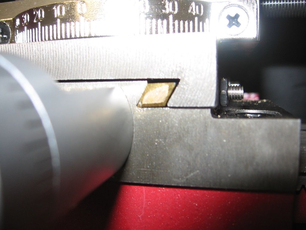

                              When I made my own brass gib for a t-slotted cross slide, I had rotation problems, until I made the locating 'holes/dimples' deeper (I actually machined out u-shaped recesses). This totally solved my problem. I can say I haven't had this issue with the original fit steel gib on the supplied cross slide.
                              Your lathe has the brass gibs fitted and should be smooth as the Cowells – at least pretty much so.
                              Looking closely at your picture, the gib may be rotating, perhaps you need to deepen your dimples as well?

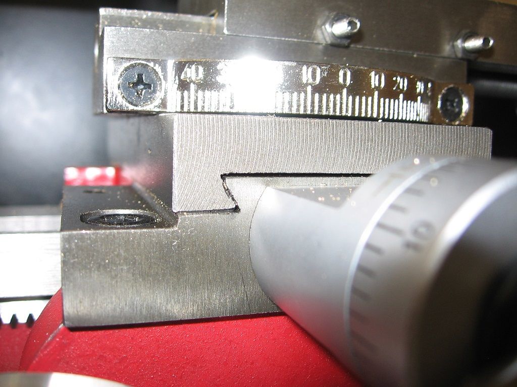

                                  It sounds like you have swapped out the original gibs for the brass ones which come with cone point screws? If so, compare the new and old gibs.
                                  If you think about it, once the screws are pressing on the gib, the outside of the gib won't be touching the metal of the slide, so the size of the gap is effectively immaterial, as even a tiny amount of rotation is enough to upset adjustment.
                                  The gap on my original cross slide is about 1mm, but the TOP of the gib contacts the underside of the slide, which stops it rotating.
                                  The gap on my home made slide with a brass gib is about 1.5mm. The gib does not touch the underside of the slide, and this may be why I had to deepen the pockets so they go past half the depth of the gib. I have a theory about ideal depth, but the key point was that once I went past a certain point the gib worked 100%.
                                  If you don't want to drill the dimples any deeper, you could try fitting a shim along the top of the gib.

                                          The screws should hold the gib strip in its vertical position, it doesn't need to be right into the corner, although that shouldn't do any harm if the corner of the strip is rounded/bevelled off so it doesn't bind.
                                          Not many images of real end-on gib strips on the web! Those I found seem to be held by their screws and not forced into the corner.
                                          This example (on an Emco by the look of it), doesn't touch at top or bottom.
                                          Looks like this one has had turcite strips fitted, but the gib (which might be a taper type) doesn't contact them.
                                          But this one does!

                                            If you look at Martins original pictures, the gibb has definitely got an angular gap between itself and the dovetail, so I think Lathejacks suggestion is right, the tip is fouling in the corner.
                                            Reading some of the rest of the posts, it is not desirable for the gibb strip to bear against the surface below. The downwards pressure from the contact between the dovetail and the gibb should be transferred out to the actual slide through the screws. If the gibb is bearing against the surface below, then the slide may not be. The George Thomas modification was intended to prevent this happening.
                                            I think that gibb strip would work better if it was thinner, which could be effected by deepening the dimples that the points of the screws work in so that their action is much closer to the other side of the gibb. But the first thing to do is to make sure the point on the left side is not fouling.

                                              Posted by Martin Shaw 1 on 29/07/2017 22:48:25:
                                              Here we go
                                              That's the thickest gib strip I have ever seen. It appears to be wider than it is tall. No wonder some users referred to above have found the strips tend to rotate. Really bad geometry there. I think Neil's suggestion above about drilling the holes for the screws in the gib strip deeper might be the answer. I would drill them through to within about 3mm of breaking out the other side. It looks like the gib screws are long enough to accommodate this.
                                              This would put the pressure point in close to the bearing surface and cut the tendency to rotate. If you look at most lathes of reasonable to good quality, (eg Myford, Drummond, South Bend, Boxford etc etc etc) the gib strips are a flat profile, say 3/16" thick by 1/2" wide and so forth. They don't have these kinds of problems so you might be well to copy them. If you Google gib strip images for the above lathes you will see what I mean.
                                              The below sketch from an old thread on similar matters shows the more usual proportions of a traditional gib strip and how to set it up.

                                                After all the useful posts I have been playing around. I managed to mill a fraction off the tip of the gib which made it fit snugly into the dovetail, but somewhat surprisingly if I reversed the gib it fitted perfectly which suggest it isn't a parallelogram in section. Either way nipping up the cone point screws did what was needed, the gib sat exactly where you would expect it to.
                                                However I still couldn't get a satisfactory compromise where rigidity was maintained but ease of operation enabled, so I tried deepening the points in the gib, bad mistake, now the adjustment tipped the gib out of alignment. I think that this a partly due to drilling into a surface at an angle and on reflection it is the pointed dimple surrounding the cone point that maintains the correct angle to the dovetail. The brass gib now had so many wrong holes in it that the scrap bin beckoned. I reverted to the original steel gib but the other way around. This worked as described above so I thought maybe a centre punch would be adequate to maintain alignment of the gib, it does but by no means ideally and I have come to the conclusion that you should do no more than screw the adjusters tight to form a dimple and then adjust for operation.
                                                The net outcome of this is that I will obtain a replacement brass gib from Arc, BTW you do have to polish out the machining marks to have a chance, mean while the steel one will do, but the optimum is not really satisfactory, rigidity is compromised by operability. I think the truth of the matter is that the manufacturing tolerances are sufficiently lax for the odd rogue to slip through, maybe I really am expecting too much. Thanks though for all the help.
